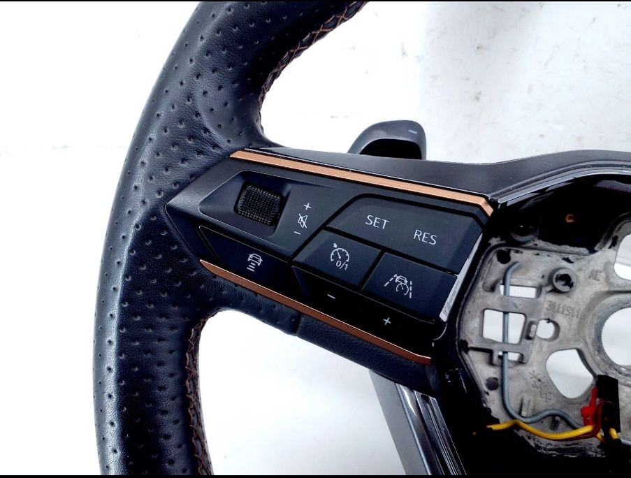

On a side note my car has ACC and lane assist, looked at retrofitting travel assist is it a case of capacitor steering wheel + coding or is there mode modules or components required?
tommyfulf
Mar 5, 2025
55
No, Capacitor wheel and Coding
Nice one thanks ?? I'm guessing capacitor wheels are the ones with the travel assist button

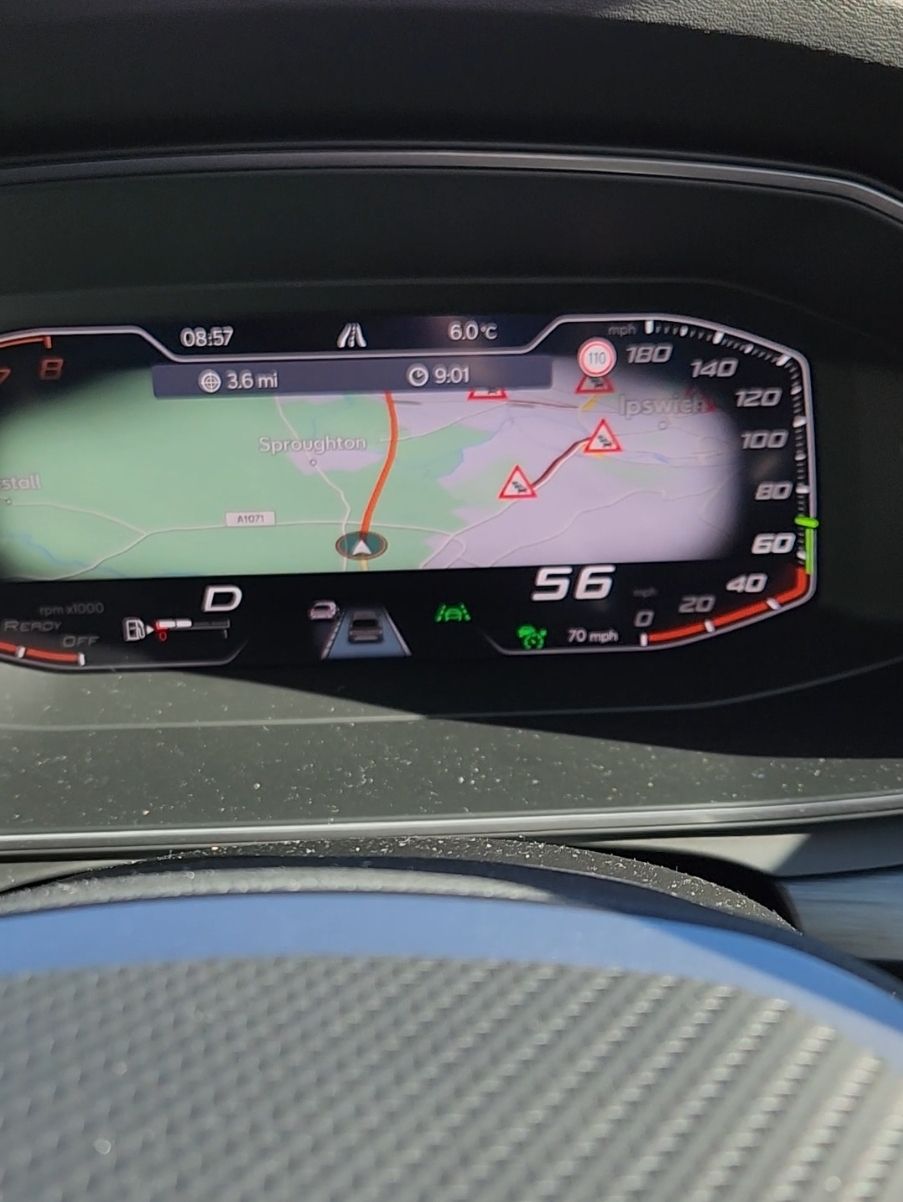

I found an interesting thing that I think links my theory the car thinks it's in Spain during this issue on my drive to the dealer today.
ACC on and worked fine no over take right prevention then it randomly did it and i noticed the speed recognition change from 70 to 110 and the. The issue ove overtake right prevention occurs.
Be interested to see later if it still skips back to KPH and therefore issue occurs again

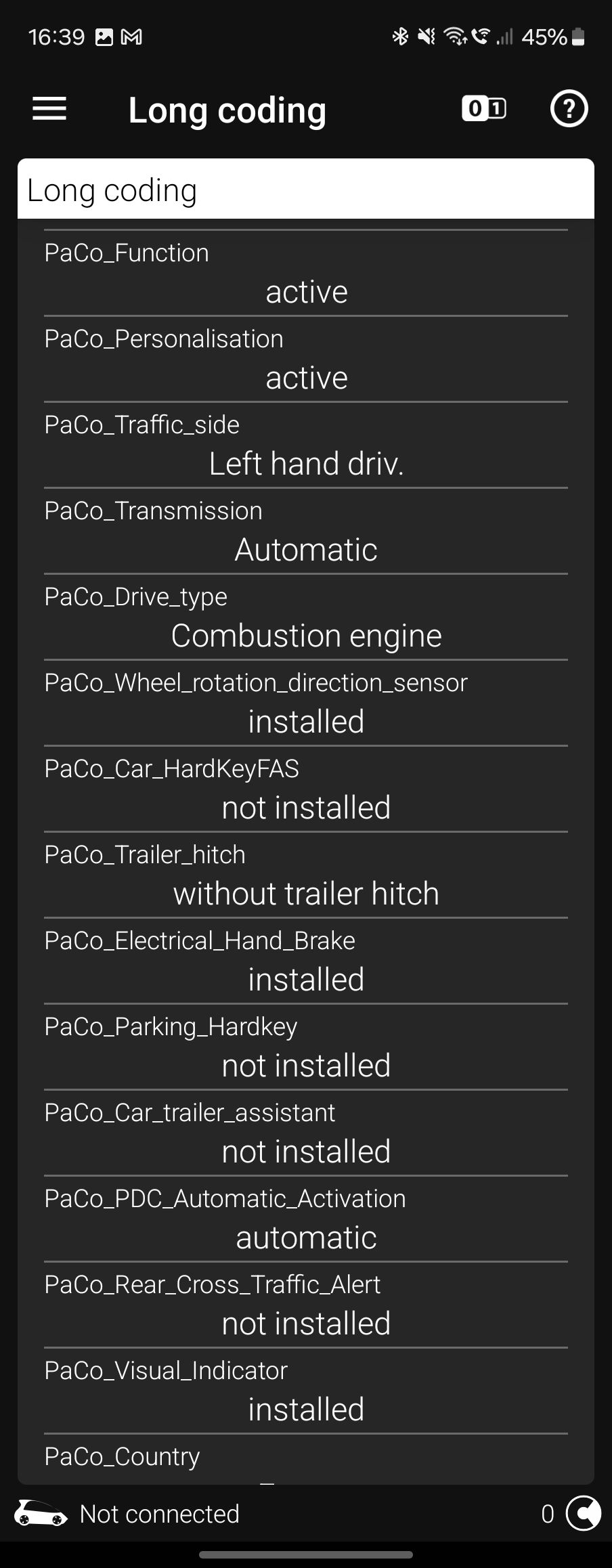

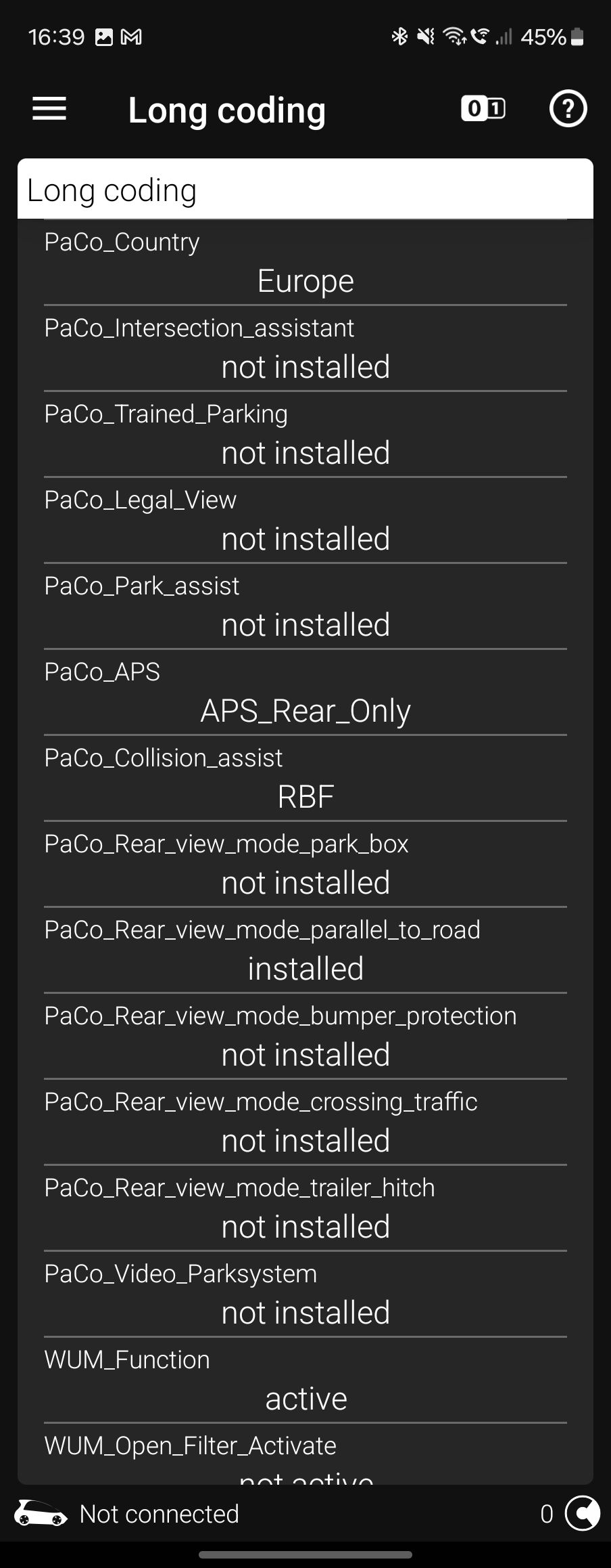

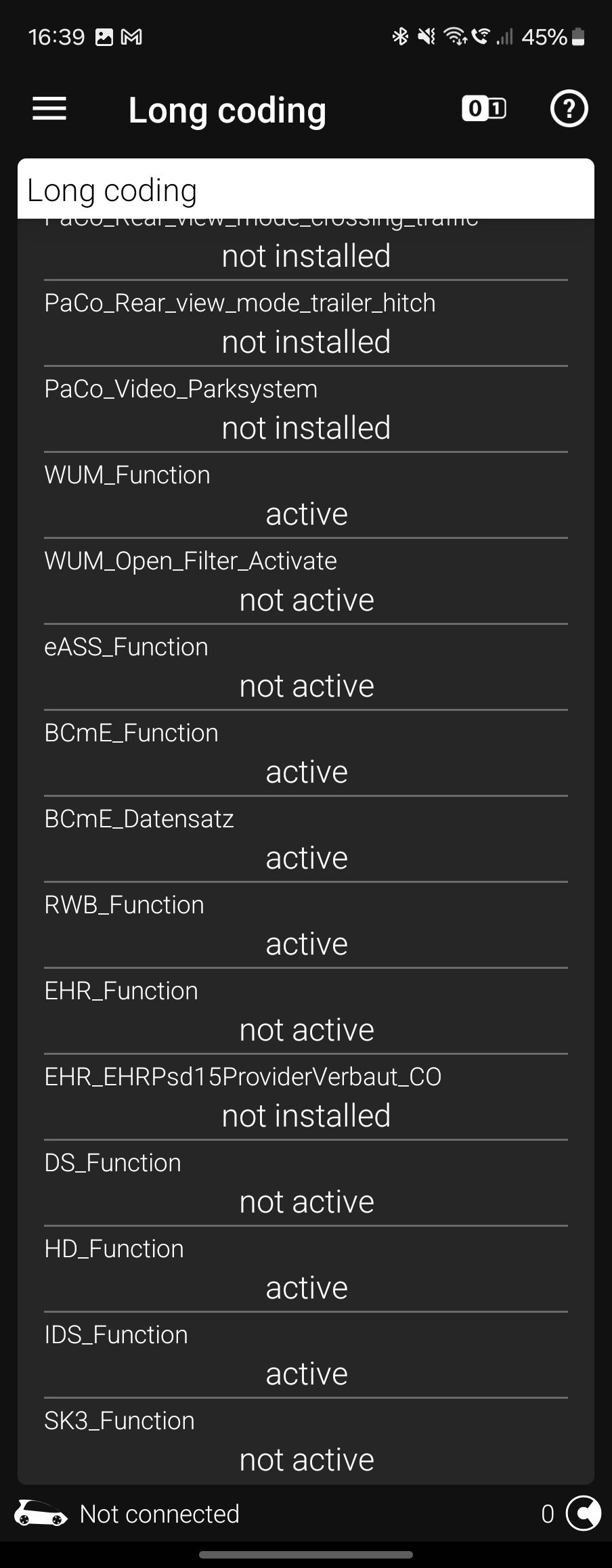

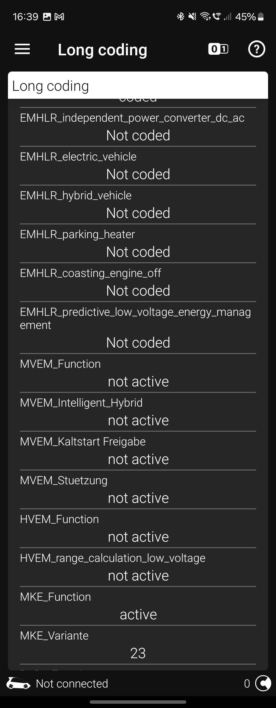

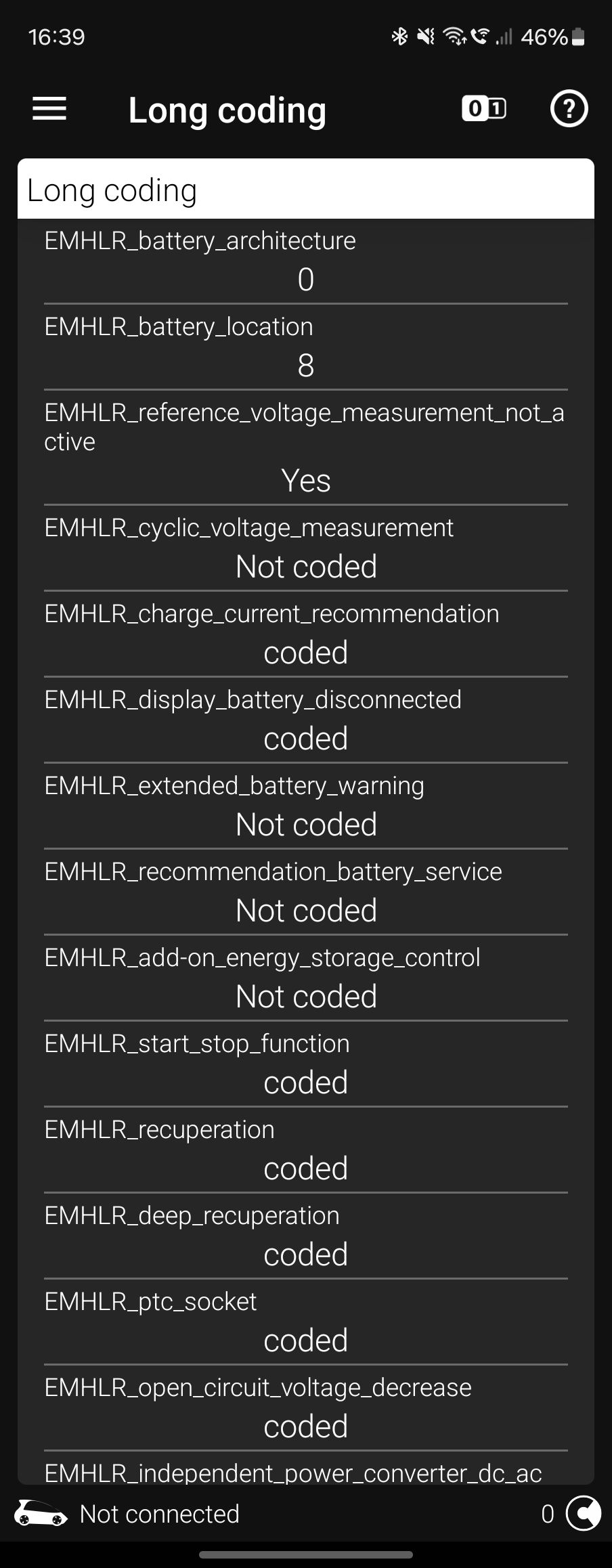

There is no KLR option in gateway (I've screen spotted all options) is it hidden in one of these.
KLR is set to coded in A5
Activate the KLR in the Gateway

tommyfulf
Mar 5, 2025
55
Ahh I will connect back to the car and try.
You may well have saved the day Cairus my friend.
do you have any idea why Module 13 won't let me make any adjustments? I reached out to OBD directly and on their forum but no replies or help which is really disappointing ?
it is not coding but adaptation
