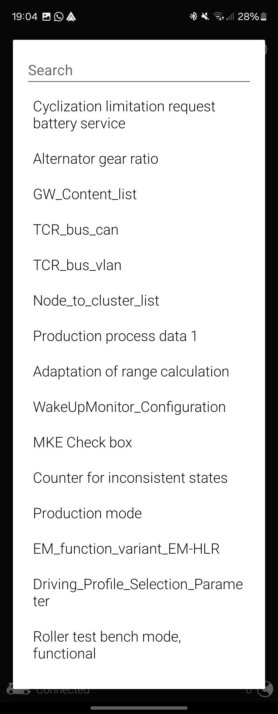

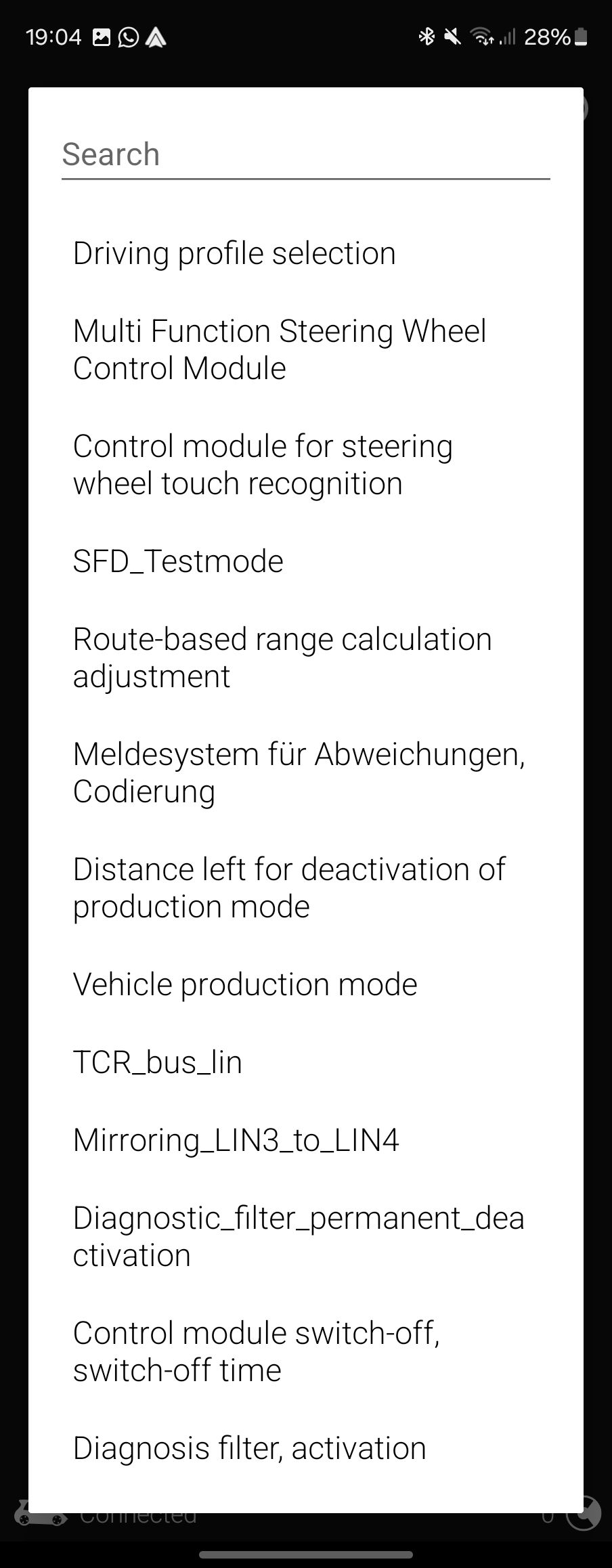

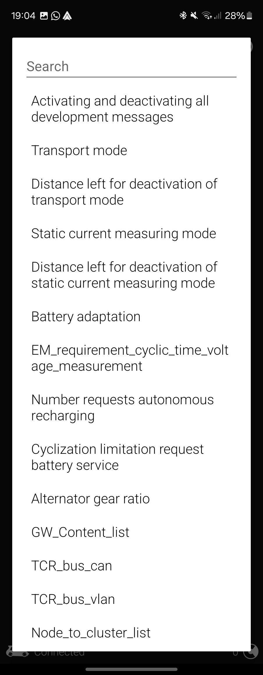

In gateway module under adaptation I cannot find anything stating KLR
Is it under a different name?

Again apologies but under
Gateway>adaptations>
there is no target installation of sub participants ??‍♂️
I also can't see a KLR option within any of those categories either
This is the closest to what you have said but still no KLR option in there

You need a Firmware Update and Dataset i think, i will check something
Isn't KLR this one under that section? --> "Control module for steering wheel touch recognition"

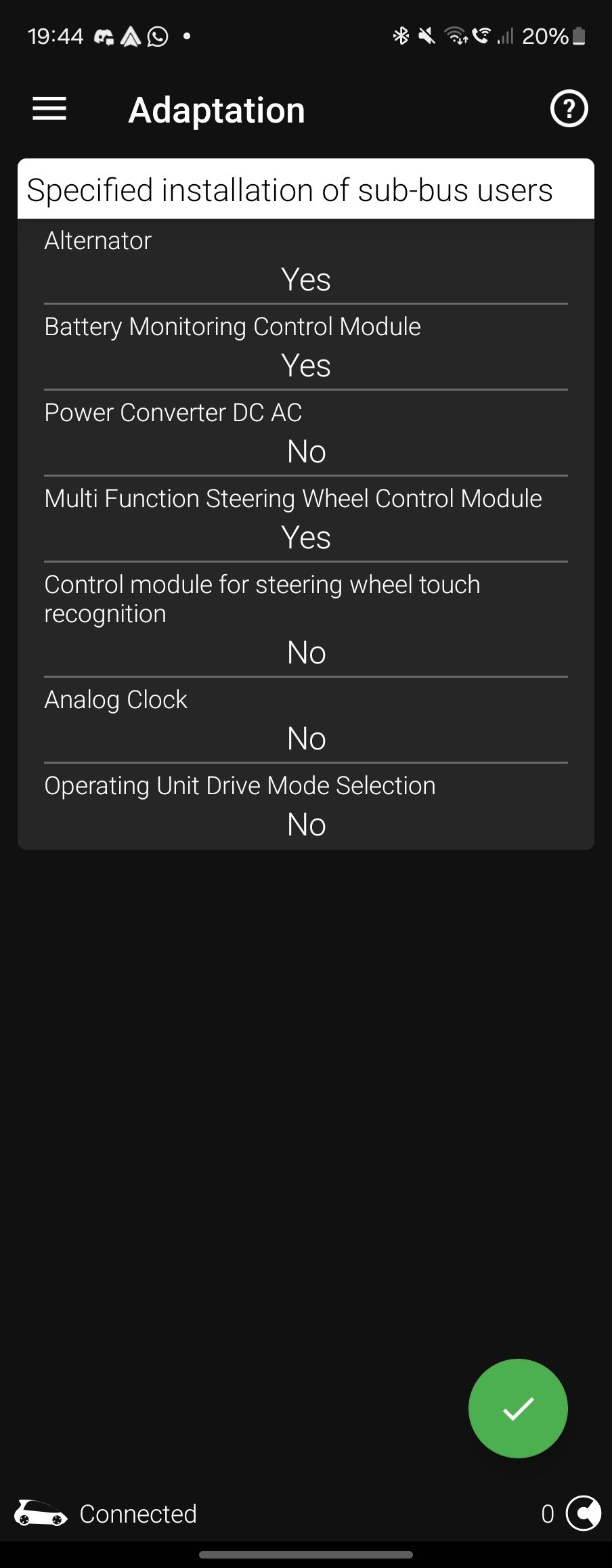

I have coded every TA retrofit under gateway adaptation, sub subscriber the klr
Yes of course, I meant the item under the section you were already talking about: "Specified installation of sub-bus users"
Sent from my 24122RKC7G using Tapatalk
@tommyfulf said he could not see a KLR option and I'm saying "Control module for steering wheel touch recognition" under "Specified installation of sub-bus users" *is* the KLR option.
