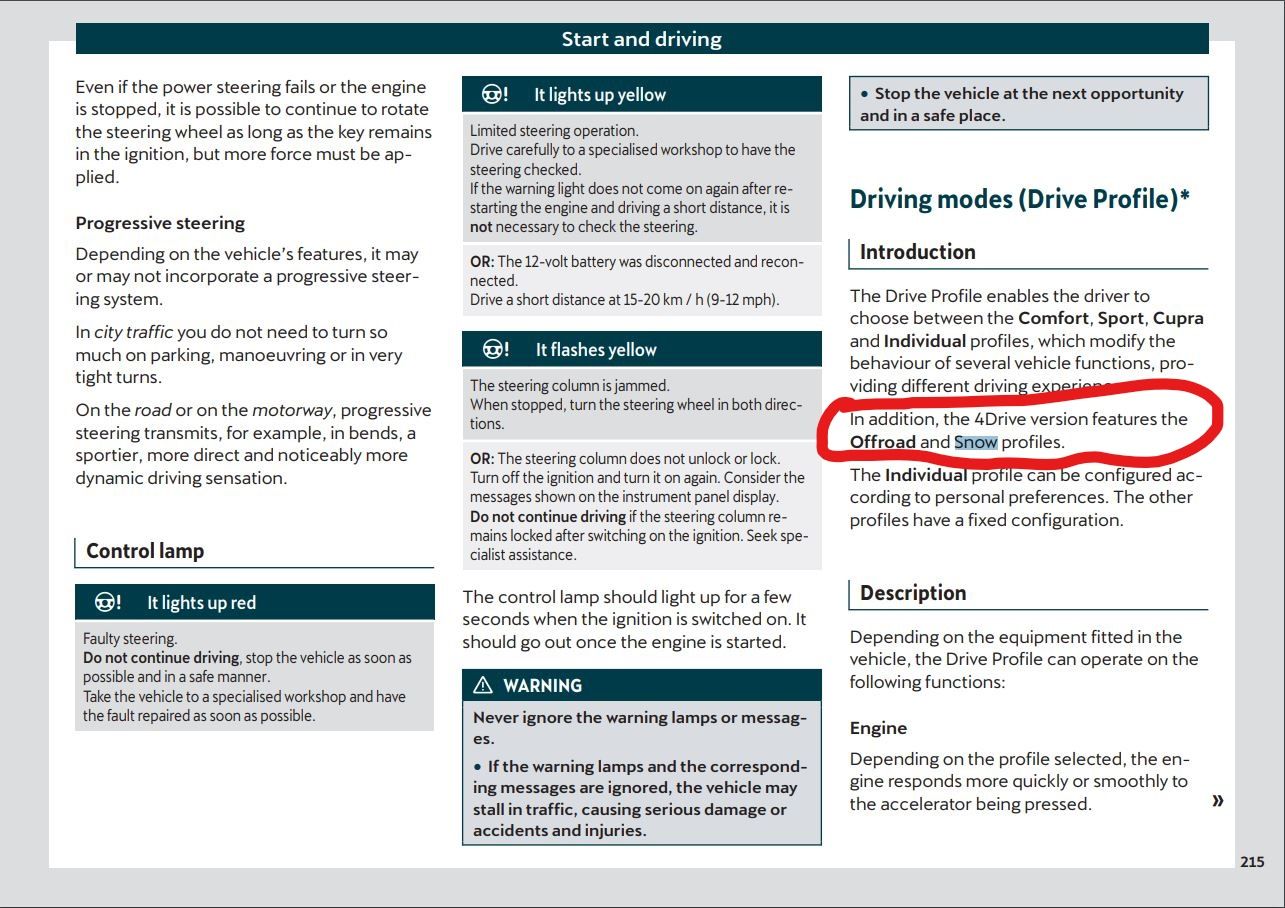

Hi guys,
I'm in Sweden right now and there is alot of snow. I've read the manual and it says the following;
Does anybody see Snow profiles next to the Offroad profile? Because I don't. Thanks in advance.

Thinking about snow I did check what icon my twiddly knob has on my 4drive Ateca, snow asterisk. I see in your manual they don't put snow in bold whilst the others are. I'm wondering whether it's a sub option of off road ?. Don't have the car myself.
Assuming you don't find it in the manual or screens it might be a case for setting the individual mode. The snow setting is suppose to play with traction control so you get wheel spin to get a grip. So on individual you would scale that if possible if you can't find the snow setting.

I never saw Snow as a mode option. I would have assumed that Offroad contains "snow", like "Offroad and snow" is a full name meaning it allows some tyre slip and uses engine braking.

May be it's suppose to be read as off road and snow as one setting as you say although off road is put in bold so the other appears as an option. Does anybody want me to determine the Ateca settings for Off road v Snow setting. I recall it's shows them as a recipe between settings which you can replicate as individual. A bit academic since the Formentor is a different car. In crude terms as I recall it reduces traction control if not turning off completely. The old 2wd trick you did in snow reversing out of a snowed up drive.
Yes this might be it. But the manual says Offroad and snow options which made me think there was also a snow option for the Formentor.

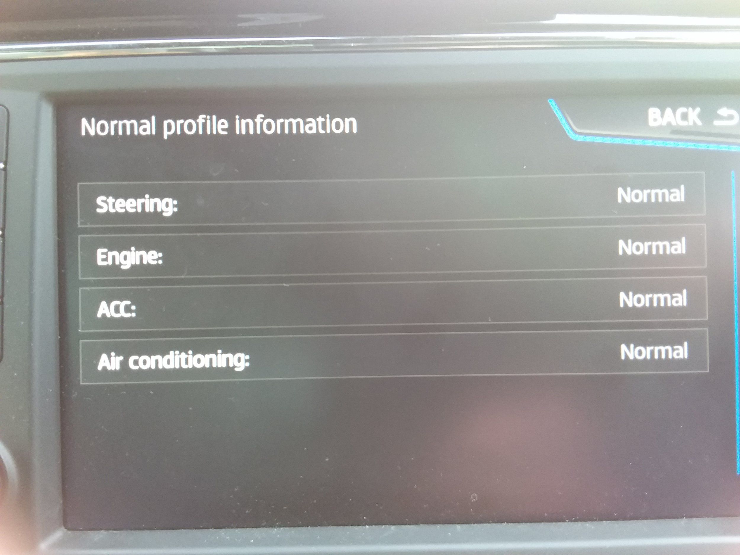

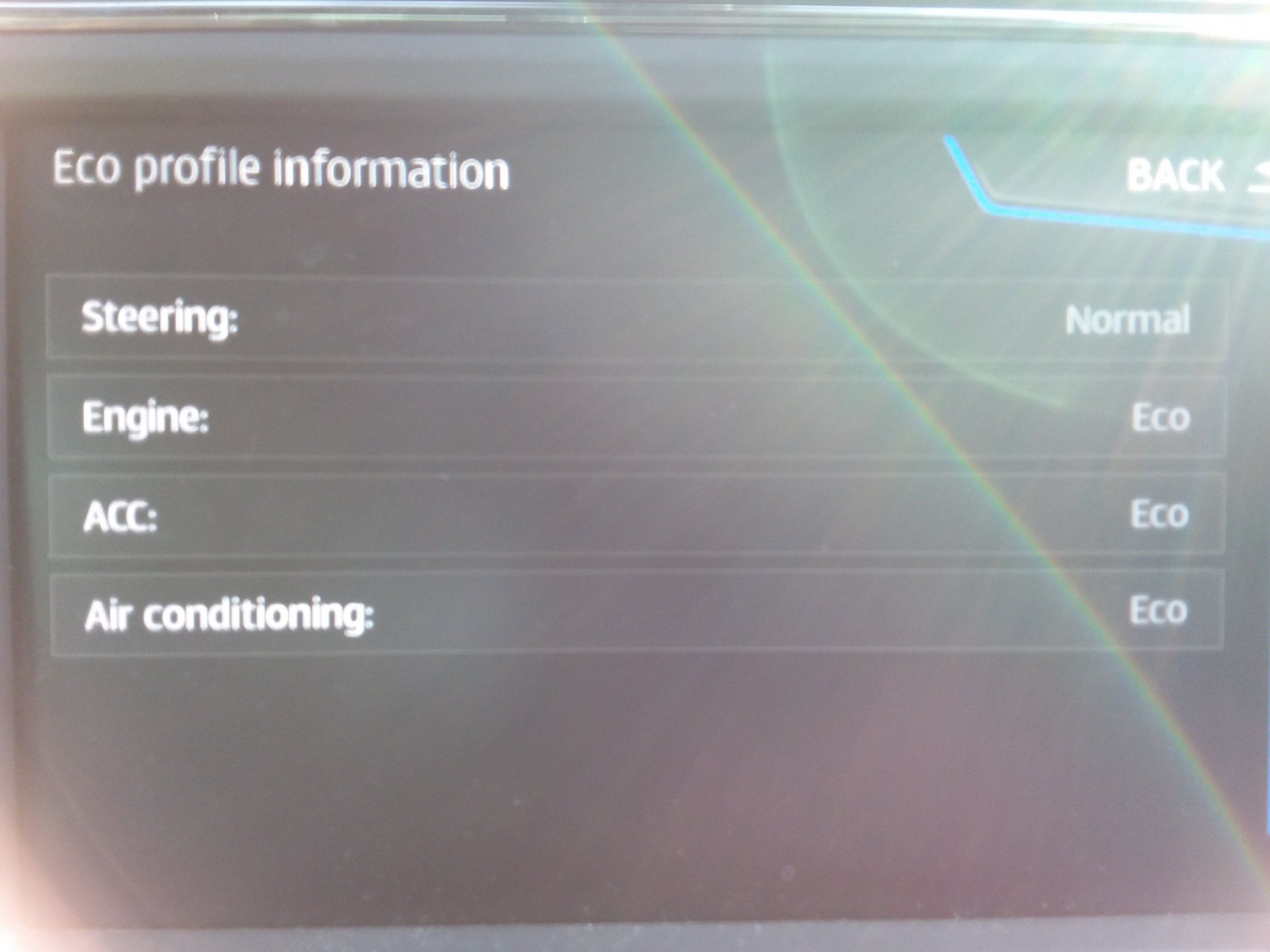

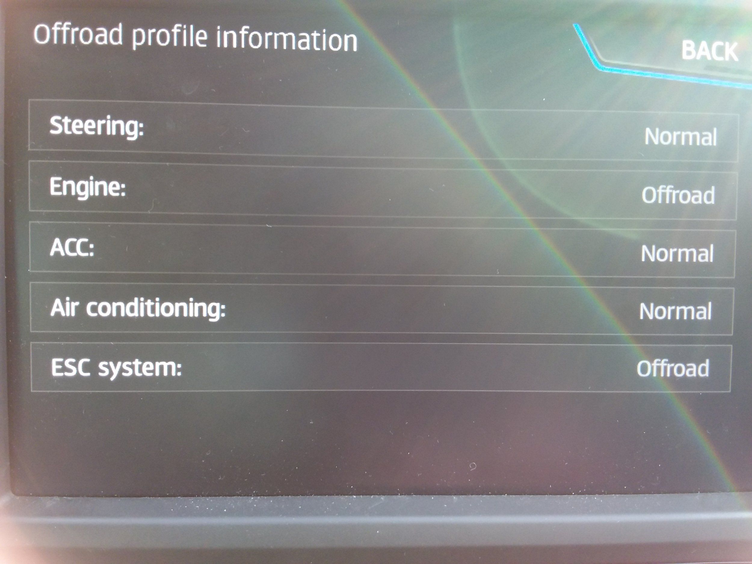

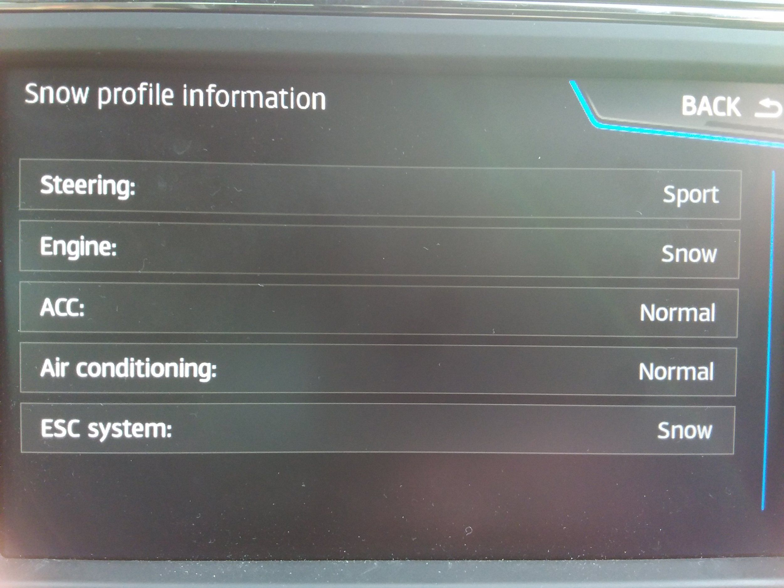

I've tabled the Ateca DSG 4WD 190TDI ones where snow was an option.
In the Formentor they treat off-road as snow so the setting is interchangeable... so it appears. For the Ateca the differences are that for snow driving steering is set to sport. The "engine" has two settings over and above normal, sport and eco, namely Off road and Snow. This will be gearing. Esc have their own settings Offroad and Snow.
NormalSportEcoOffroadSnowIndividual
SteeringNormalSportNormalNormalSport1-3
EngineNormalSportEcoOffroadSnow1-3
ACCNormalSportEcoNormalNormal1-3
Air conditioningNormalNormalEcoNormalNormal1-3
Esc systemxxxxxxxxxOffroadSnowxxx
Note
xxxnot available - assume standard Esc on
1-3as per options columns 1-3
The individual mode options just blend normal, sport and eco. Esc isn't available to adjust other than standard. e.g.. can't blend Off road or Snow settings in.
I see Formentor boards don't talk too much about snow. Traction control, gearing and lightness of the steering is the one the Ateca affects. Not sure how you see your Off road settings against the others in the Formentor. Obviously, 4Drive is triggered a bit more on the Off road / Snow.

Attach photos... for reference
View attachment 29040 View attachment 29041 View attachment 29042 View attachment 29043 View attachment 29044 View attachment 29045
Thanks for your effort! Will send a pic of the offroad settings tomorrow. Will get back to you.
