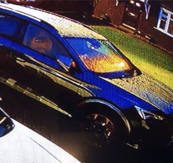

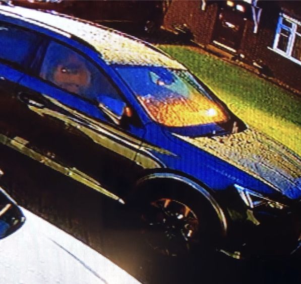

Mine has behaved (well almost) since I got it back. I have noticed on CCTV at night that it "flashes" internally when its locked and the keys are tucked up in their Faraday pouches, which give me anxiety. I sent the garage a video and they don't seem to have any idea why!

The keys for the Formentor are passive so when they are immobile do not emit any signals so in essence a faraday pouch isn’t really rewired (but good if you need the extra security).

Can you elaborate on the “flashes internally” statement above? I’m not sure what that means? Cheers??

Standard, I think most vw group cars have a small led that flashes to show alarmed 'armed'. My previous Golf R had the same as in the Formentor, nothing to worry about ?

It’s not the little alarm led light, its the whole internal dash light that randomly comes on then goes off!
