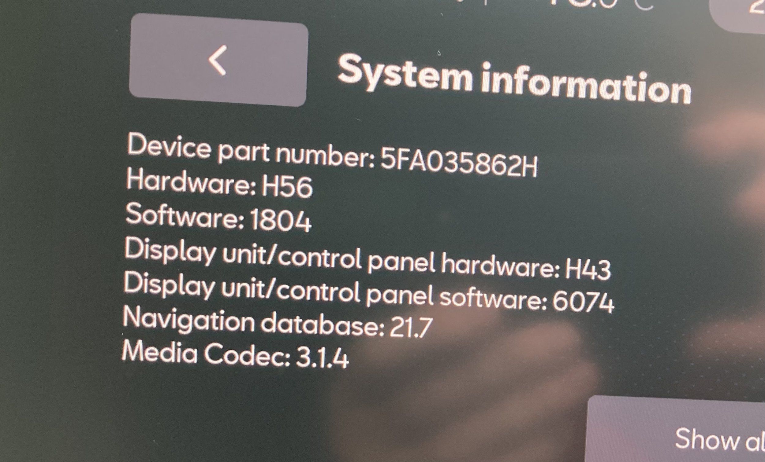

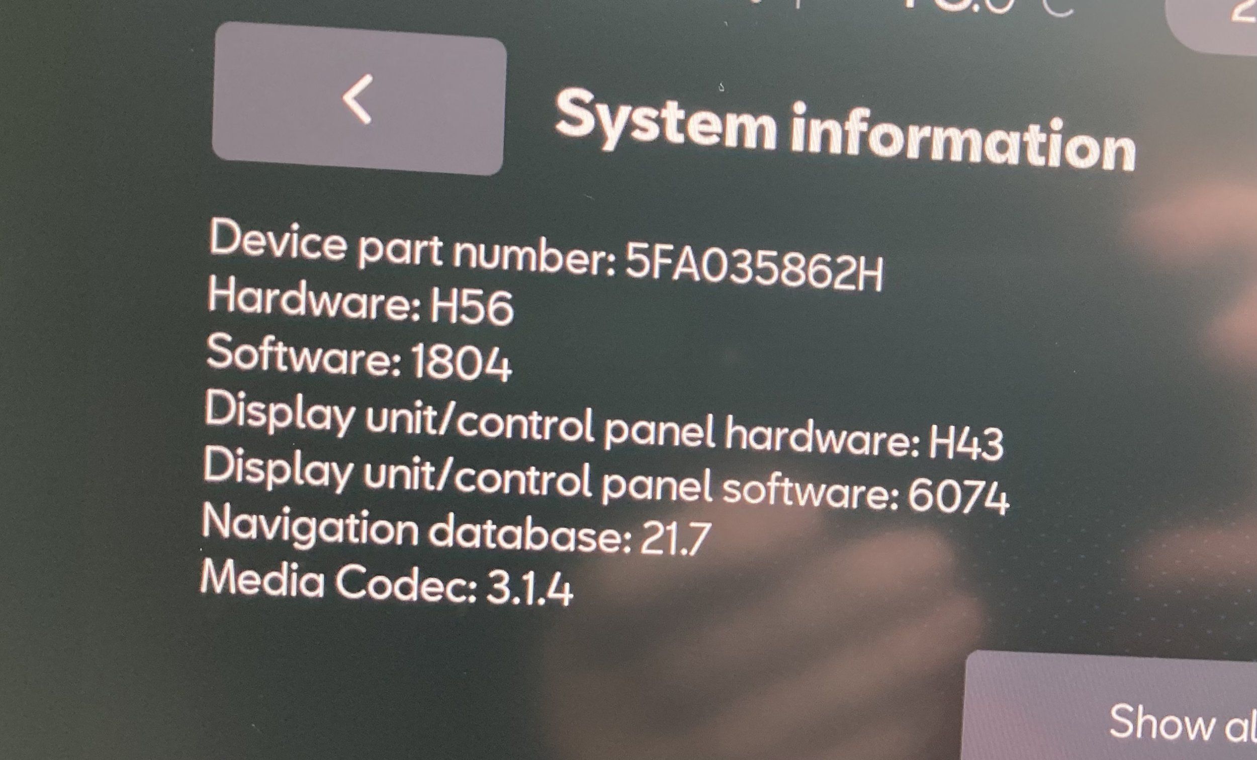

For comparison. Apart from the software version note device part number ends in H.
It's normal in mib2 that the apparent hardware part number increments with a software release. Truth is the device part number reflects the software and hardware. It's like the mib2 map releases its read from the software update and thrown up as a part number. So the tail end letter increments with the firmware code. I've had that as I increment thru the mib2 high firmware. 1804 in this case is the firmware also showing in the tail letter of the device part number.
