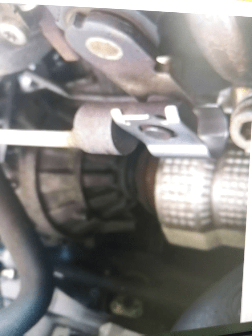

Get under the bonnet, (when its cooled down) and if you can rattle the wastegate actuator around at the back of the engine, its that.
You can buy an anti-rattle clip off eBay for a tenner, which MrPig here showed me on this forum, and I have a small spring from the rod to a clip nearby which takes the slack off the rod. Its like a different car and I can now drive around with the windows down without hearing the annoying rattle all the time.

I had a look at the wastegate actuator (I think...) and there is some movement. Here's a video of it - does it look like that sort of play in the mechanism would be making the noise?
Mr Pig - thanks for the link, I'm guessing the clip will work even though says for 2.0? Also the clip link doesn't seem to go anywhere.

Odd, works for me. Here is the description: golf passat cc Engine Turbo Clip Fastener VW 2.0T 06J 145 220 A
Yes, the clip is not designed for this exact application, it just happens to fit. It only fits on one end and one way round so you can't get it wrong.

As an update, I bought the clip and some high temp ep2 grease, but looking at how other people have fitted it, I couldn't work out how the clip went on. This is mine:
Which is very different to one I have seen on the forum with same clip:
Do I need a different clip, or is there a way to fit it?

ah okay, but your arm looks the same as mine, rather than the one with the clip on?
I don't know what you mean? My arm is identical to yours. I worked grease into the gaps and put the clip on in the same orientation as you have.
Sorry for the confusion!
The picture with the clip is a different car (one from the forum), and the first picture is my car without the clip fitted. The arm looks different between the two pictures, that's why I wanted to see if the clip was correct for my arm.
The clip was super stiff and didn't want to force it on too much, but if you are saying that your arm looks the same as the first picture (my car), I guess I need to force it on more.

Got you now. My clip was firm but it wasn't crazy hard to get it on. It's tight enough to stop the rattle but I could get it on with my fingers easily enough.
My clip looks exactly the same as the one in the picture and that's the way round it is fitted. With a good slabbering of grease! ;0)

Ah brilliant thanks! I shall try again, I'm a bit more comfortable giving it a go now that I know it's right clip for the arm.
