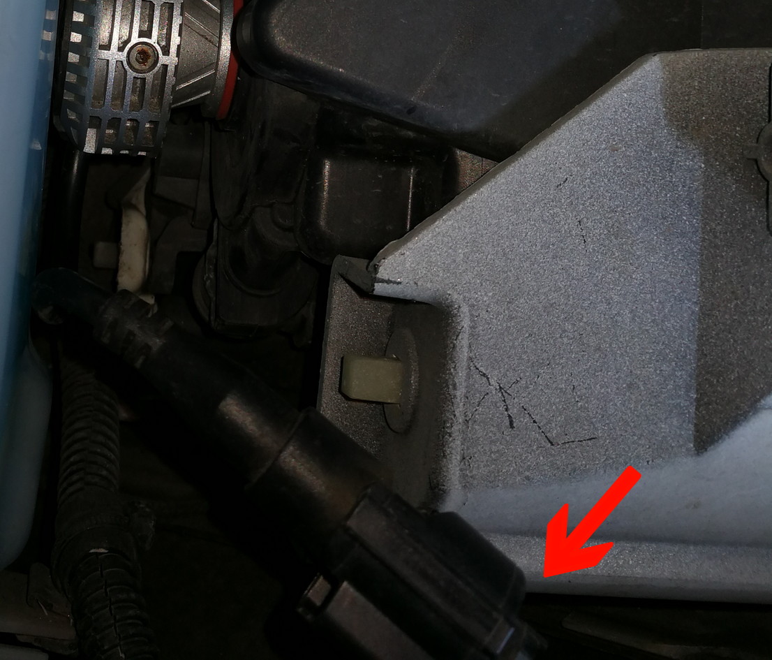

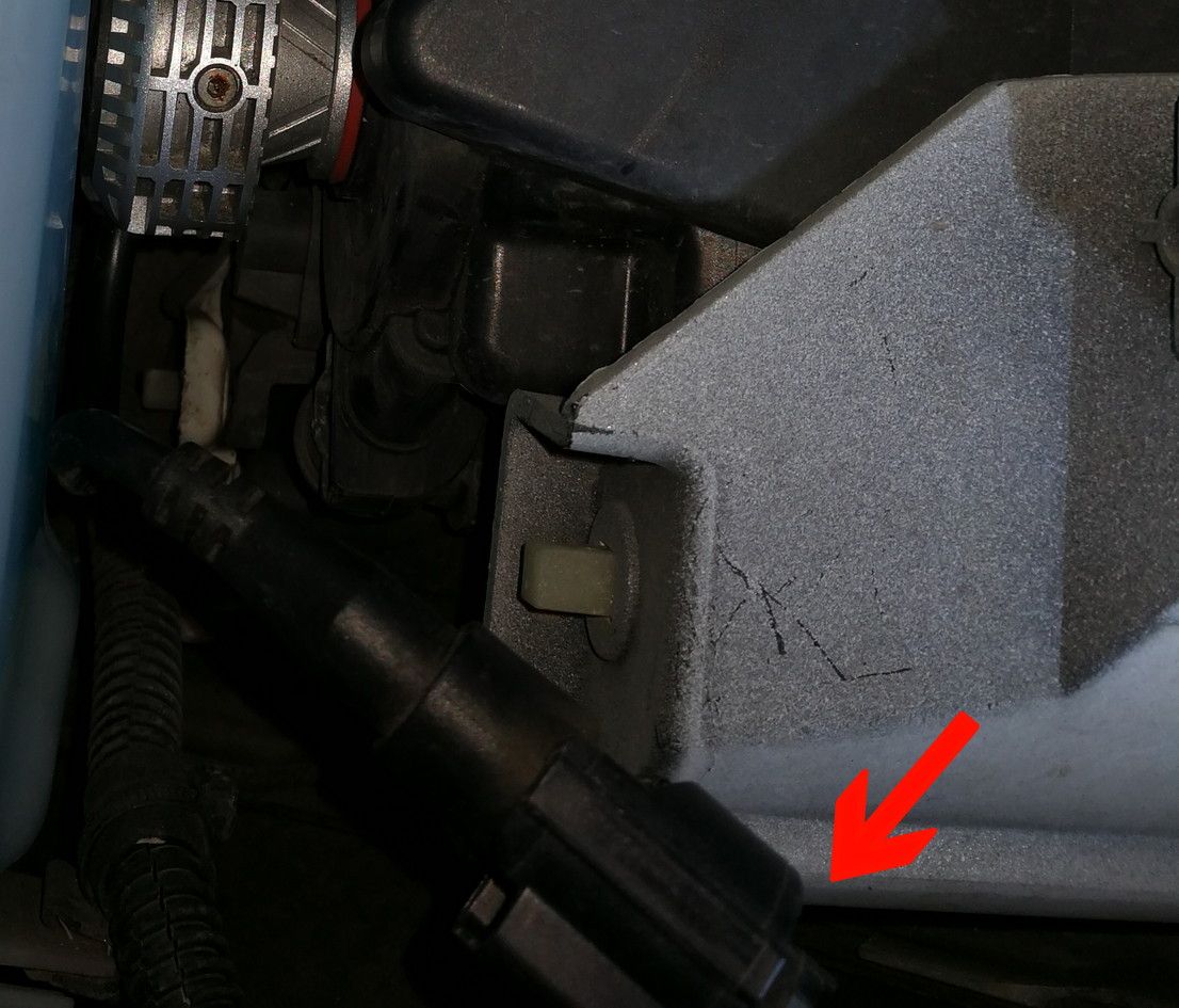

I cannot for the life of me get the power clip disconnected from the light. Any tips?
Is there clips in it I need to push in or pull out?
If I remember correctly, there is some kind of plastic tab you need to push down. View attachment 495 Approx in this area.
Yes I got it maybe 20 minutes after I posted....my God that was tough on the passenger side.

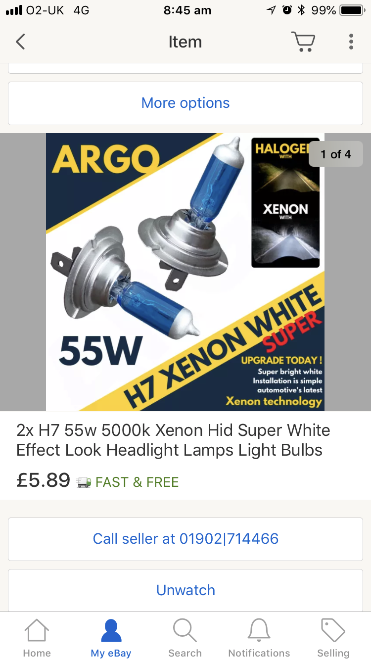

Looks great I need to get this sorted. These are the ones I bought .... thoughts anyone ??
I know H8 (OEM) and H11's are interchangeable. No modifying needed, but I'm not sure about h7's... Unless of course yours are indeed h7... Maybe someone who definitely knows can confirm.
I got these recommend off another fog light thread ? Now I’m unsure ??

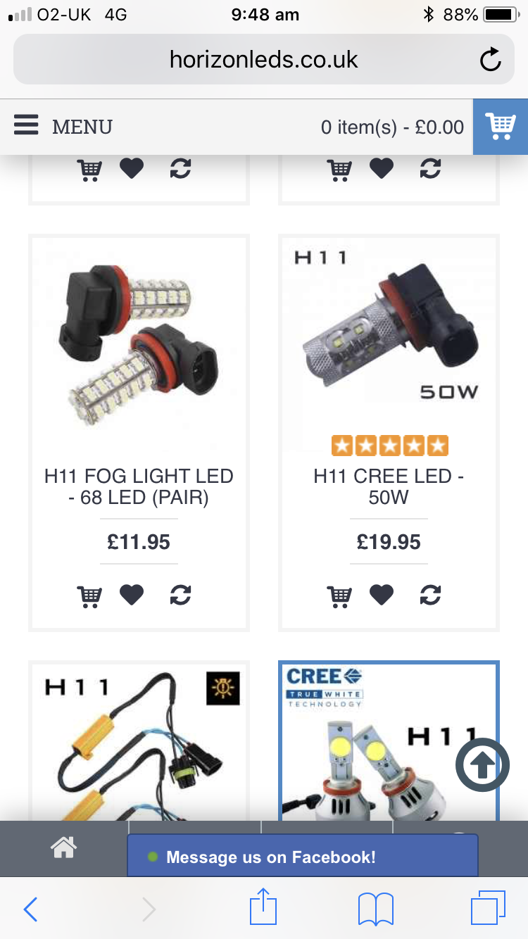

You got a link for these please wastedagen

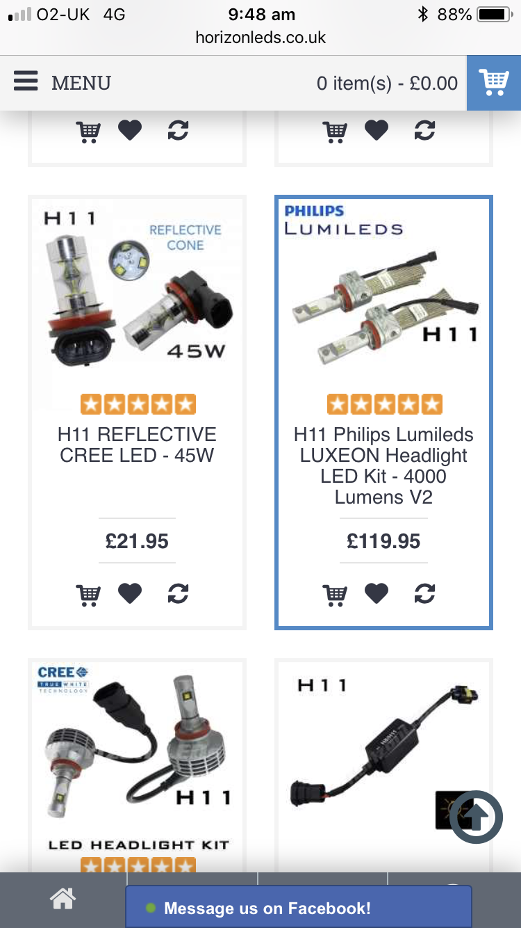

Hi wastedagen, I’ve just found these what you think would be the best ??
