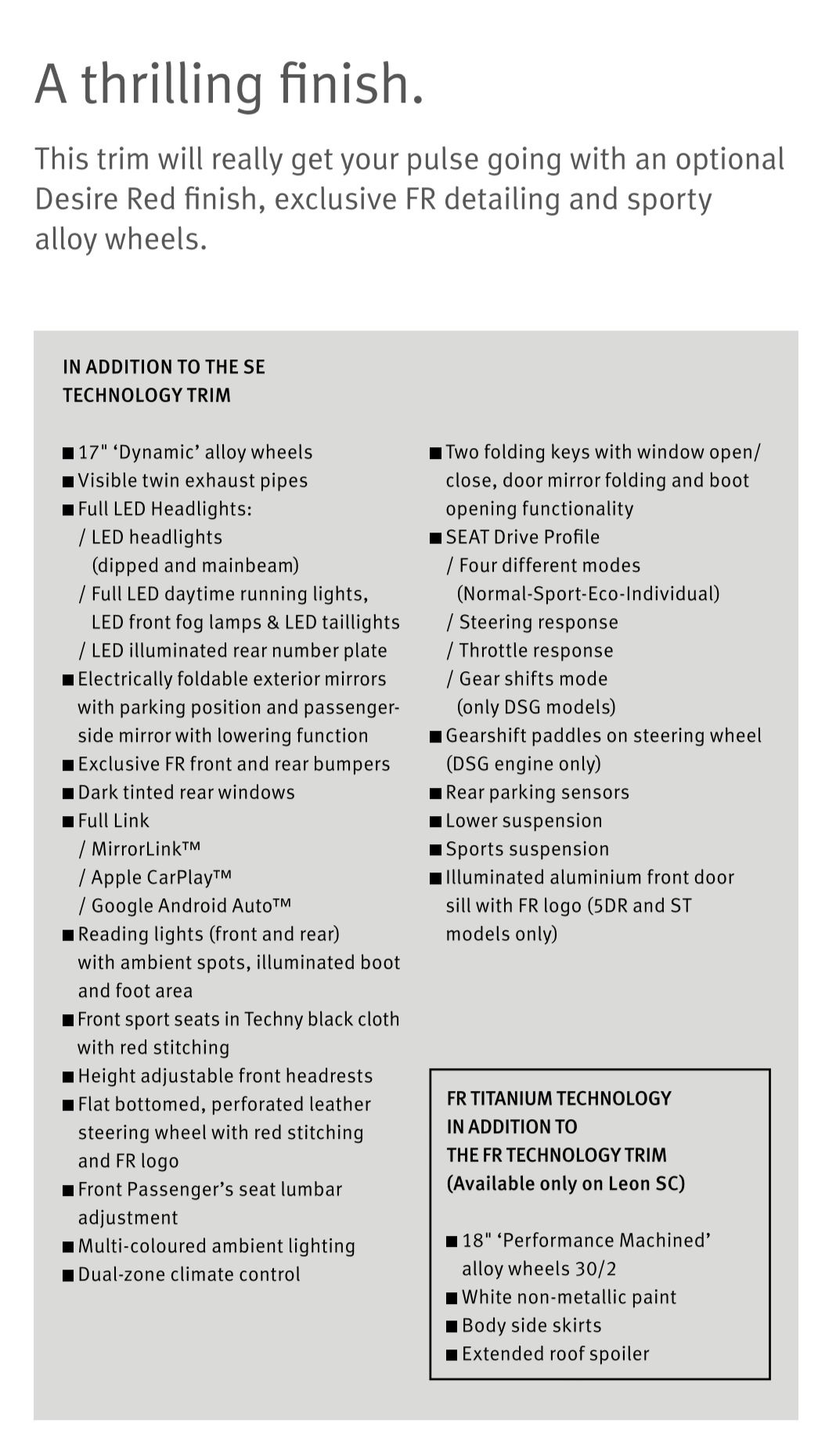

When I bought my 2018 the led headlights, tinted windows and full link were essential; the parking sensors and climate control have since proven themselves very useful. The FR was a bargain when new, compared to the SE for a lease - so it was a no brainer.
Mine stays in sport mode all the time, eco or normal makes the engine response really slow. The half 'leather' seats aren't the bits you sit on, just the sides, so no real point to them.
Given you mention 2018, this spec sheet would be for post-facelift I guess (although presumably close to the spec difference for pre-facelift)

In pre facelift full link needs activating and you get red and white led colour option inside instead of multi colour. Pretty much only difference

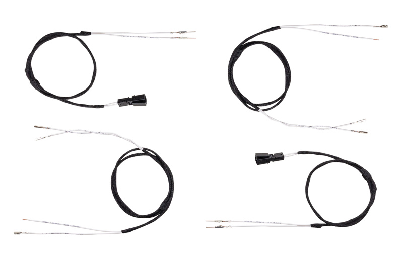

The sill trim is plugged into the wiring loom under the carpet via a ribbon/plug that exit the sill at the mid-point. Might be worth having a look under the carpet to see if the loom plug is there? If so plug and play, or plug in and some coding.
I think that the illuminated trims were added on a model year change, MY18(?) so plugs might not be there.
From memory illuminated door sills were approx £50-60 each. In my opinion I would avoid 2nd hand as the aluminium is easily dented during removal.
There are also companies where you can buy the pre-fabricated looms:

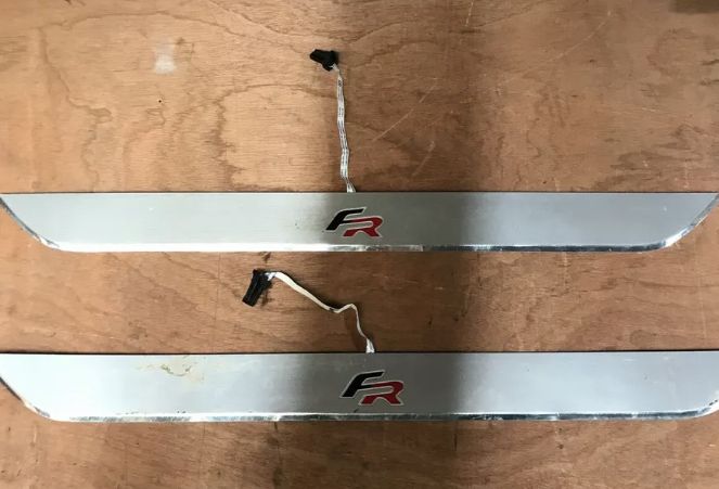

Brilliant, thank you. I’ll have a dig about for the connectors and report back. Do the aluminium pieces just pull off?

They are held on with double sided tape - use a heat gun to soften the adhesive, and then use a plastic trim removal tool or dental floss to prise them off in a similar fashion to de-badging. Remainder of glue residue can be removed with some panel wipe (IPA).

Thankyou. I’ll have a look for the connectors first. £90 on eBay though- it‘s an expensive “nice to have”

It’s your car and money... and thus only ‘your’ opinion matters.
If you decide to go for it, there are quite a few Audi S and S-Line car owners that have posted videos of how to complete the mod online, and probably some info in the Mk3 Guides section at the top of the forum.
