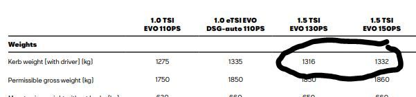

I am about to change my FR130 to an FR150.. (Despite having stupid safety features and more software bugs than I can keep count of)
Question: Anyone know if the Turbo and intercooler setup is the same between the two? and if it is difference, does the 150 have more tuning capability?
