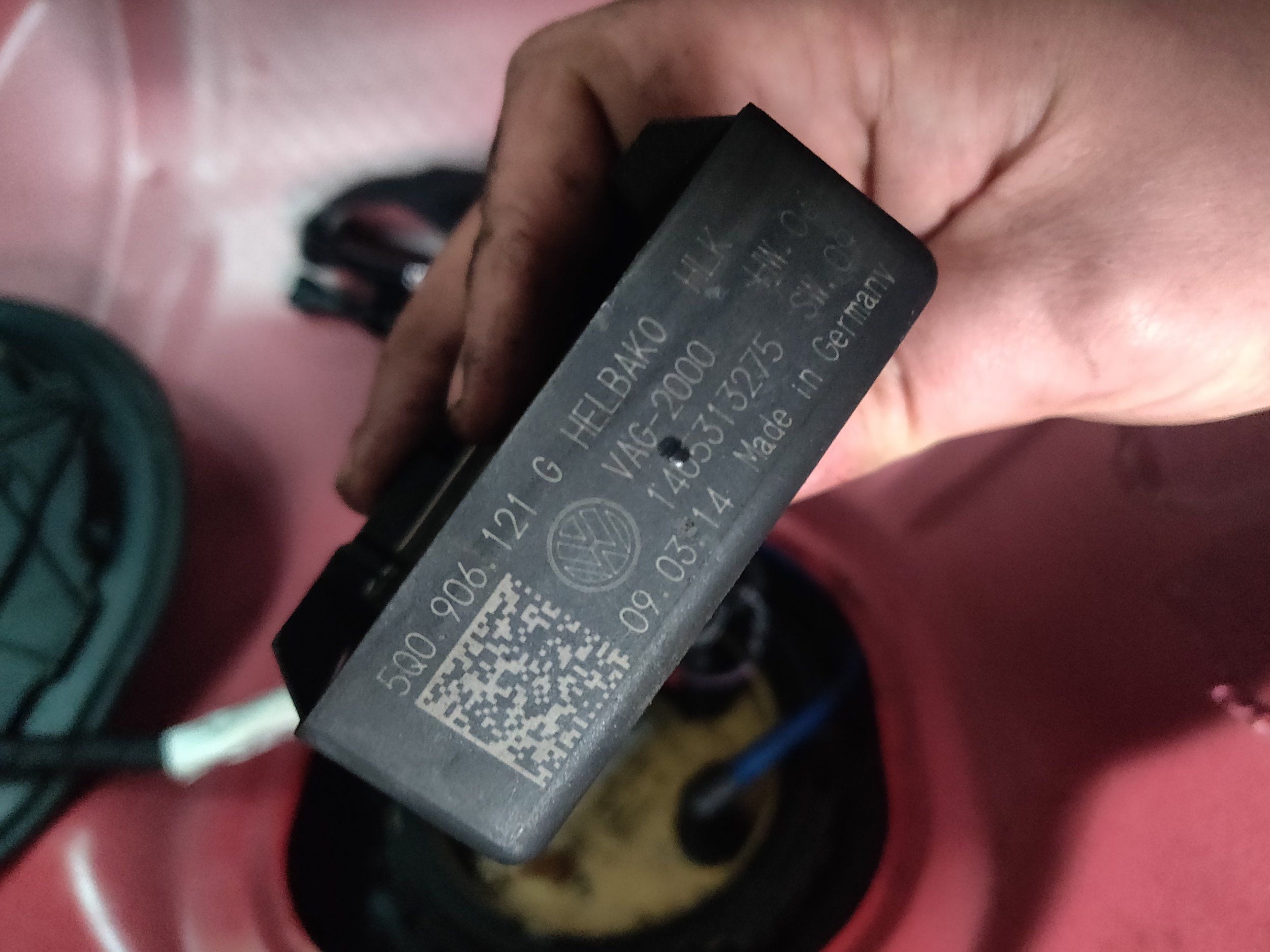

I've Identified the pump module is at fault part no. on the car is 5q0906121G.

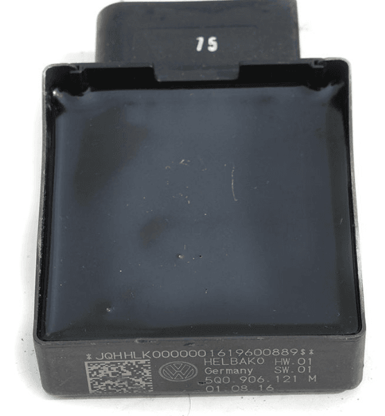

Took the plunge ordered a 5q0906121m from a golf 7. Shows comparability to my car. Just hope it's not a did like mine. Can't believe they fail so much.

Ive bought a 5Q0906121M which is a second hand part fitted to 2016 onwards. it has later software than mine, but think I've read as long a the software is newer, not older it'll be fine.

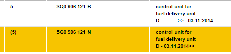

I can see 3Q0906121B and 5Q0906121N in my catalogue and in the images below:

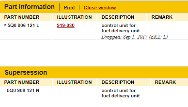

5Q0906121N seems to be the latest version, but I can't see that it has superseded 3Q0906121B on ALL cars - just 11.2014>
But I can't see 5Q0906121M which looks a little different. Strange. :confused:
I can only see it in a none genuine catalogue:

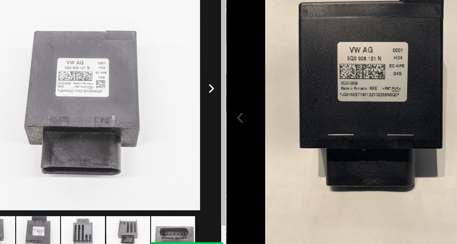

Will be interesting to see photos of whats on your car?
Here's what's on it currently. It get really hot and doesn't seem to be very healthy. Here's an exact copy of what's going on with mine from another YouTube user.

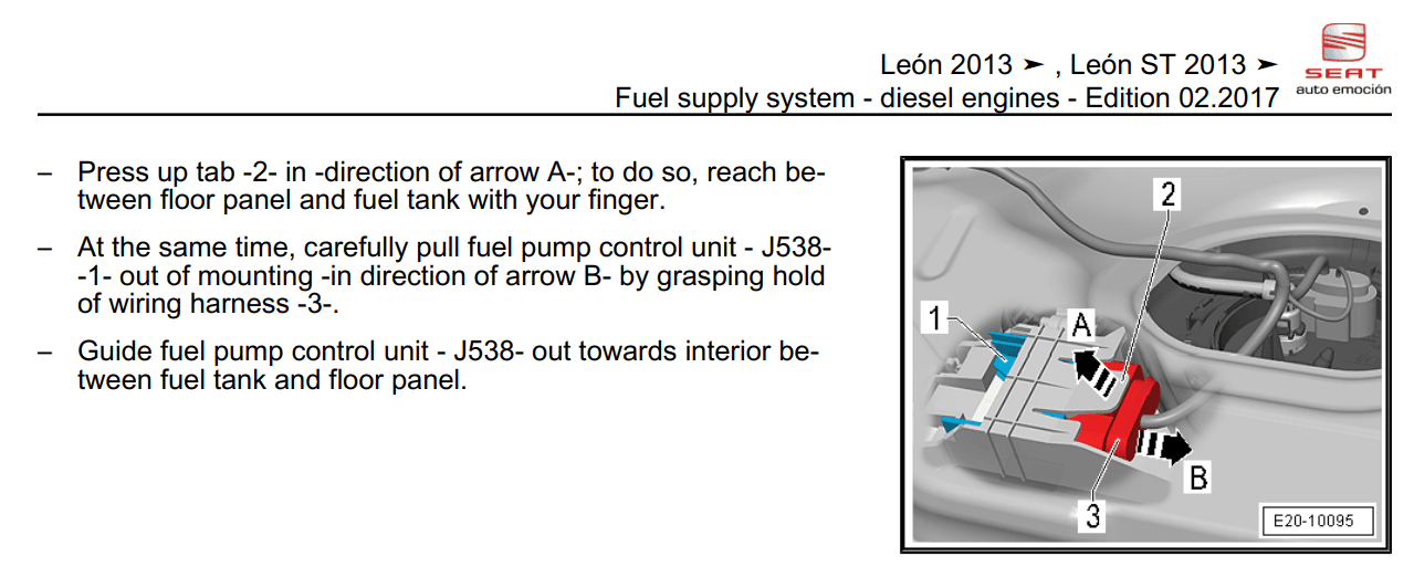

I think I'm having this same issue. Is there a trick to removing the fuel pump module? I've been trying to pull it out but it's in such an awkward position and not budging
