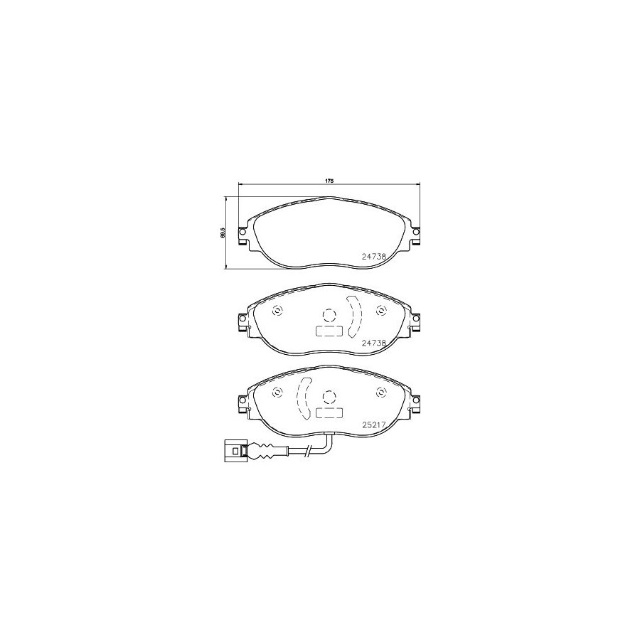

hi ive brought brembo ones from autodoc and they are the wrong ones, i phoned seat service and they said there are two brake systems fitted to cupra 300, one is trw and the other is brembo, seat said my car is brembo but there not, how can you find out? ive never had so much aggro getting pads for a car!
I think the only brembos fitted as oe to cupra are the 370mm drilled discs option with brembo written on caliper. If yours have cupra written on caliper they will be trw. I just did my standard cupra disk/pads with EBC and the calipers were stamped trw

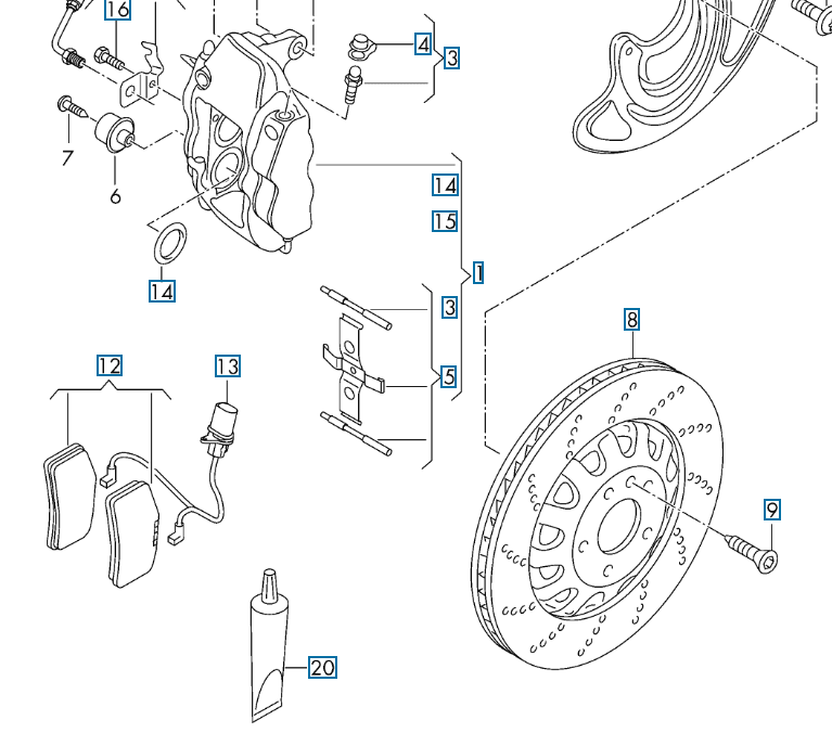

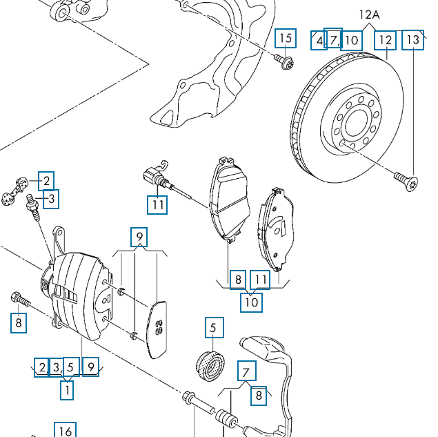

According to Seat you have a Brembo brake system - so large (expensive) 370mm composite discs and rectangular pads. Does this sound correct? You can share a photo of your caliper through your wheel.
Brembo brake system
TRW brake system
hi mate, no there not, someone else said if they have cupra on the caliper which mind have then they are trw, so at least im getting somewhere! cheers mate for your help.
