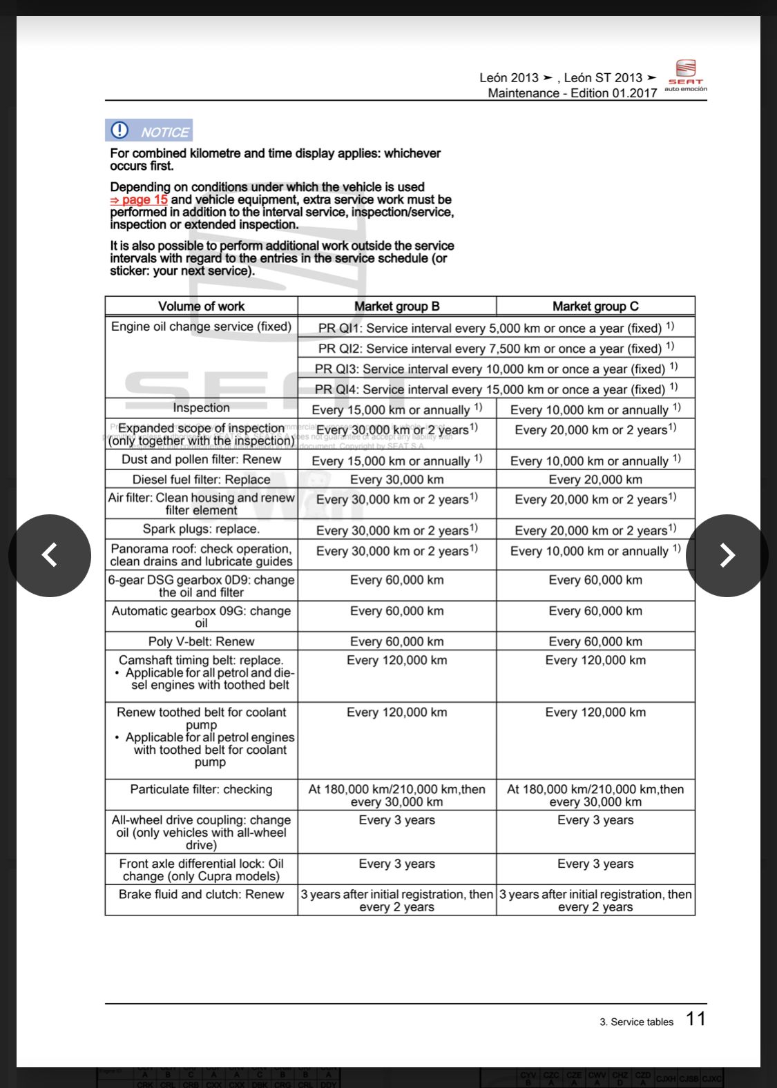

The maintenance manual tasks are listed below.
There is no interval for the differential oil change. The differential oil is separate from the haldex coupling used on the front (FWD) and rear (4drive) respectively.
The servicing referred to in the manual is to the differential “LOCK” on the Cupra models - the 4drive ST Cupra doesn’t have this. This should probably be annotated to (FWD Cupra only).
The problem you have is that someone on a service desk is misinterpreting the service manual as they have no idea about the mechanics of your vehicle.
Hi black_sheep.
That is very helpful, thank you.
