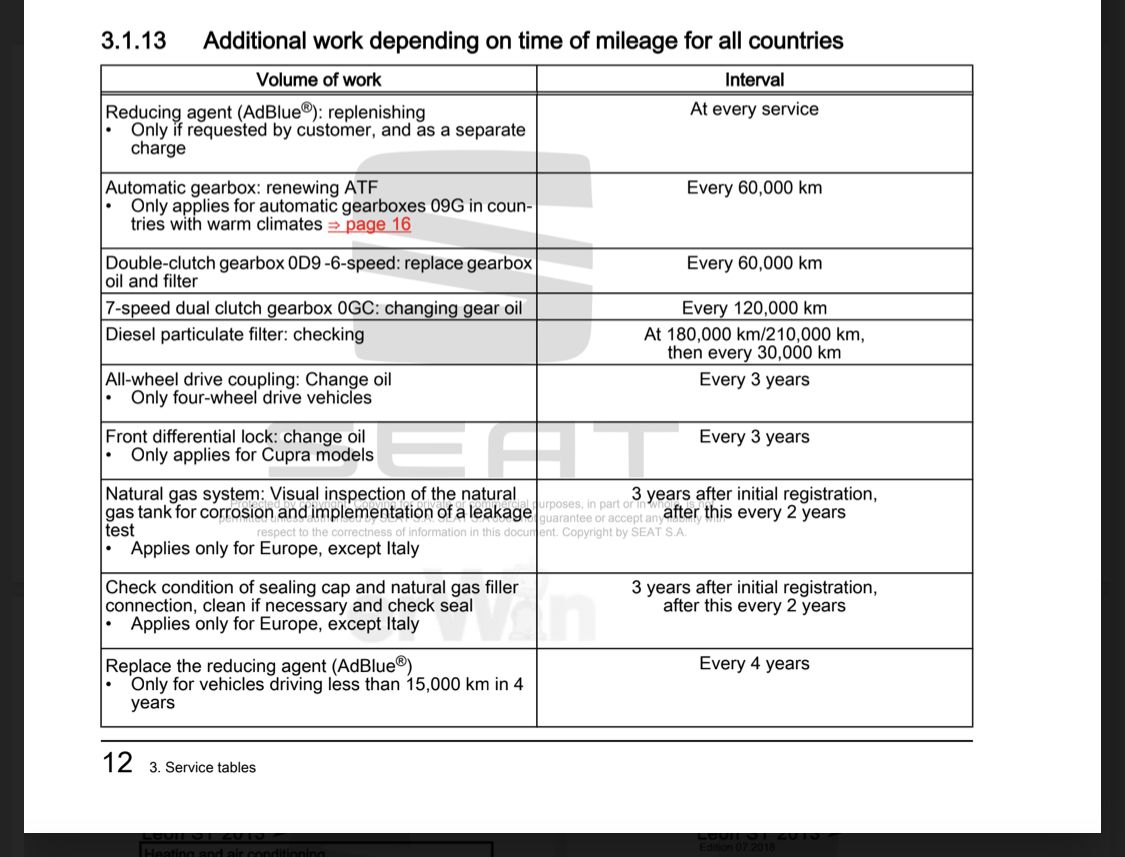

I'm booking my 2018 Cupra ST in for its 2nd service, at 3 years old.
The dealer says it needs a brake fluid change (that's fine), but that is also needs a front differential oil change at £89. I'm not sure I've come across this requirement before, nor seen it in any of the workshop maintenance guides.
Can anyone shed any light on it, and whether it is needed, how much it should cost etc?
Thanks.
The additional work table from the Maintenance Workshop manual is attached. Required every three years. The price is ok; however it is only a fluid replacement.
The front diff uses the same Haldex 5 system as the 4drive coupling on 4wd cars. I had my oil changed, but importantly had the pump removed/strainer cleaned at a VAG specialist at 18 months/17000 miles; not the worst they’d seen but oil was pretty dirty.
Might be worth a read of this thread:

Thank you, that is very helpful.
Seems pricey at £89 for a fluid change, so will see what they can do on that.
(incidentally, I was quoted £69 for a brake fluid change, and then got an automated email from the same dealer saying a brake fluid change was recommended and was £49, so I will make sure I only pay that!).
The oil is high spec and creates friction between the plates as opposed to lubricating. The service kit retail price is here:
Thus the price is not too bad - same as I was quoted at the dealer. Think that I paid £130 (from memory) for the specialist with the pump removal/strainer clean.
