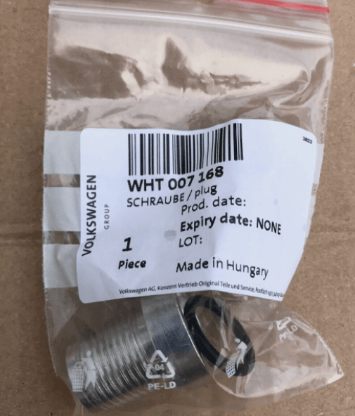

I've eventually got round to stopping by my most convenient VW Group dealership of a brand that does have maybe a couple of models that have this VAQ in the front diff, it was Skoda, when I asked the question as to what was the price of the drain/fill plugs - that SEAT and probably VW say must be replaced with new items if removed, ie P/N WHT 007 168 - I got the answer £8.10 + vat, but they are not a stocked item and are sold in bags of 10. Okay maybe there is not much call at the parts department for these, and the workshop will probably have its own section within the parts department, so I failed completely to buy a couple of new plugs for when I aim to remove the pump and clean its screen on my older daughter's 2019 Leon Cupra! I had already checked on ebay, but any on there were quite expensive and the shipping from mainland Europe cost as much or more than the VAQ drain/fill plugs. So - I reverted to Googling "Haldex spares" and I could not find any suppliers offering to sell these drain/fill plugs - plenty selling new VAQ pumps, screws and pump seals kits and the correct fluid - but not one that I could find was selling these drain/fill plugs, which was not what I found a year ago - very strange! I've emailed one supplier of Haldex parts to see if they will supply my with these drain/fill plugs and if so, at what price inc carriage, I'll update this thread once I've had an answer back from that supplier.
Edit:- and now I've emailed Cox, a forum sponsor for a price to supply a couple of these drain/fill plugs.
Next Edit:- the Haldex parts supplier does not stock or supply these drain/fill plugs, confirmed that to me 14/07/24.
WHT 007 168 is sold singularly - so I call BS on coming in bags of 10!
Pity they don't sell the o-rings individually! I bet they are a propriety size as well! :mad:

When I first looked at this maybe 18 months ago, it seemed like "every man and his dog" was selling these drain plugs in single units, then last week when I went back to the ones that I'd previously checked 18 months ago, there was now no mention of these drain plugs, plenty standard pump "bolts + O-ring seals" and even the correct Haldex fluid - but no drain plugs for the VAQ. Life is like that sometimes!
Anyway, Cox Motor Parts have sent out a couple, so that has solved my problem.
It was a bit disappointing to find that that Skoda dealership was quoting "bags of 10 only", which might actually be the case when they are dealing with VW Group for spares to buy in to stock, but still very annoying, possibly a quantity limit that would not bother the workshop when restocking. I could really understand why they didn't have it listed as a stocked item, but needing to buy a bag of 10 - no chance.
I've measured them as being "2.5 X 15" (CS X ID)mm I don't know the highest expected temperature, but Buna -N is rated at +135C/-55C or EPMD is rated at 125C/-35C hardness 70, so standard metric sizes.
