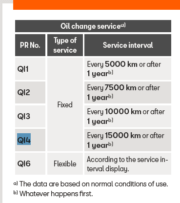

How do I find out what the service interval is for my Leon?
I had a text this morning, ostensibly from the dealer (they did know my reg number though) saying my car is due a service "in a month or so" and asking to book it in.
I bought the car new at the end of March this year, so it's not quite 9 months since I had it.
But when I check the Service indicator in the infotainment, (which agrees with the Seat Connect app), it says the next oil service is due when the car would be 2 years old, at approx 18,000 miles, with an inspection service due soon after, at around 20,000 miles.
Leaving aside the question of whether or not it's a good idea to wait for 2 years to service a car for the first time, how do I check which is the correct official service interval?
Is the service indicator right or is the dealer? (or possibly neither I guess)
The manual says (see screen clipping) that if my "PR No." is "QI6" then it will be on flexible servicing which would agree with the infotainment.
But how do I find out what the PR No is? In olden days, VW group cars would have a data sticker under the boot floor and in the service book, but I didn't find anything under the boot floor and I didn't get a service book at all.

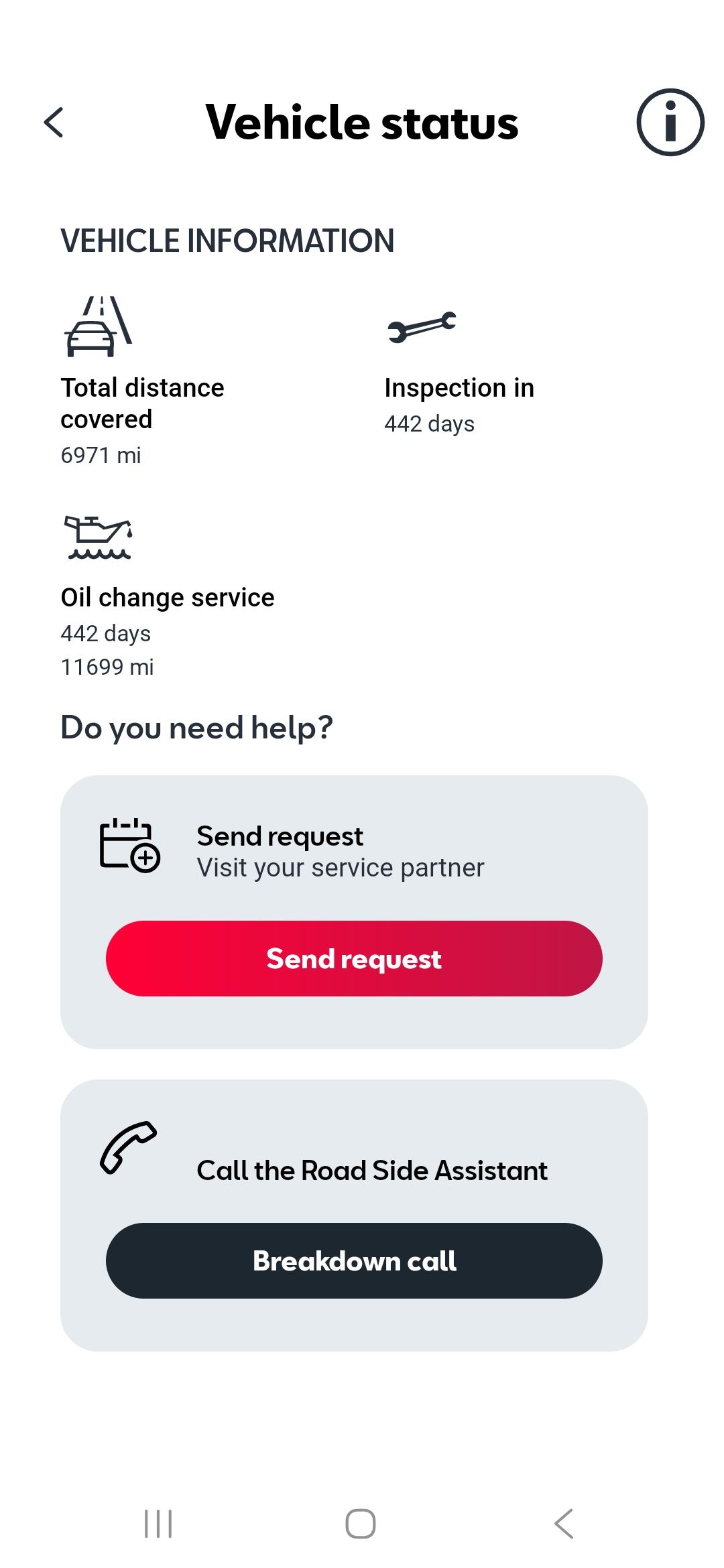

My car was also registered in March 2025 and set to 'variable' servicing so the reminder is as displayed below (from the App). As my previous MK4 when purchased I took the 2 year service package at £199. I called VWFS to confirm that based on a 'low' annual mileage it is possible to get up to 4 years servicing on the plan based on requiring a service every 2 years...and not getting into whether it should be serviced annually or not. I top up with VW508/509 approved oil.

Yes the display on my app looks pretty similar to yours. I don't have a service package though.

VAG stopped putting physical data stickers under the boot floor and in service books on newer models like the Leon MK4. The official PR codes are now stored digitally on erWin (or in the dealer's system). However, since your car displays 24 months / ~18,000 miles, that IS the dead giveaway for PR code QI6 (Flexible/LongLife). You don't need to book it in until the car itself tells you to!
