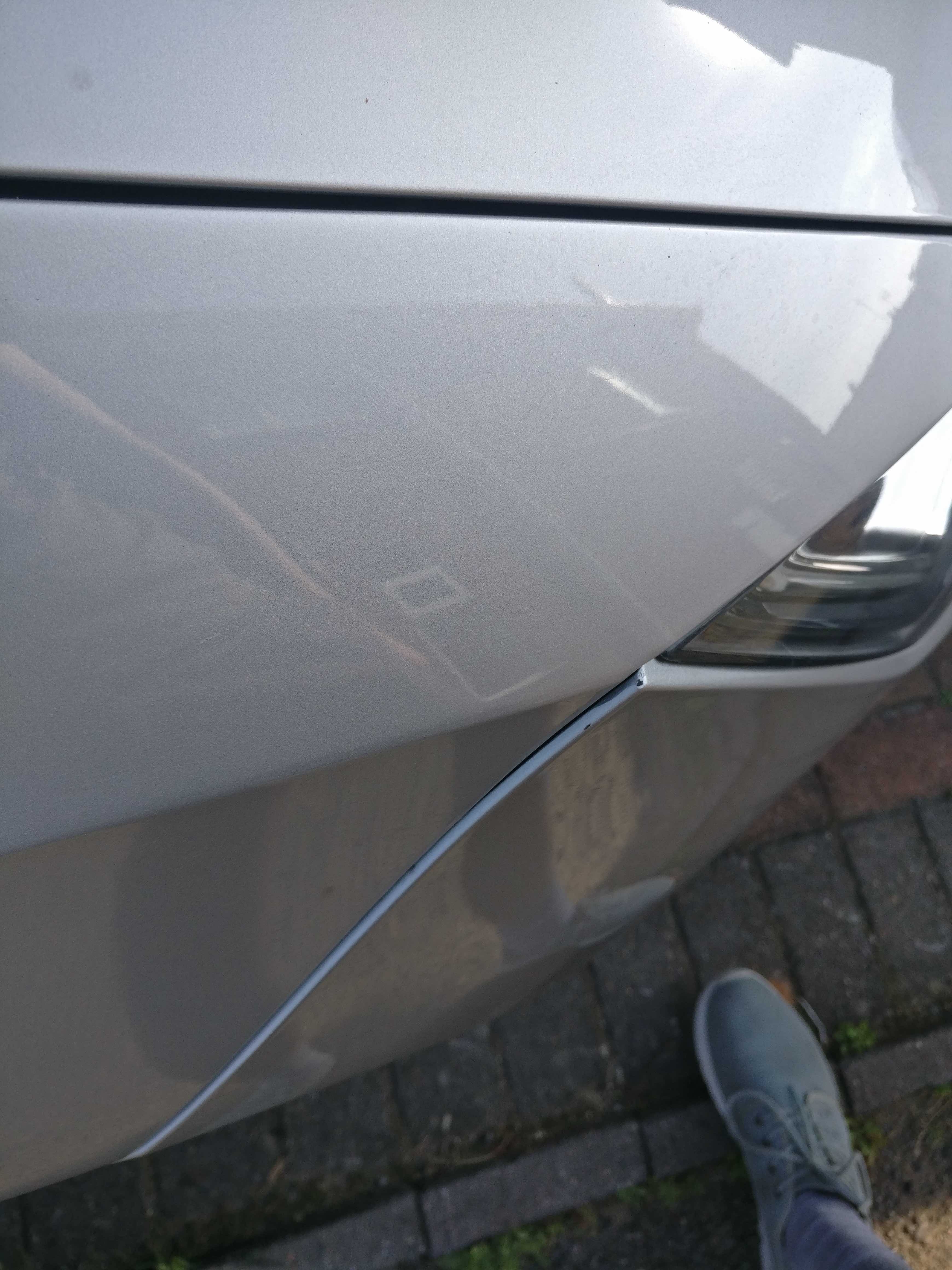

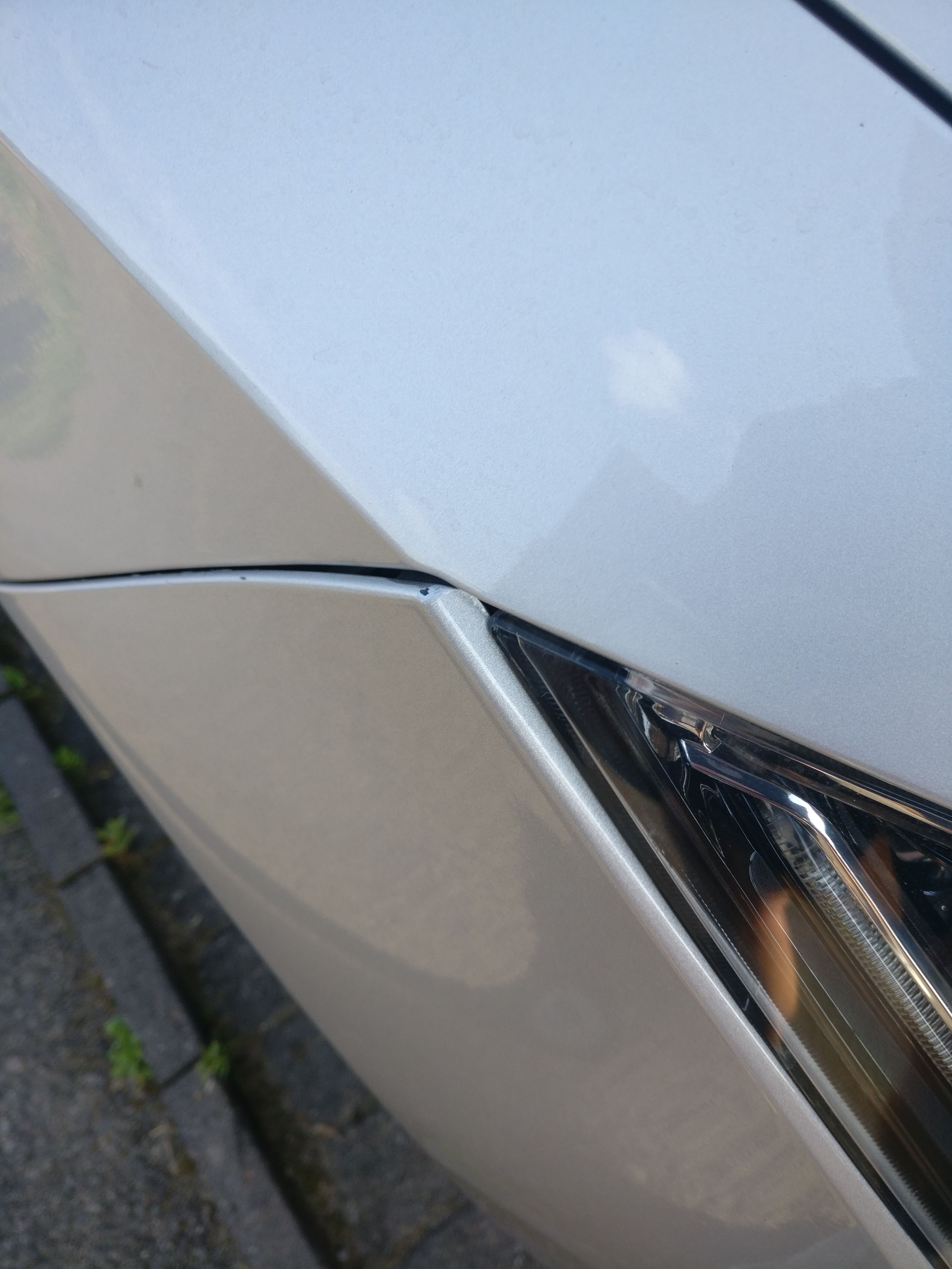

Hi all, first post here. I just bought a 66 plate 290, got it home and realised the offside front quarter panel, where it meets the front bumper has become detached. If you lift it slightly looks like a hook type clip is not fastened correctly, or maybe bent backwards? Is this easy to fix? Could just contact the dealer, but it's a bit of a drive.
Cheers

I had a very similar issue with the bumper on my 14 plate Audi A3 - In my case the bumper had actually separated from the inner ‘skin’ and couldn’t be popped back into place, a new bumper looked like the only option other than super gluing it.
Thankfully someone hit my car and the whole lot got repaired by Audi - Hopefully this isn’t the case for you and it’s an easy fix!

If it won't just click back into place then it looks like the loop and hook system which secures that edge has been damaged, either by the bumper being clumsily removed or by an impact.
Try pushing it firmly back into line with the wing. If it just pops straight back out then ask the dealer to replace the bumper skin - which I'm sure they will refuse.

Rang the dealer, they've booked me in next week. Told me that the car had had some work on it on the front, not sure what they meant by that, maybe when they serviced it ‍♂️
I opened the bonnet and shone a torch in, and I could see there is small black tab (is this the inner skin mentioned?) that the loop of the quarter panel looks like it should hook on to, but it just won't sit on it when just pushing the panel.

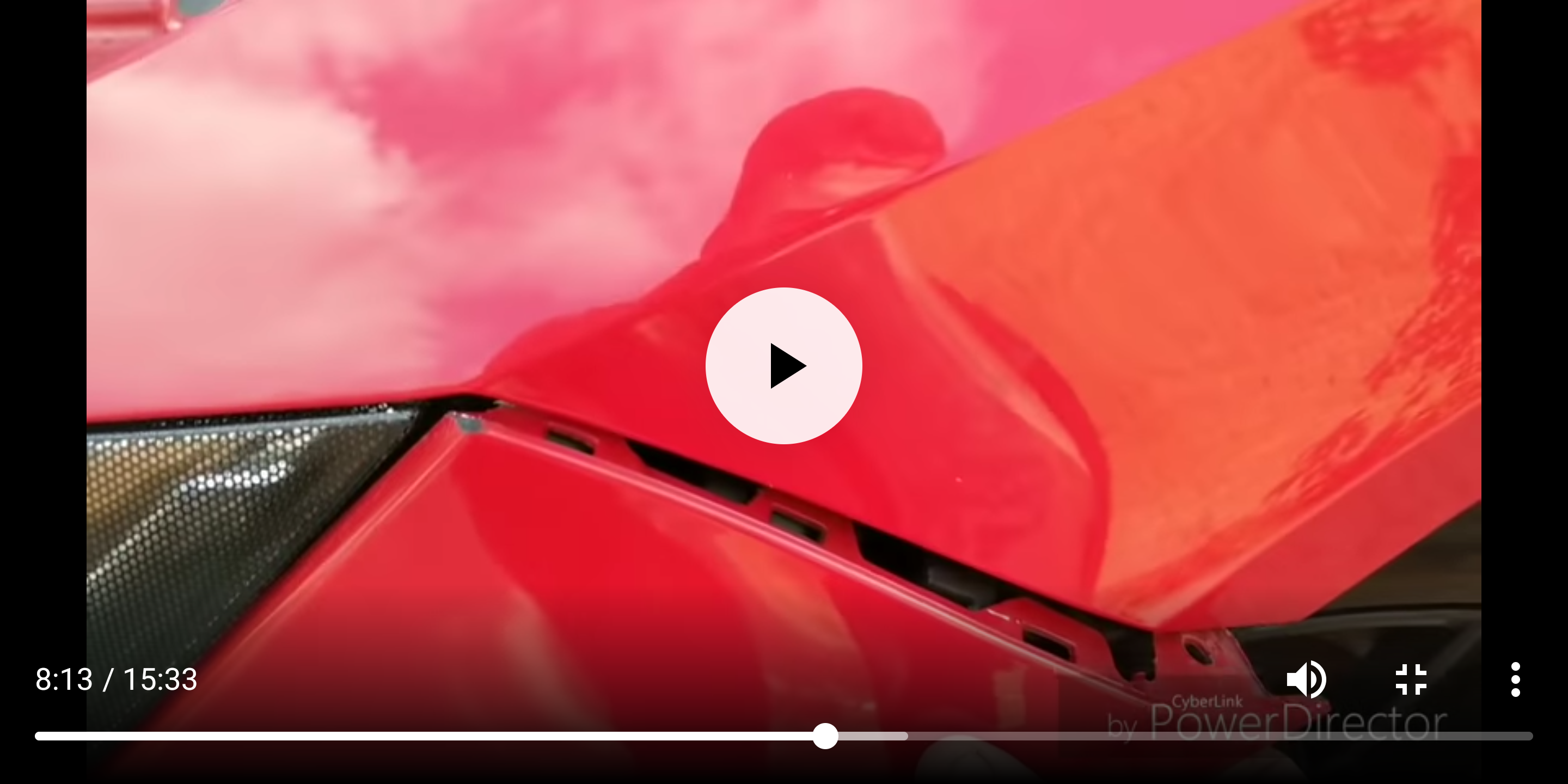

This is from a YouTube guide on the mk3 front bumper. You can see the tabs on the bumper skin which are easy to shear off.
There no reason to remove the bumper for any service item, only for accident or fault repair.

So on mine those tabs are all still there and look to be intact, just doesn't clip onto the black tab beneath.
I'll ask the dealer what work they were talking about then, as well.
