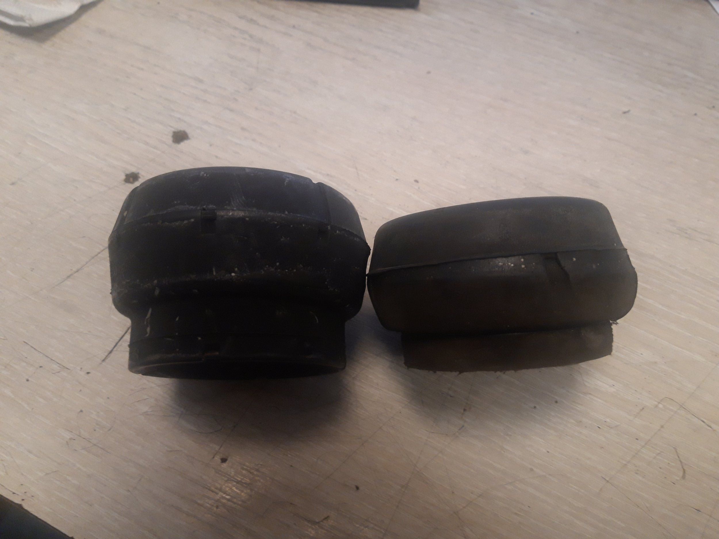

Little update.
Managed to fit one new top kit. The side that was making the noise.
The new bush sits about 5mm taller than the old one.
But trusting TPS i fitted it anyway.
Car still sits level and the noise has gone.
So away fishing this weekend :)
Will do the other side next week.
