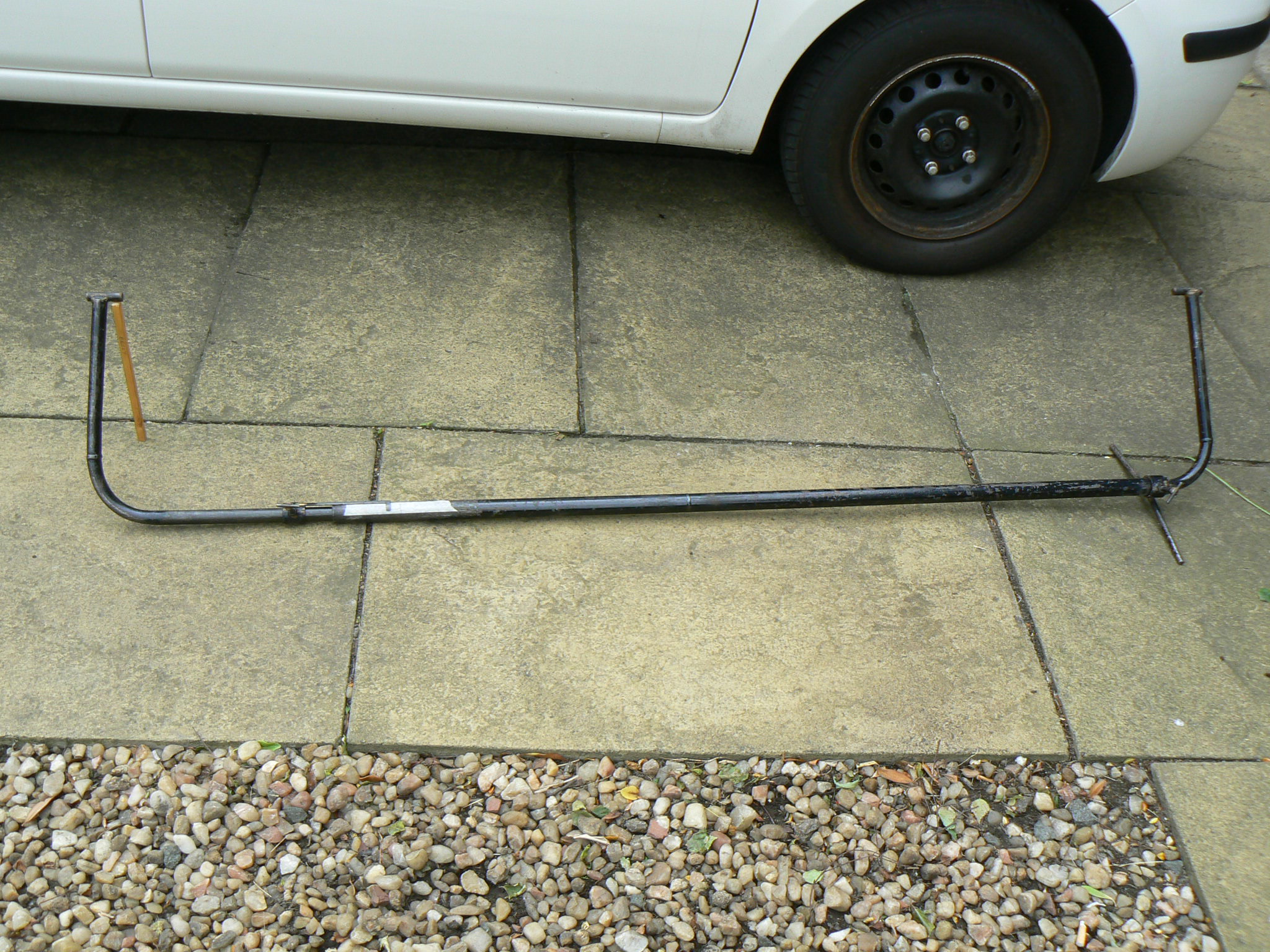

I have my own tracking gauge (it only does toe and on a majority, but not all, of modern vehicles toe is the only setting which can be easily adjusted - was featured in Car Mechanics Mag a few years back) and I use it on all the family cars whenever I'm doing a service. Other people see me doing this - I work on my front driveway - and it invariably draws comment and ends up in me explaining what I'm doing, followed by "you wouldn't like to check mine for me would you?" Checking takes only minutes so If I've got the time I don't mind obliging - I don't offer to carry out actual adjustment - It's very rare indeed to find a vehicle which is spot on! A noticeable number are out by enough to measurably reduce tyre life. In my opinion comprehensive prechecking is very seldom done in many garages. I also think that rubber bushes are a pest in that, due to the nature of rubber, it's properties quite quickly break down. The bush then becomes "relaxed" often tearing away from the metal parts, and overly compliant spoiling the taught feel you get in a new car and causing a degradation in road holding and excessive tyre wear. I think that worn - but not worn out - suspension components and brake fluid which is not changed every 2, or maybe 3 years, are two of the great neglected areas in car maintenance and are potential contributors to the accident statistics.
Just as an example ask yourself: When did I last change my brake fluid? (or ask the garage to do it - should be done every 2 years but they probably won't unless you specifically ask). This concerns me enough that I bought a boiling point (not the cheap resistance type) fluid tester and use it at least every 6 months on the "family fleet" of 6 vehicles. Thankfully I've only once in my life experienced true brake fade with the pedal going almost to the floor - a most disturbing experience I never want to repeat. This tool gives great peace of mind.
I made up a tracking tool, a serious bit of a faff to use, it was a wooden platform with 4 casters, 4 pipe clips, a single roof bar which is adjustable, replacement ends with cranked alloy rod with a few different ends to best suit the inner face of the wheels being checked and a couple of 6 inch rulers - great idea, quickly replaced with a Gunsons Trackrite gauge and balance mat which mimics the height of the Trackrite. Not so easy to use in my current house, it takes a lot of guts one drive under power into the garage and stop before hitting the back wall!

I've thought about a trakrite several times but always held back at the last moment. Is it as good as I would like to think it may be? does the balance mat for the other side actually make a difference? Here's a pic of my home made effort - looks very heath robinson but works a treat and is acceptably accurate. Used it for over 30 years so well proven but very wasteful of time when actually making adjustments.

You asked a question about using the balance board with Trakrite - honest answer:- well I was looking on the Tool Academy website for something, and that item sort of popped up, so I just had to buy it, okay it is just a rectangle of hard thick rubber sheet.
The idea behind Trakrite as you might already know is that you adjust the toeing to give zero toeing when the car is being driven under its own power, so it seems to work okay, but like any other DIYer tracking checker, it is only the beginning - not like the drive on, check, adjust that you get with the Hunter etc bench.
