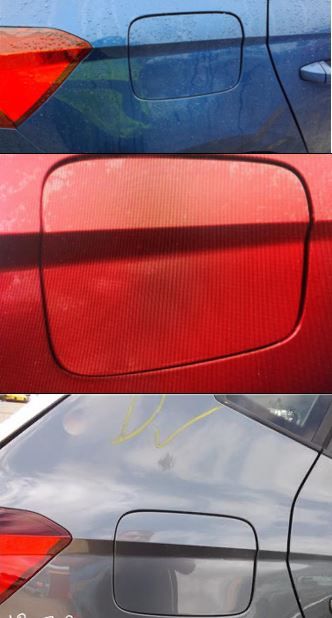

2017 Ibiza - fuel flap dropped (bottom left hitting car chipping body paint). Replaced by Seat under warranty but 2 months later same issue. Replacement of hinge and flap. Flap requires painting as Seat will not change flap over - even though a 30 second job, could make matching paint so much easier.
I'm not a petrol flap stalker but some random pictures of other Ibiza's online seems to show an issue - anyone else had a repeat issue?

Update on original post.... 3rd fuel flap hinge fitted 6 weeks ago along with new painted flap. Flap rejected as you could see primer instead of paint on edges of flap (smart repair job, not body shop). Back at dealer last week as flap catching bodywork again. Dealer readjusted flap (no idea how as it's fixed) but no better.
Similar reported issues with 2018 polo's.
Seat UK don't want to know.
Either weak part or issue of how it's attached to body of car.

it appears that my MY08/2018 also caught this disease, after only 22000 km, and not so many fuel flap open/close actions to justify its current state.
The lid opening mechanism was bad and often resisted since day one. You had to massage it at an angle to get it to open, but I got used to it...
Yesterday I noticed something was off with the flap...
I compared the photos to how it was when the car was delivered. Even when new, it wasnt perfectly centered, but it wasnt sagging like it is now.
Now it looks similar to the red photo in the original post.
I can definetly see a larger gap on the right edge (and a little on the top edge) of the flap/cover, and less of it on the lower left side relative to old photos.
So it is starting to sag diagonally to the lower left corner.
The hinge has a little bit of wabble, but nothing concerning to its structural rigidity. The flap itself is also firmly attached to the hinge, although I can see a small gap where the flap and hinge mechanism meets. I can see the attaching clips right in between the two. Not sure if this is expected or if it should be flush...
Any info on how to resolve, or any news from the service shop would be appreciated.
Definetly a unpleasnt experience and stupid design for such a new car...
