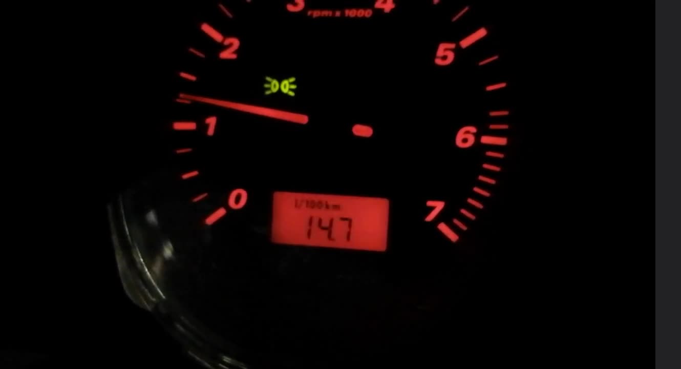

My Ibiza 6L 1.2 64HP, has a big hesitation issues as is possible to see on the video. Instant consumption goes to 99.9L, and also the car give me a huge hesitation / choke / jerk / judder - - that is possible to see since the RPM's pointer dropping. The 1st hard motor noise, is from a motorbike that passed by me. This is an video sample of a slow and careful start.
Many times when I accelerate to start, the RPM pointer goes up, and immediately goes down like 500RPM's or lower, like if the car is failing to turn off, while changing to 2nd gear.
Every time I stop, and accelerate on 1st gear the car hesitate, chokes, is possible to see the RPM's lowing down like if it was on "limp mode", and got an huge instante consumption - same as a big high final consumptions - around 11 - 12L by each 100Km's - calculate by me (Gasoline filled vs kilometres travelled) - which reflects the on board computer, which means that the onboard computer is giving me the right results.

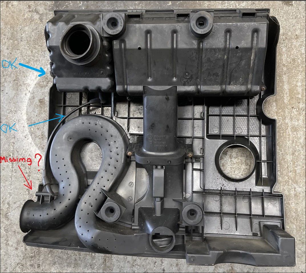

I think that I have a small leak on the vacuum system or anything (hose) or any missing hose, but since I can't find a proper complete vacuum diagram - after months of search, and asking everyone (even Seat) - also did a post here without replies. I simply quitted. Looks like, nobody knows about the hose's on this engine/Air filter/Engine Cover connections. On EKTA, does not shows the complete vacuum diagram/system - it only show's some part's. I don't know if, on this engine is missing any hose or not - like on the pic attached.

Only from memory, the missing hose from the air cleaner, if that engine should have it, then it will be part of the "crankcase purging system" - ie there might be a system where fumes from the engine's crankcase, mainly "blow by" from across the piston rings, ends up in the crankcase, and if not purged out, would cause some pollution as they escaped into the air, so, a small and controlled by a diaphragm valve, volume of fresh air is allowed to enter the crankcase, they are removed from the crankcase at another point using the natural suction of the air being taking into the engine, and in there these gases are burned.
You would have to check the schematics of this model of engine to see how/where that is done.

I does have the Haynes Ibiza 6L manual, printed version, but don't says nothing about vacuum system. Also checked on EKTA but no luck - nothing shown.
Do you have any software/manual that you can advice me, were I can find the vacuum schematics and further details about this car/engine ?
