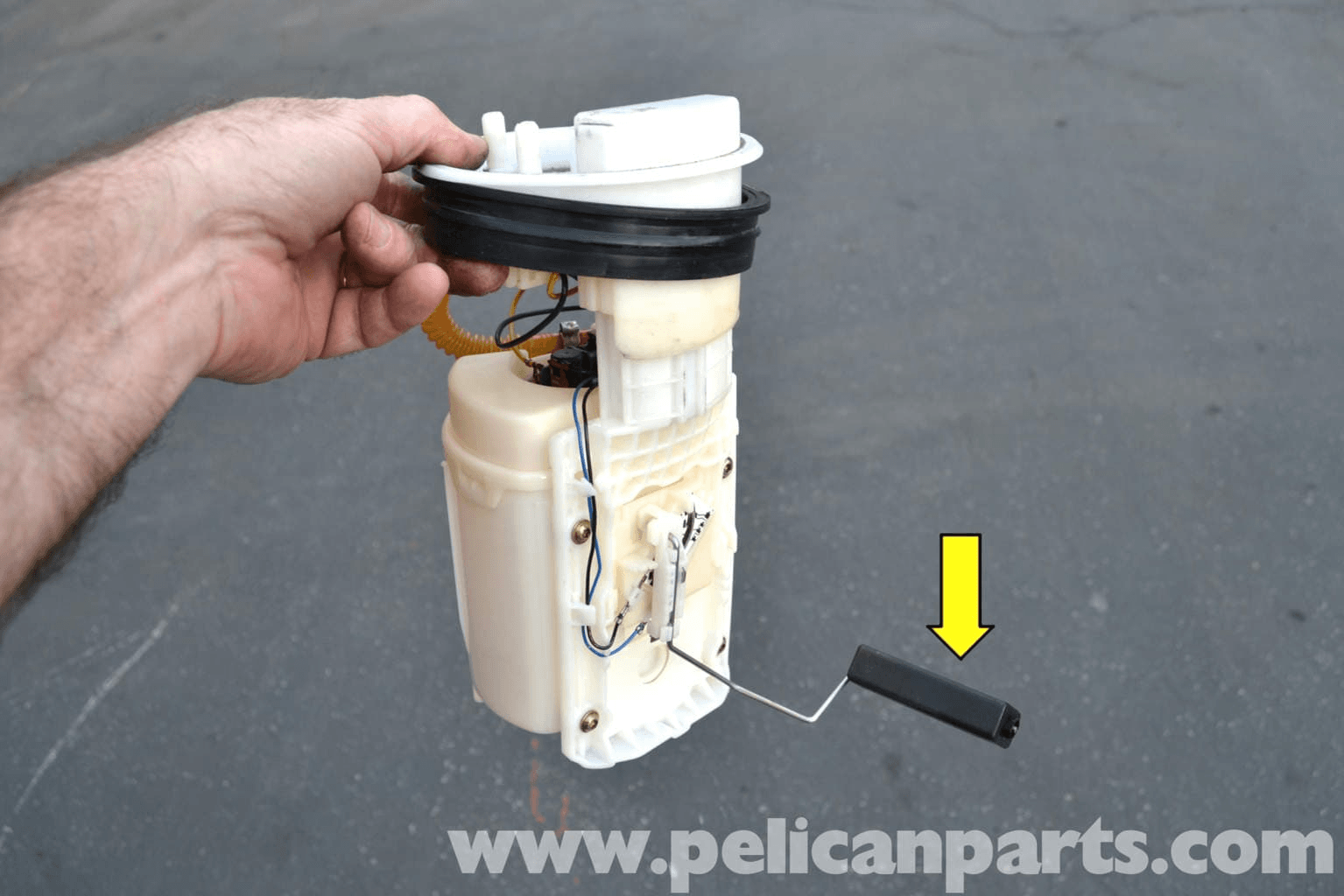

The only real picture I can find is from a Golf MKIV pump, i'm assuming the actual pump sits inside the white casing (you can just see the top in this picture)
Where about were your faulty jubilee clips? Is it the flexi pipe to the rear? you can just about see one oetiker clip??

Yep its the flexihose that you need to worry about. just replace the clamps on it with oetiker clamps good and tight. If it worked then you'll hopefully improve your cold start issue. let us know
