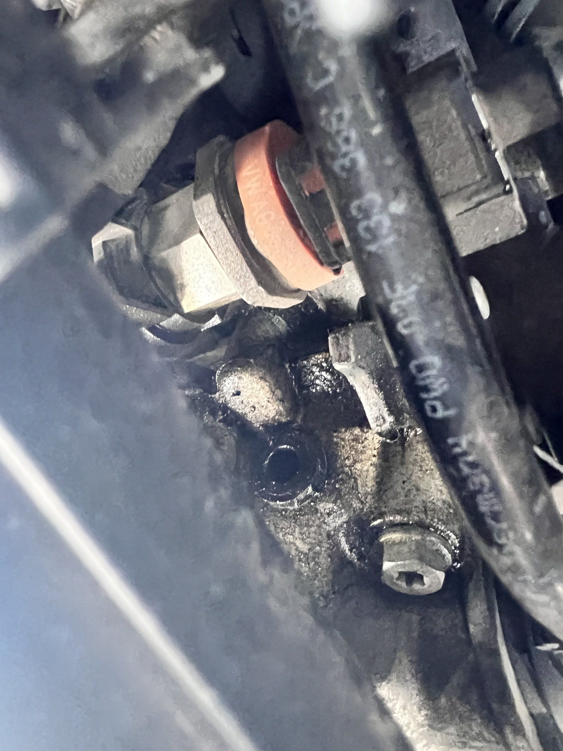

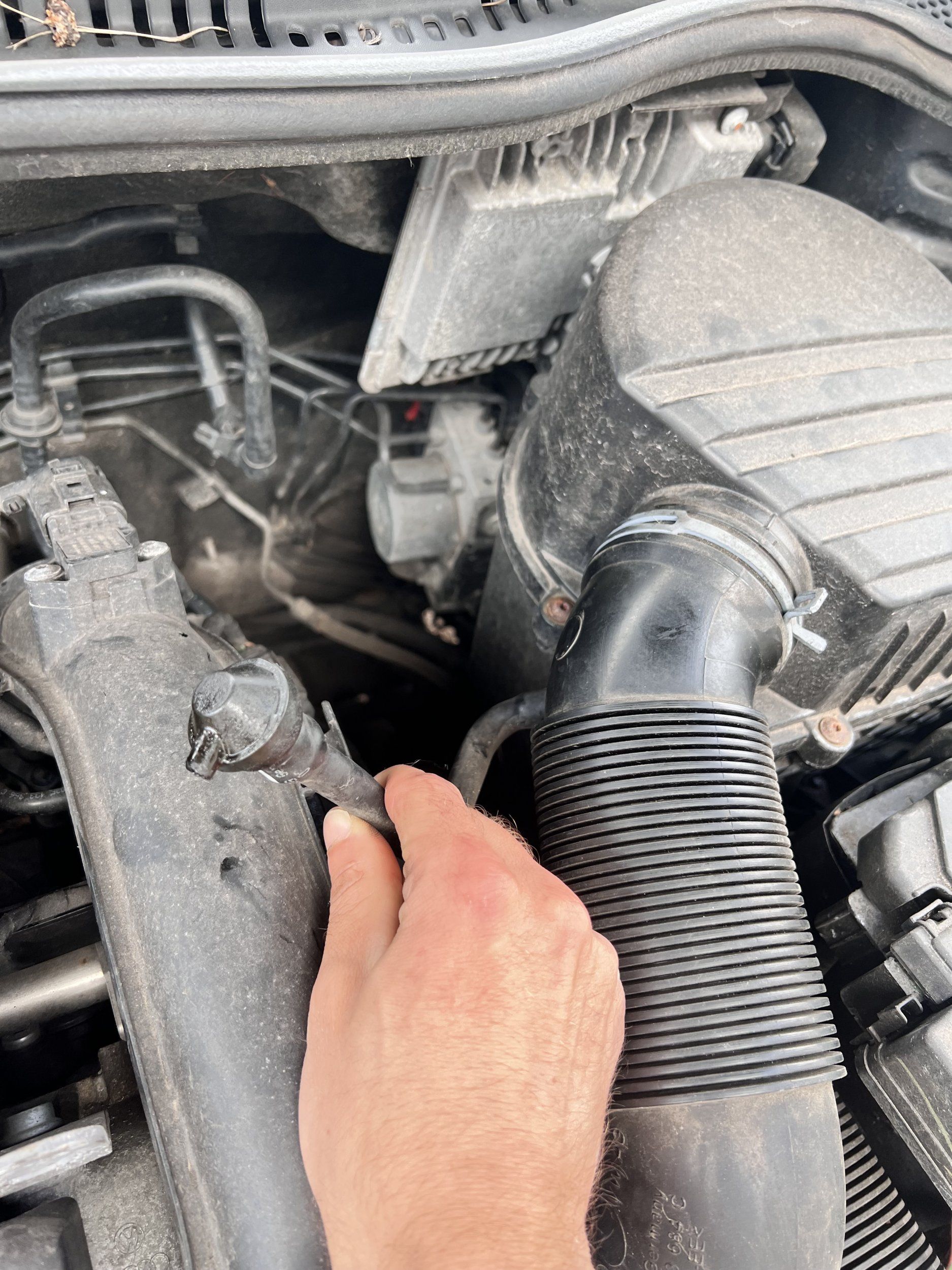

Had another look and found this that looks broken off
