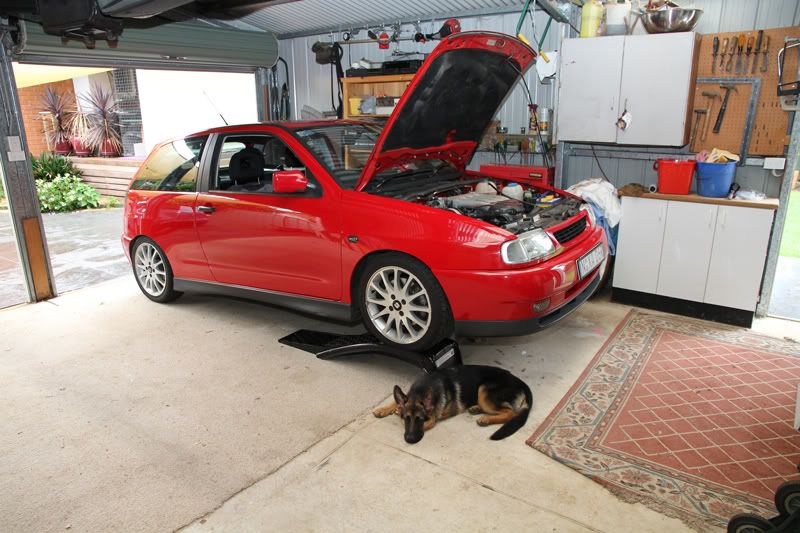

I put the car in the garage & with all the lights on there was nothing except the smell .
So today was allocated to sorting this out .

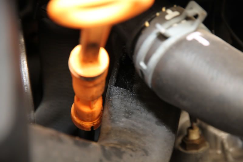

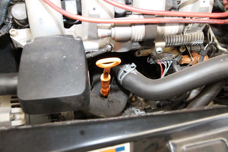

I started by pulling the airbox out to check the charcoal canister & with everything out I ran the engine, there was the smell, in front of the engine & there seemed to be some puffing air flow I hadn't noticed before behind the alternator, ok that seems strange, I pulled some of the plastic covers off & looked further, then I noticed something moving down by the dip stick, bingo The main crankcase breather pipe hiding under the main water pipe!!!!!!!!!!!!
This angle is deceptive & one of the covers is off, the hole looks obvious but if you stand in front of the car to check the oil the hole isn't in sight!

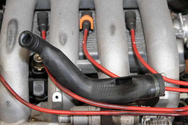

At a glance it looks like someone has cut a section out of the pipe but the pipe in that area is heavily perished over the full diameter.
So with the aid of my trusty helper I made a quick repair to keep the car on the road while I hunt for a new pipe
