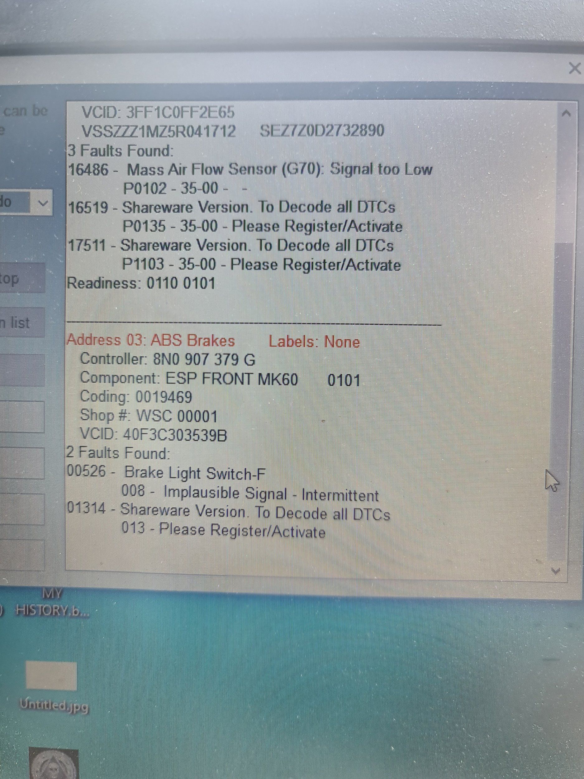

Hi. So I'm a newbie to owning a leon cupra r, when I picked her up. It had a speedo and fuel gauge issue, that is now sorted, I had the car plugged in, and I'm getting these codes shown in the photo, have tried a different maf and it is still coming back.
Also, my fuse for central locking,windows, and interior light keeps blowing.

From those fault codes you have a faulty brake pedal switch too.
