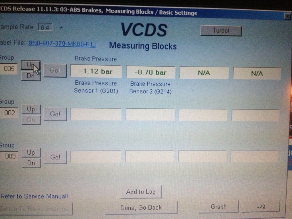

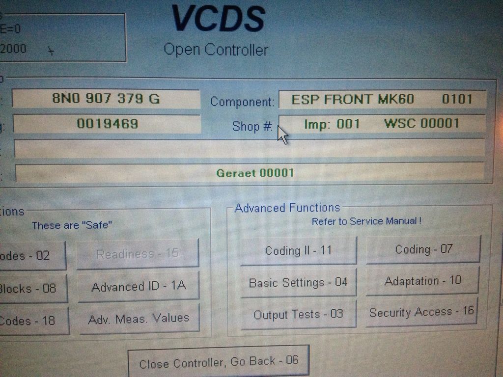

I logged on vag-com and It said esp mk60 does this mean ive got the system where the sendor is part of the abs pump?
I then logged on the check the g201 and g204 sendors and both were reading negative bar them when pressing brake peddle they both went up evenly would this indicate the sensor is working correctly?

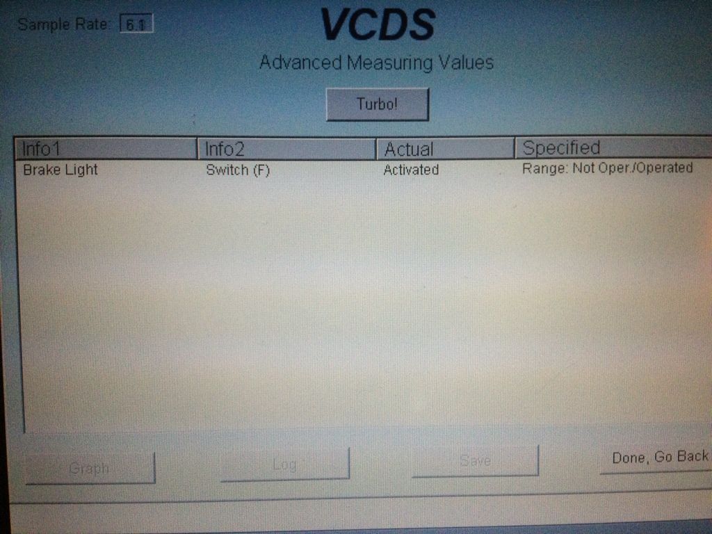

I also checked the brake switch on vag-com and that seemed to be working too?

Both sensors are in the master brake cylinder. Both your readings look fine. Normally if they are faulty they have a value of 7 or above at rest without any brake pressure. It could be an intermittent problem or it could be the brake switch.

I cleared the vault but it came back straight away in split second. The break light switch operates the lights and vag-com could see it working but do they play up causing these problems?

youre brake light switch was working on the data block so it was OK
as ive said allready G201 is in the ABS PUMP not on the master cylinder
you have Teves 60 ABS not Teves 20

Thanks for confirming what system I have. I got conflicting information. The light came back on today then went off again so I need to get it sorted. I assume even if the pressure readings are ok even when the light is on the abs pump still needs replacing?

All the MK1 LCR's are based on the mk4 platform and have both sensors in the master brake cylinder (all the ones I have seen at least).
The G201 in the ABS pump is usually for the MK5 platform.
Look under your master brake cylinder you can even see it in situ.

Getting confused now. Got in touch with seremotors and they said my car has got the 2 sensors in the master cylinder even though I've got the teves 60 system!! So is my problem the sendor or is it still the abs pump?
