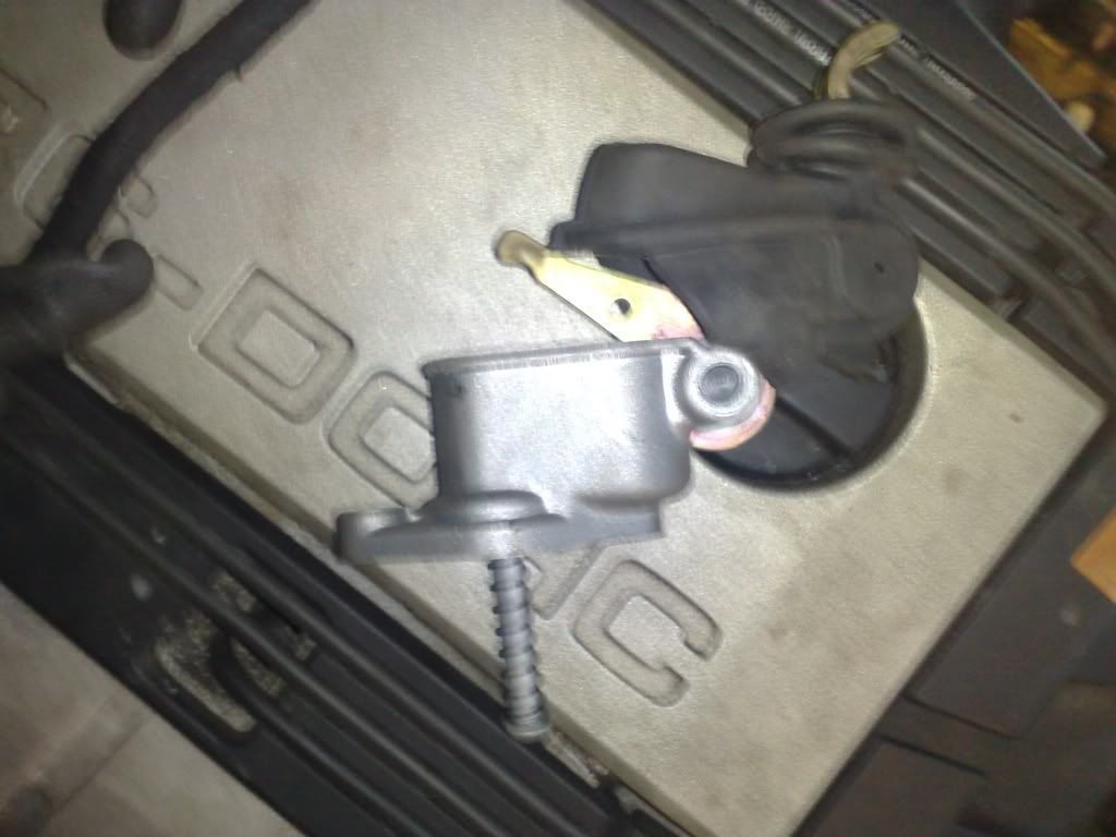

i am using the vr6 box with a cable clutch using the 2ltr 16v ibiza clutch actuator and bracket
also i used a 1.4 8v ibiza adjustable clutch cable
for hydraulic use a tdi pedal box and plate assy but that means changing it over
personally i wish they had left em all hydraulic
thank for the help canyou buy the 2.0 16 valve part new fom vw/seat/gsf
do you have part number?
