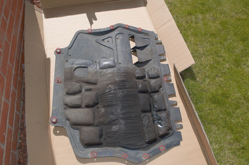

To begin with you need to either jack the car up or stick it on the ramps to gain access to the under tray. There should be 12 torx bolts holding the undertray on unless like mine a couple of them have snapped off over the years.
