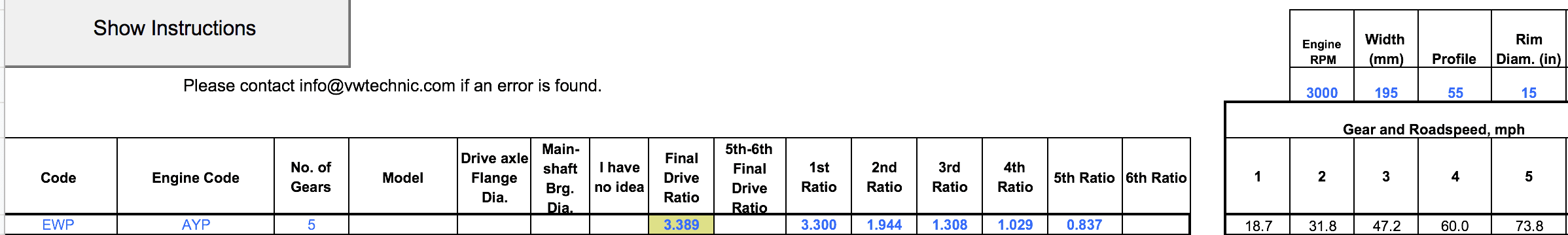

The Ibiza Cupra 1.8t gearbox is one of the longest petrol gearboxes.
In my eyes it is a perfect gearbox for a MK2 1.8t swap, considering the Ibiza was heavily based on the Golf MK2/MK3 chassis.
i've attached a screenshot of speeds with a 195/55/15 tyre at 3000rpm.
Top theoretical speed at 7000rpm is 170+mph. in 5th
