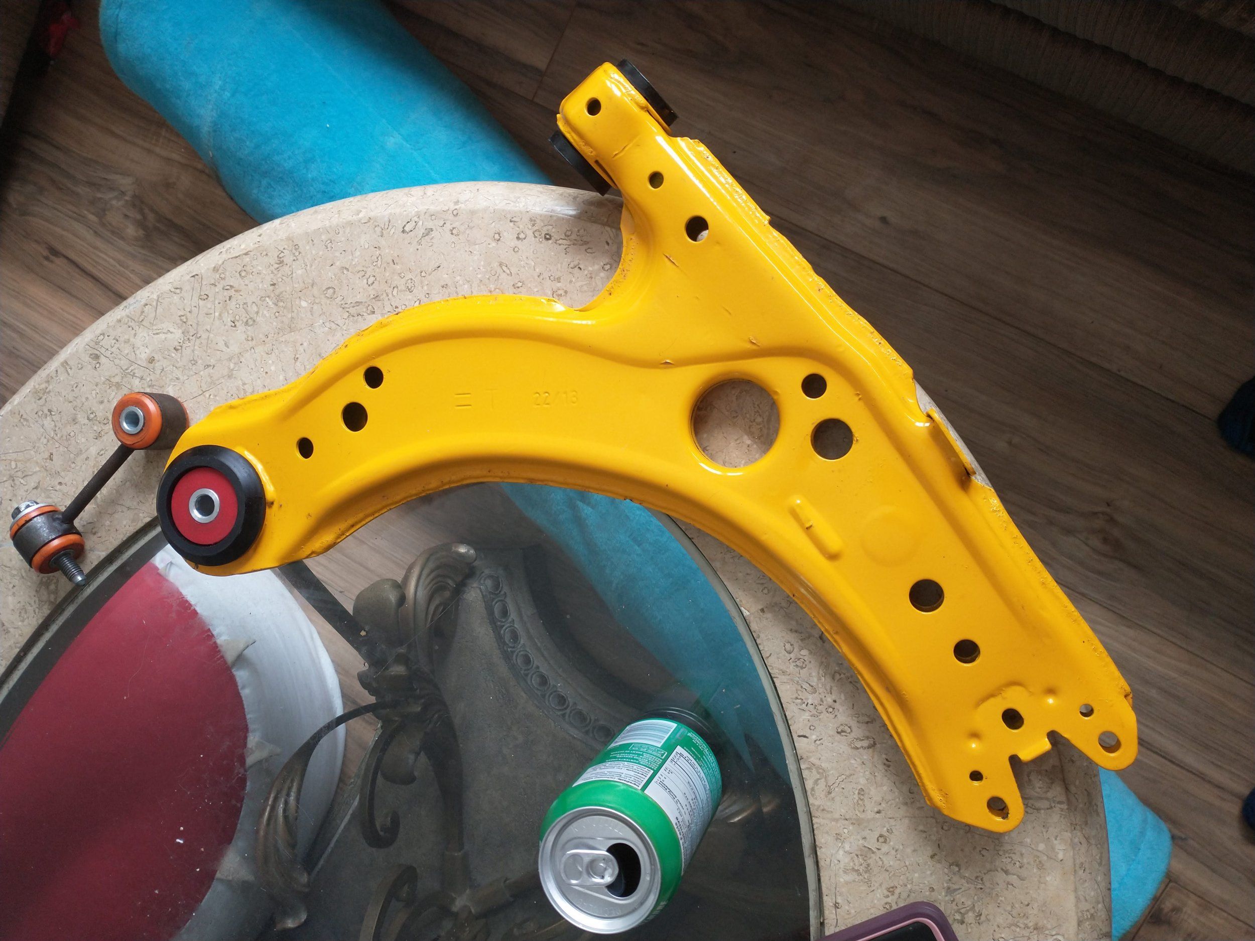

So I went with the PSB 21mm kit from eBay for my Jetta. Fitted in low temps and the car drives much better now, alongside poly droplinks and new tie rods.
No squeeks at all and if anything the winter tyre drone on the concrete roads, namely the 401 north of Toronto is louder but not by much. Could be the car is quieter from next to no rattles and squeeks from the knackered bushes I replaced
Shall buy the same bushes for my TT arms for the Leon.

You're braver than I am - it's raining here and I'm not going anywhere near the car until that clears up.
At least the cold weather will make the bushes shrink slightly and be easier to fit...

I pressed the bushes back in December here in England. Only bushes I had to fit was the ARB ones and they was a pain. Cleaned the threads and used long nose pliers to pull the bracket to the subframe so the bolt would take.
Lesson learnt is do that bush with the inner tie rod removed if your doing that job also.
