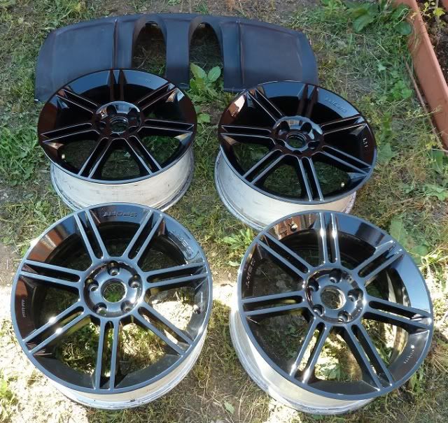

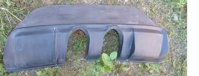

Right finished sanding the lower half down today - rather hot to be doing this is in the blazing sun in the garden !
Just need to bond the two together one night after work this week
Also picked up some wheels over the weekend. 18" Black Seat Sport BBS wheels. Someone else has refurbed them to a pretty good standard, its a shame something got caught in the paint on one wheel whilst the paint was drying, I've rubbed the portion down (its only about 15cm) with 1500 grade wet and dry so I can quickly repaint the area.

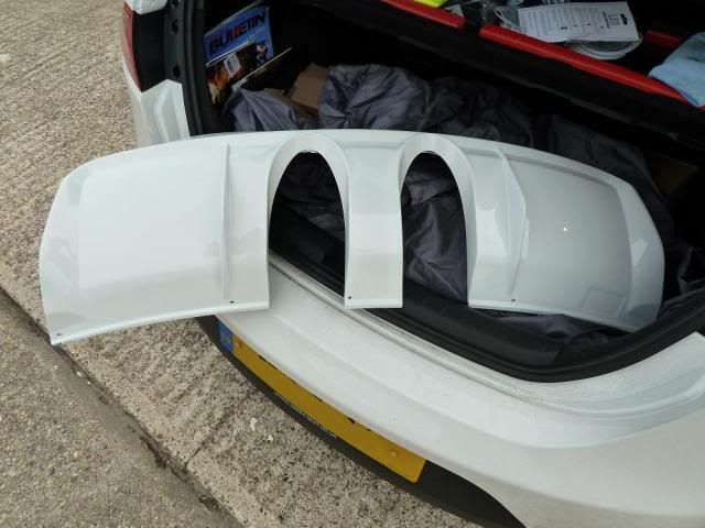

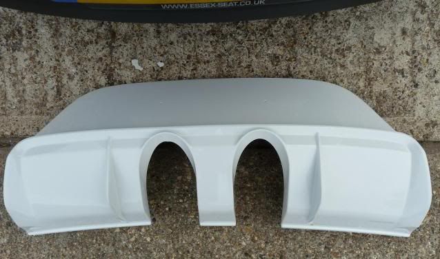

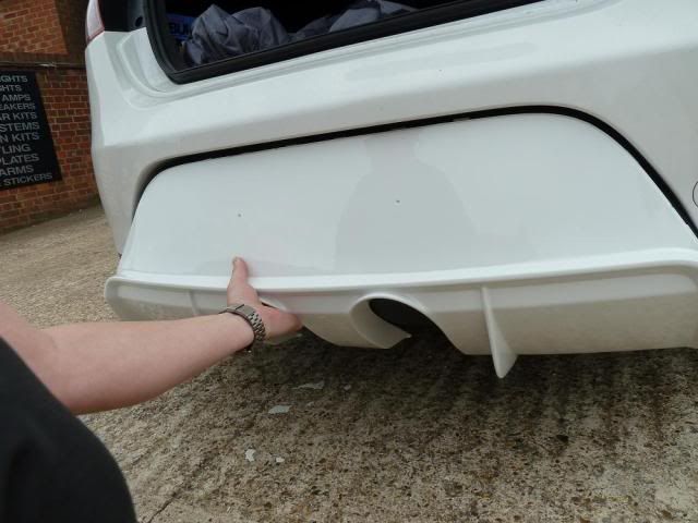

Well finally got the rear valence back from the bodyshop.............
Just got to fit it one night this week !

Looks somehow very nice! ... or different :coolthumb

I didn't want to do the rear in black as I haven't gone for a black spoiler or mirror caps and after all the K1 rear is also a lot of White so I think it'll look fine!!!
The part where the number plate goes looks great in gloss White and not a stupid mottled effect like factory black R rears
Worst case I'll take it back off and spray it black lol!
