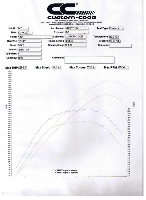

here you go my jbs04 rr readout from 2weeks ago

Great stuff Beezaboy, its pretty much on the mark then eh. Are you happy with it then? i bet it flys

thats an impressive result there! My AM04 turbo only made 260 bhp but 307lbft of torque, apparantly it was mapped conservatively but think that was crap to be honest, most other k04 cars seem to be getting 280 minimum. Id be very happy with anything near 300bhp from a k04

Well its good to know that the spool up is pretty similar to standard, and it holding 1.2 to redline sounds good, to be honest thats the one thing that really annoys me about stage 1 map on my ko3 is that it runs out of puff so quickly
