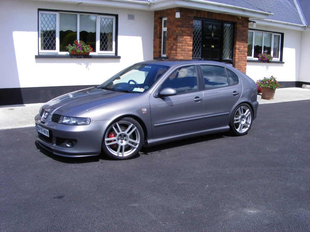

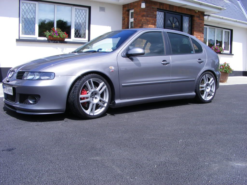

Got the car back today with APs fitted and will post a few piccies later, once i've got her on a flat surface (drive is a bit up and down).
I asked the guy to fit them at their highest setting, but this morning he said he just put them on as they came out of the box. Any ideas how much lower that might be, just to give me an idea? I'll then think about adjusting them in a couple of weeks once they've settled.
HHHMMM, bit concerning that aint it??
Did he even check they were all at the same height.
Do you have an equal drop all round?
Did you measure the ride height before fitting these?
Mate, I'd adjust them straight away. It doesn't take long at all, just get the car on flat ground and measure the height of the wheel arches and adjust as required. If I remember correctly, doesn't one side require a different amount of adjusting than the other?
Quote:
Sorry, should have phrased that better! He did check and said they were all at the same height, but I didn't actually measure.

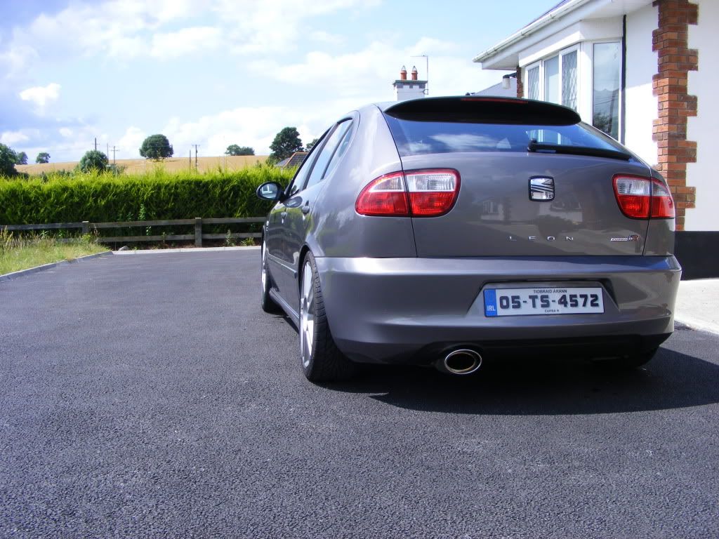

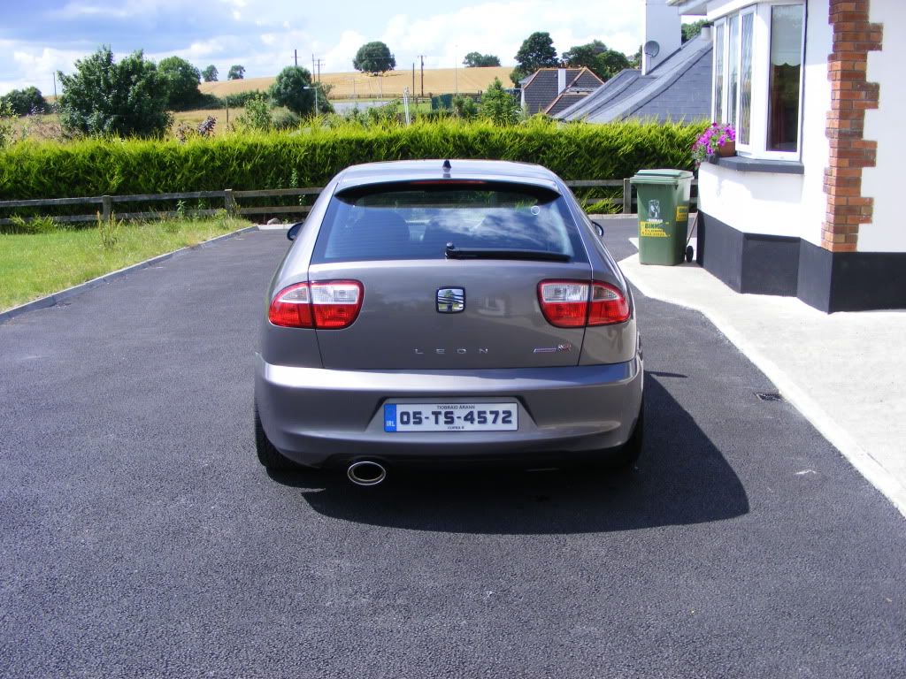

Before
After
So to double check, all four arch heights should be the same then?
My drivers side is vastly differently adjusted to the passengers side to give a level 25mm drop all round.
The Leon is higher on the passengers side due to it being designed as a LHD car.
Make sure you measure front the inner of the arch to the centre of the alloy, not the ground as tyre pressure differentcies will mess up your figures
Cheers. I'll give it a go in the next couple of days.

Took some pics of my LCR lowered, i also added 10mm spacers on the rear and a rear ARB.
Gonna move the 10mm spacers to the front and put 15mm on the back to finish the look off
Not sure how much i lowered her by either, just went with what looked right, may even drop her a small bit more.
