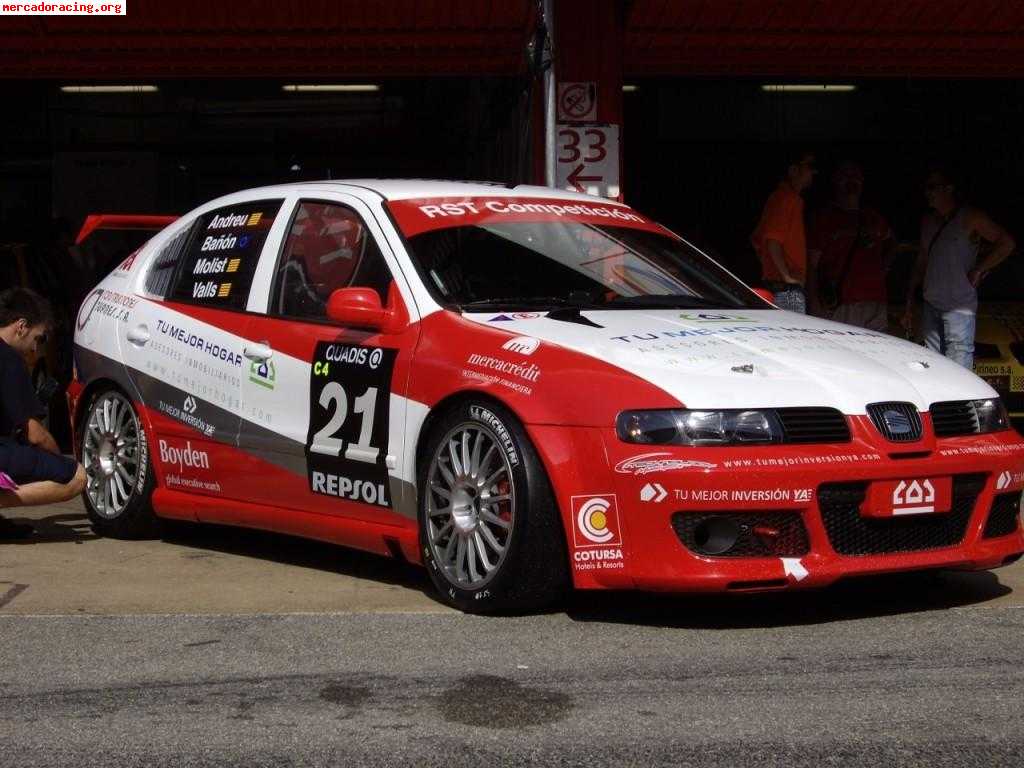

I think all the pics I have seen of the wide are have the line visable not blended and it looks good
lie this you can see the Line clearly
MMmmmmmm tasty, yeh the original supercopa's used a three peice front bumper, liking the little cut outs in the lower part, i'm guessing for brake ducts.
Sure it'll still look good with the joins in :D
