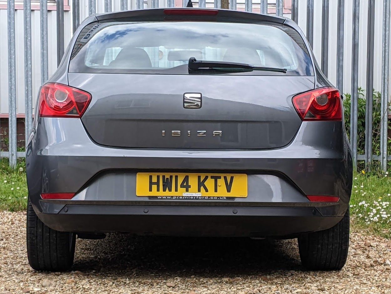

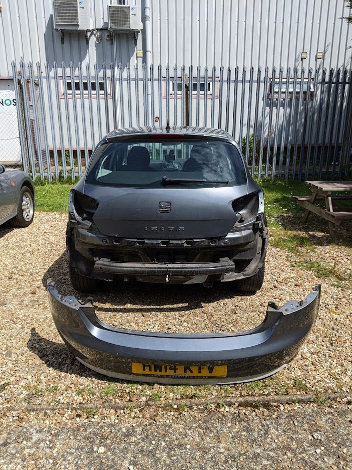

Awesome guide.
Finally got around to installing some parking sensor. The guide worked a treat!
Thanks again.
