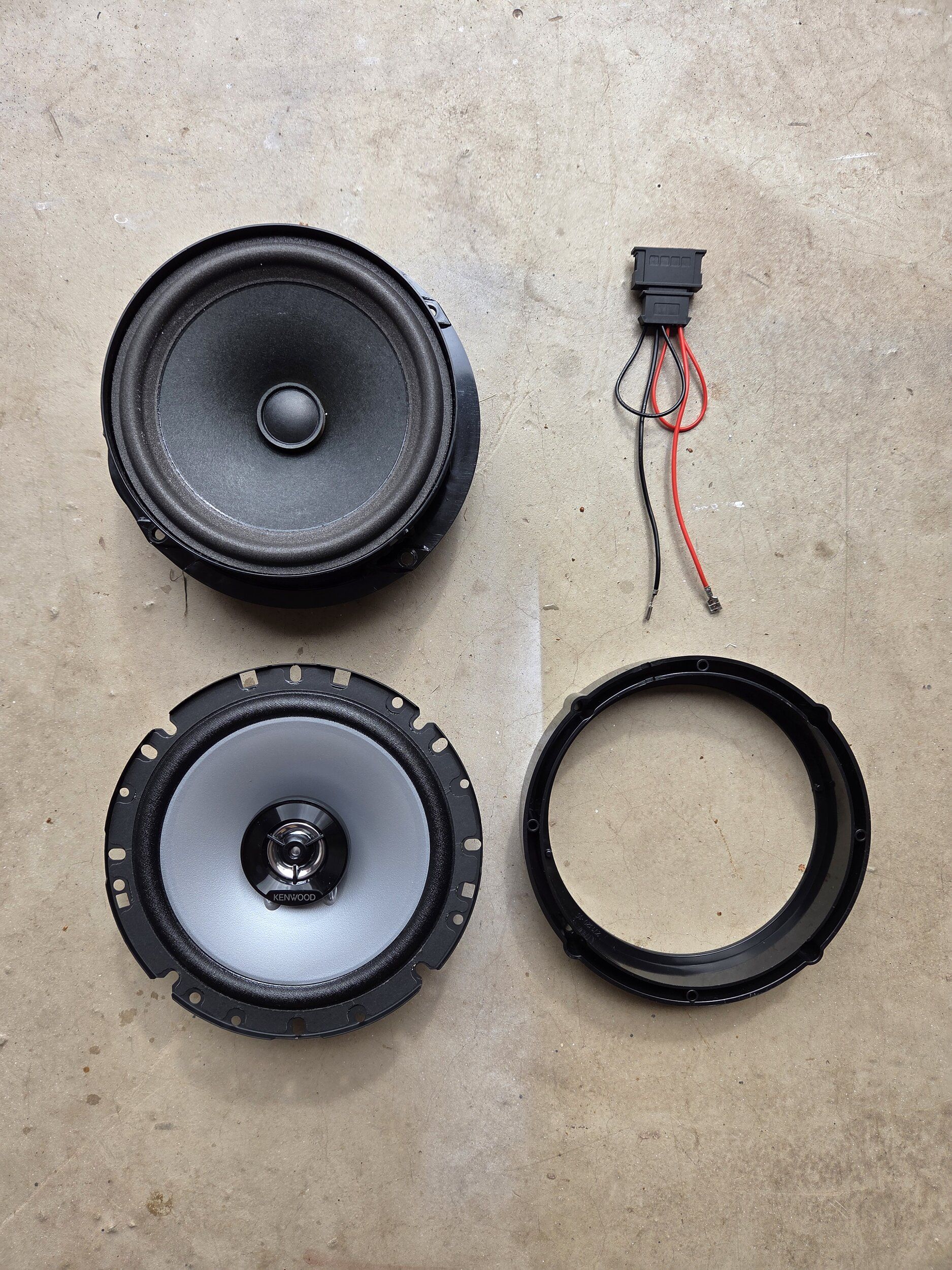

Fiting new Rear Speakers - How to fit new rear speakers to a Cupra Raval.
This how to guide is for the removal of the rear speakers in the Cupra Raval but the front doors are similar too. You will require plastic trim removal tools, T27 Torx screwdriver, a drill and metal drillbits along with adaptor ring and I recommend car sealant to bond the adaptor ring to the door. Speakers are standard 17.5 or 6.5 inch OEM are full range and I swapped for two speakers opting for a pair of Kenwood KFS S1766 2 way speakers.
The first thing...
