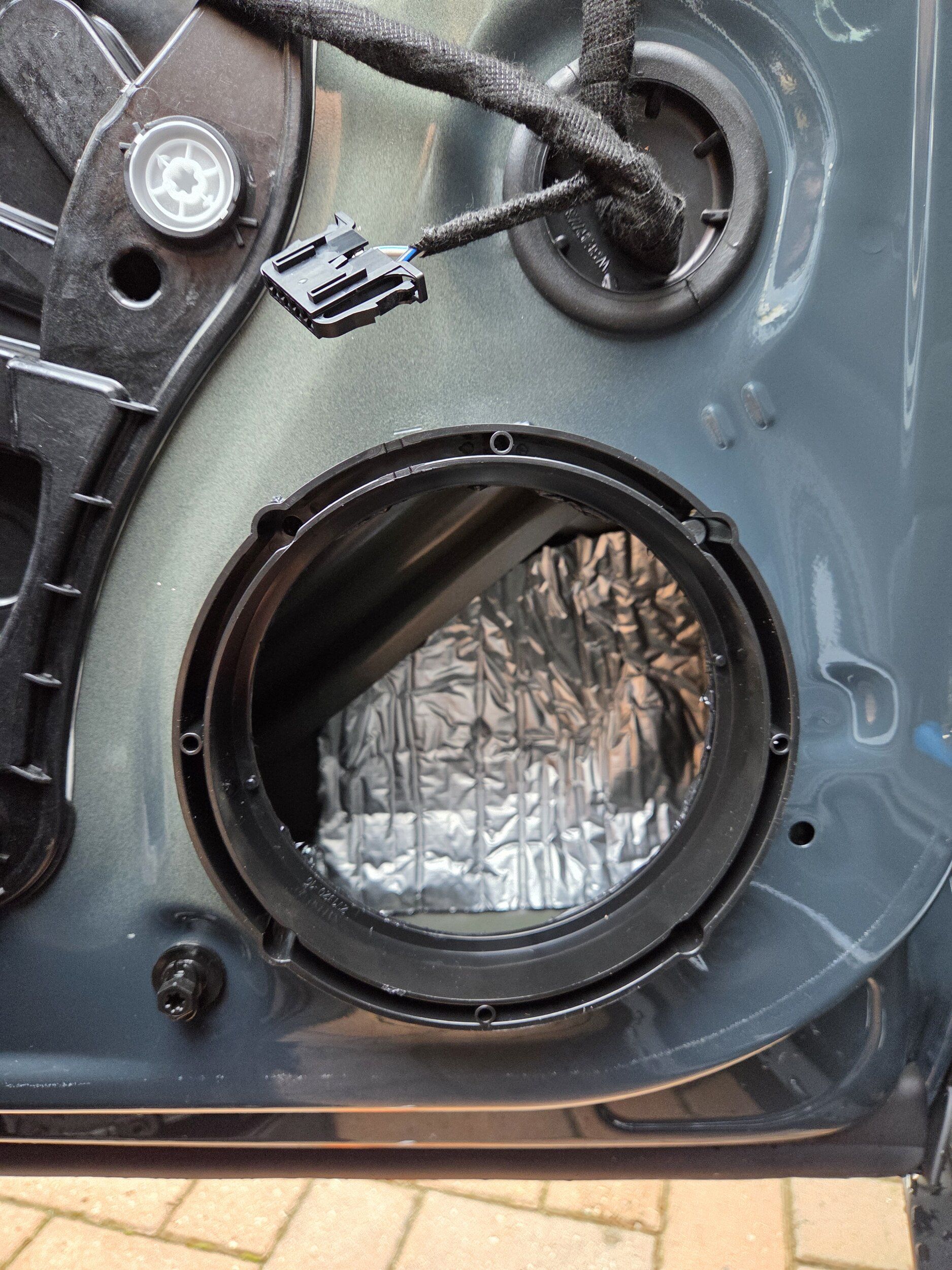

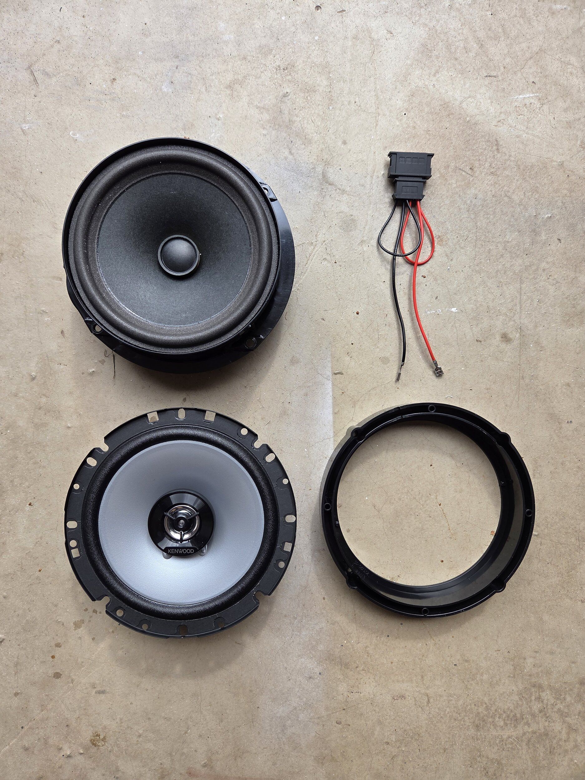

I have made a couple of small Mods to my Raval first was fitting new rear 6.5" Kenwood KFC-S1766 2 way speakers and the second covering the side console trim that is hard scratchy black plastic on Orgin and V1 with dark grey faux Alcantara.
Replacement speakers v OEM and adaptor ring and wiring adaptor:
Adaptor ring fitted, sound deadening added behind speaker as well. I bonded adaptor ring on using automotive sealant to prevent chances of a rattle with screws:
Has improved the bass and overall clarrity being full range speakers, although the OEM speakers are not bad at all.

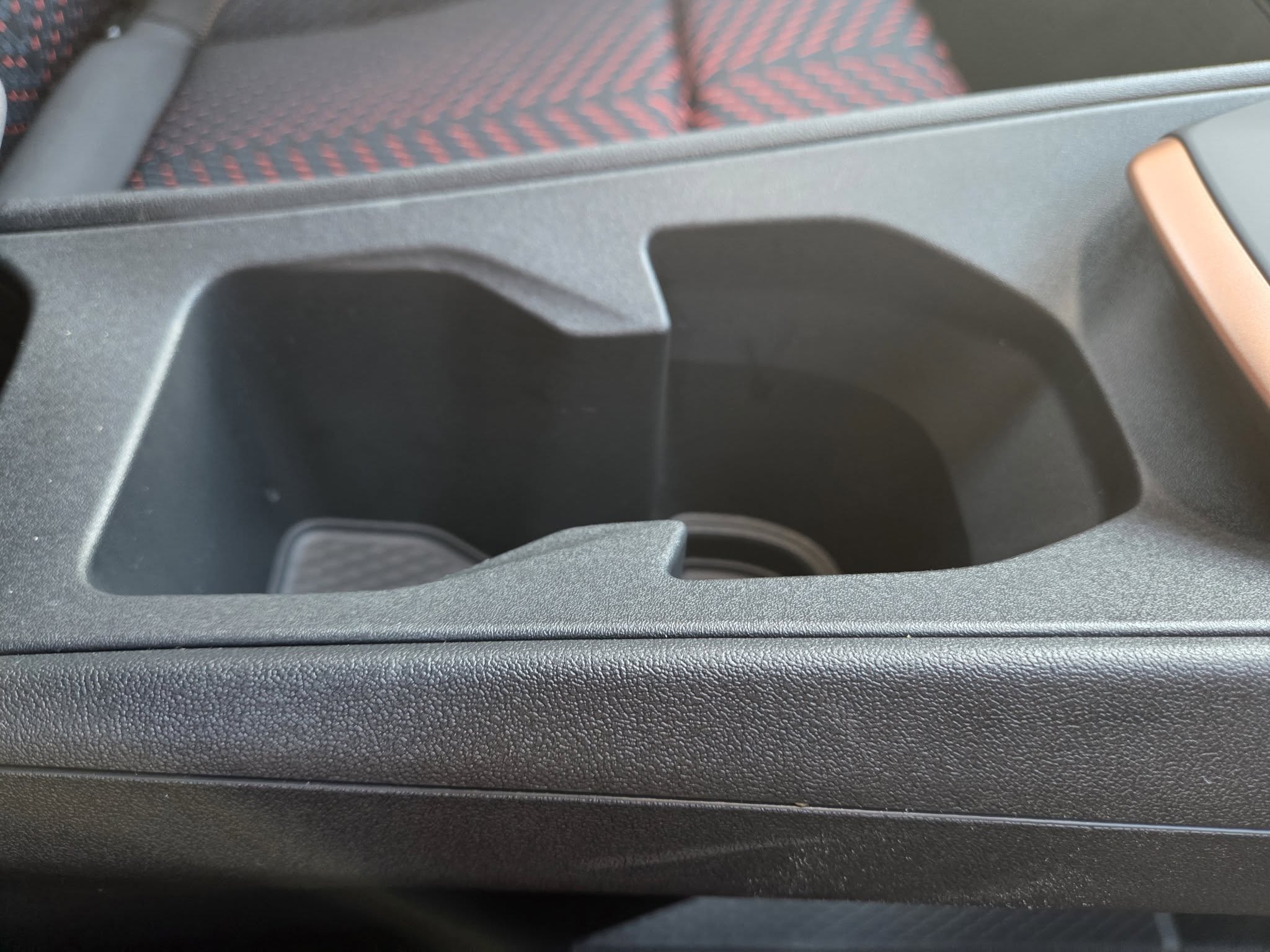

Second mod was wrapping the centre console trims in faux Alcantara chose a colour similar to the hard painted trim found in the V2 Launch Edition, V2 and VZ.
Before
After

Speakers did it have the top of the range speakers or the lesser ones... I'd have to check the spec. I was impressed with the top of the range immersive sound system in the demo Raval I sat in. I wouldn't have changed those but probably lesser ones.

These were the standard speakers I know the Sennheiser setup has upgraded tweeters not sure about the mid range. Not being PCH this time I thought I had to get back into doing some mods again. Just the MEB is an interesting platform as all the door clips are different to the MQB and that you think you have fitted them incorrectly as don't sit flush but they are designed to be floating to reduce noise. Will add into my how to guide as was a bit of a learning journey as was having to drill out pot rivets on the OEM speakers.
Yes I haven't been brave enough to take the doors apart in the Ateca. Old days they didnt need that to get at the speakers. You'd take the cllip cover off and there was the speaker held by screws.
The Sennheiser set up with the immersive sound processor will be all nicely balanced by design so if you started whipping out the speakers in that it would mess the sound up. In the past I've mentioned my home Sony surround sound system. In that you can mix and match speakers. You tell it the size. With a connected microphone placed in the centre it then auto tunes the volume of the speakers again what it's hearing against the acoustics of the room - pings test tones to each speaker. You can then adjust what it comes up with. I leave as is. Other home surround AV amplifiers will do the same.

Same as the rear 17 cm or 6.5 inch just slightly different adaptor rings same as Born, ID3 and ID4. All from the MEB parts bin.
So the question is atleast for me is whether the deluxe Sennheiser system gets the same make as the non deluxe system or not. Whether the speakers are the same make but the fancy option just gets more speakers but different sizes in different places plus the fancy sound processing to match.
Those are quite large speakers from my days of putting speakers in cars.
I know the tweeters are upgraded but I think the full range units are the same as you have the subwoofer in the rear and the rest is down to DSP. To be fair the full range units are not bad at all and have a decent magnet on them. Certainly not your cheap Amstrad, Goodmans or Bush type speakers from back in the day...

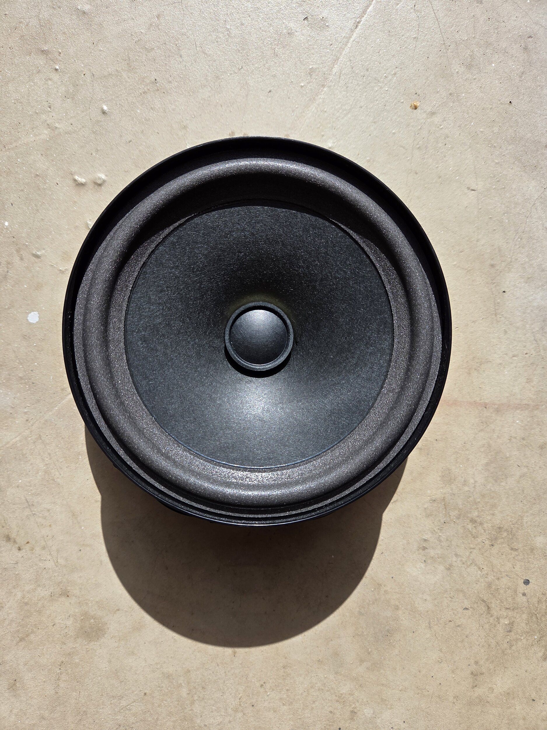

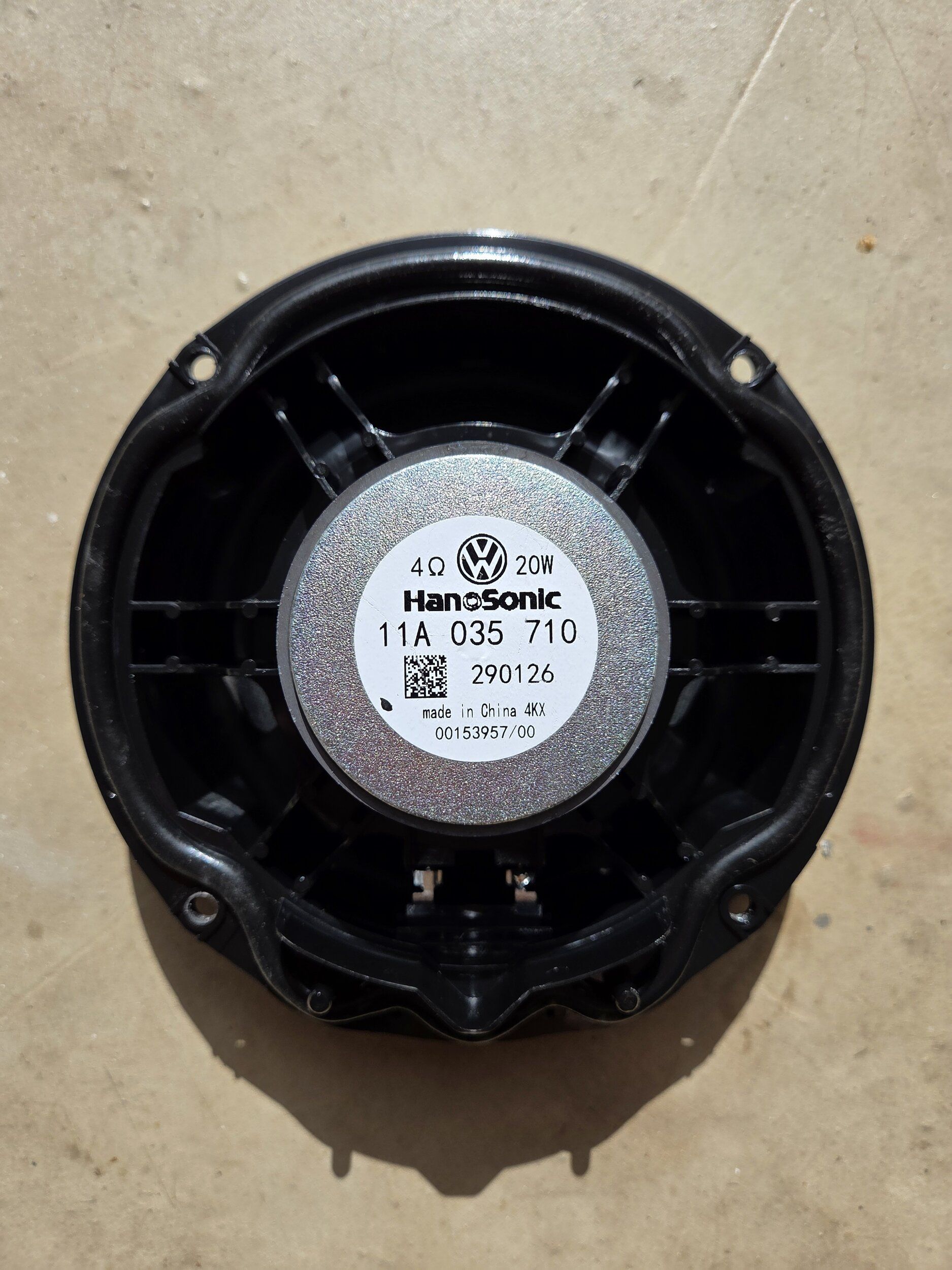

Found this one and a video where a top of the range B&O system, speaker taken out and revealed Han Sonic VW
What they were talking about

Actually looking at your top picture at the front for comparison, the Han Sonic look a bit like "paper speakers". It's what that diafram is made out of, whether it's resin or paper.

Yes paper cone with a foam surround, the Raval is the same drive unit in the front as that video as are the standard front speakers found in Born, ID3, ID3/5 and Raval. Still much cheaper drive units if I compare to my Q Acoustics 310i in my office ot Cyrus Ones in the front room. But a car even with DSP is never going to be true hi-fi environment being the single biggest limitation.
