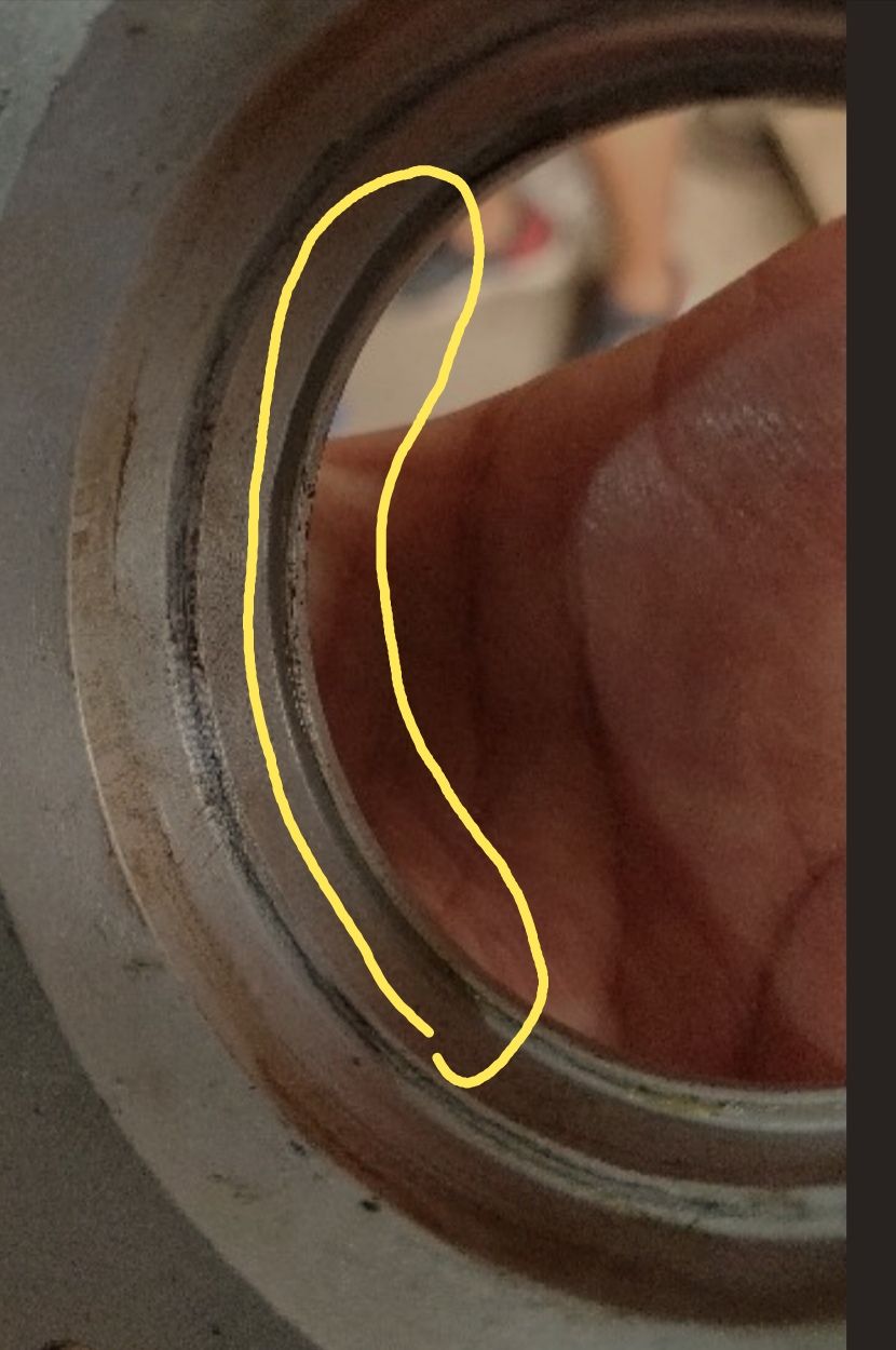

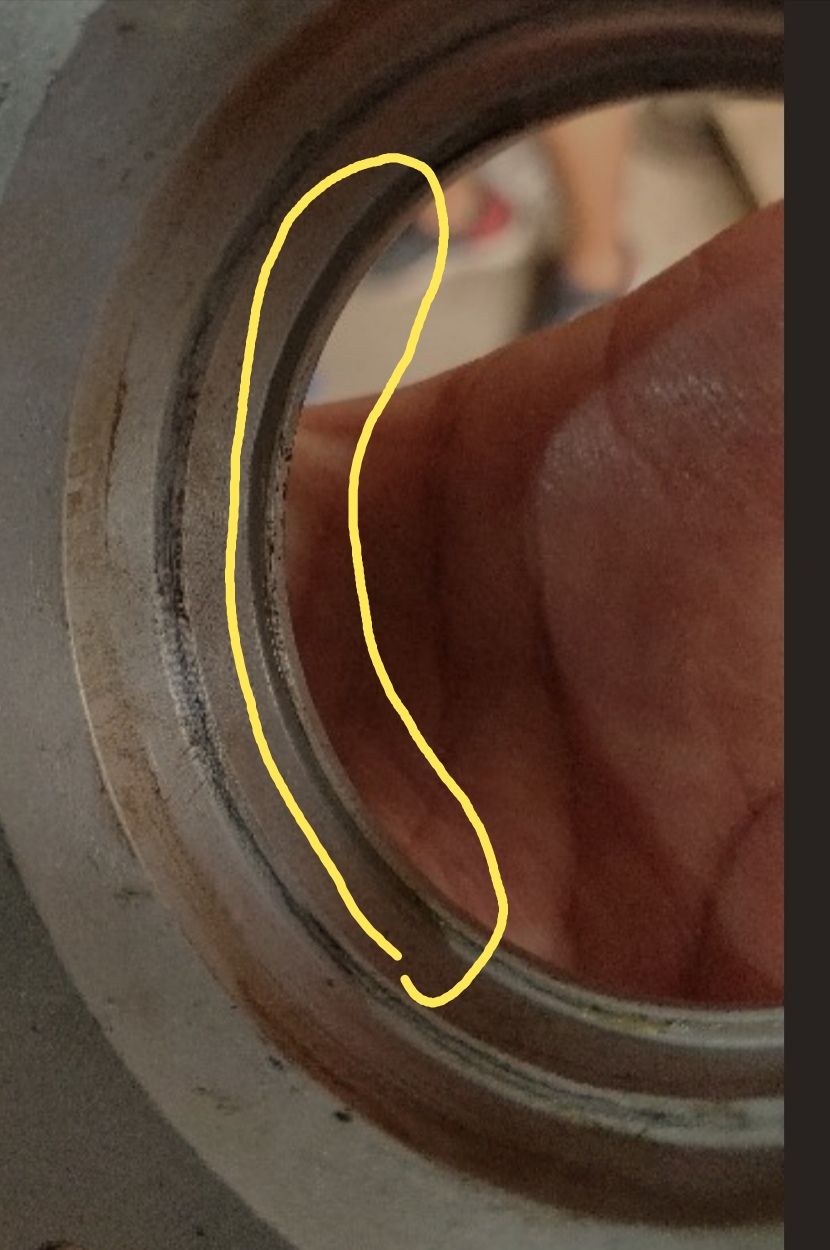

It looks like this ridge is catching the existing centering flange:
You'd need to machine this small lip off.
Those were my initial thoughts too. But I believe if the dust cap would go off as @marlop suggested then it should slide right in. My question here, would machining it upset the balance or spacer structure somehow? I'm afraid of vibrations or even worse if it snaps or something.

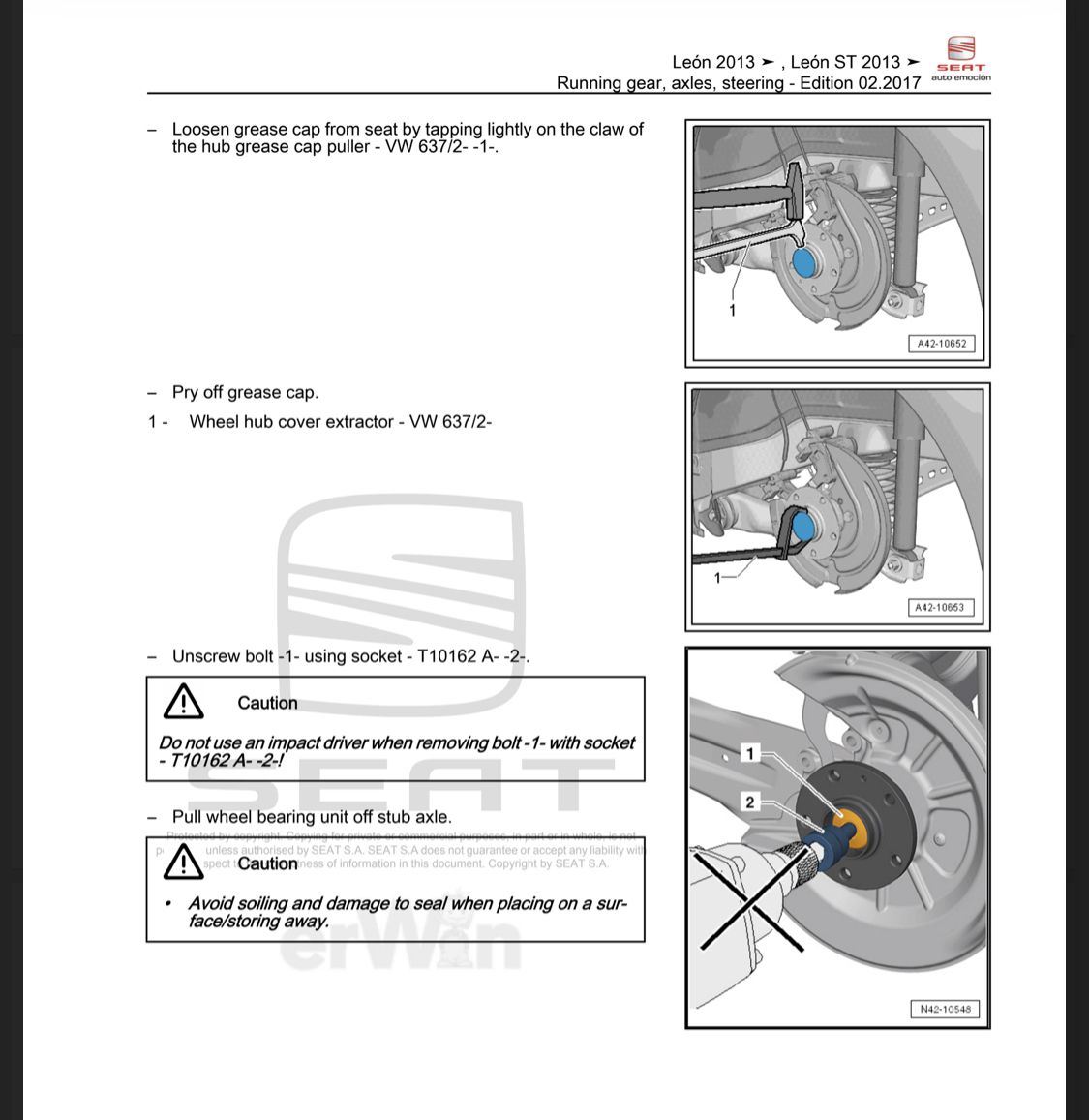

I've never worked on a hub before. How is the cap removed? Do I just pry it off or is there some sort of process to remove it?
Workshop manuals are here:
You’ll want the suspension, axles, running gear document.
Need to remove the brake disk to remove the grease cap like this:
Looks simple enough... Thanks mate! I'll give it a try now and will let you guys know how it goes.
So, removing the dust cap did work, however, I couldnt put it back on the spacer. The inner diameter is just too small. I decided to go ahead and machine it to fit but I ended up ruining it :) i got a hairline crack now between the lip and the actual spacer.
