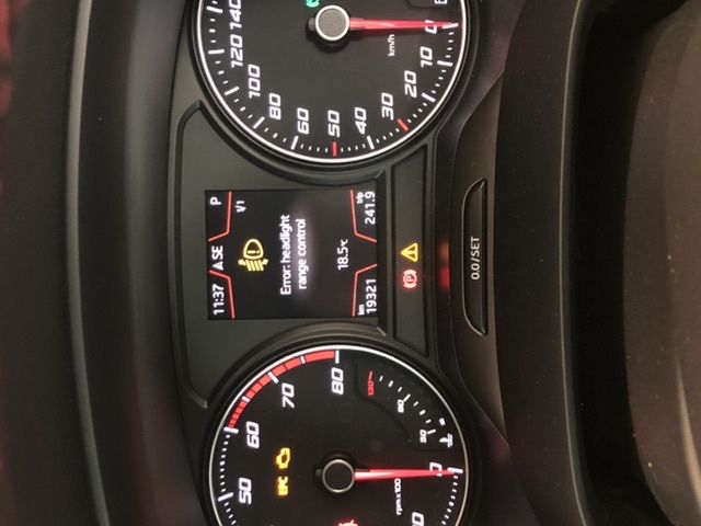

Hello guys. Does anyone else had the same issue? Do you know how can I fix it? My car is a Seat Leon FR

Do the headlights raise and lower when ignition on initially and lights set to auto - guessing the adjustment motors have an issue check connections on back of lights and if they move when first come on
