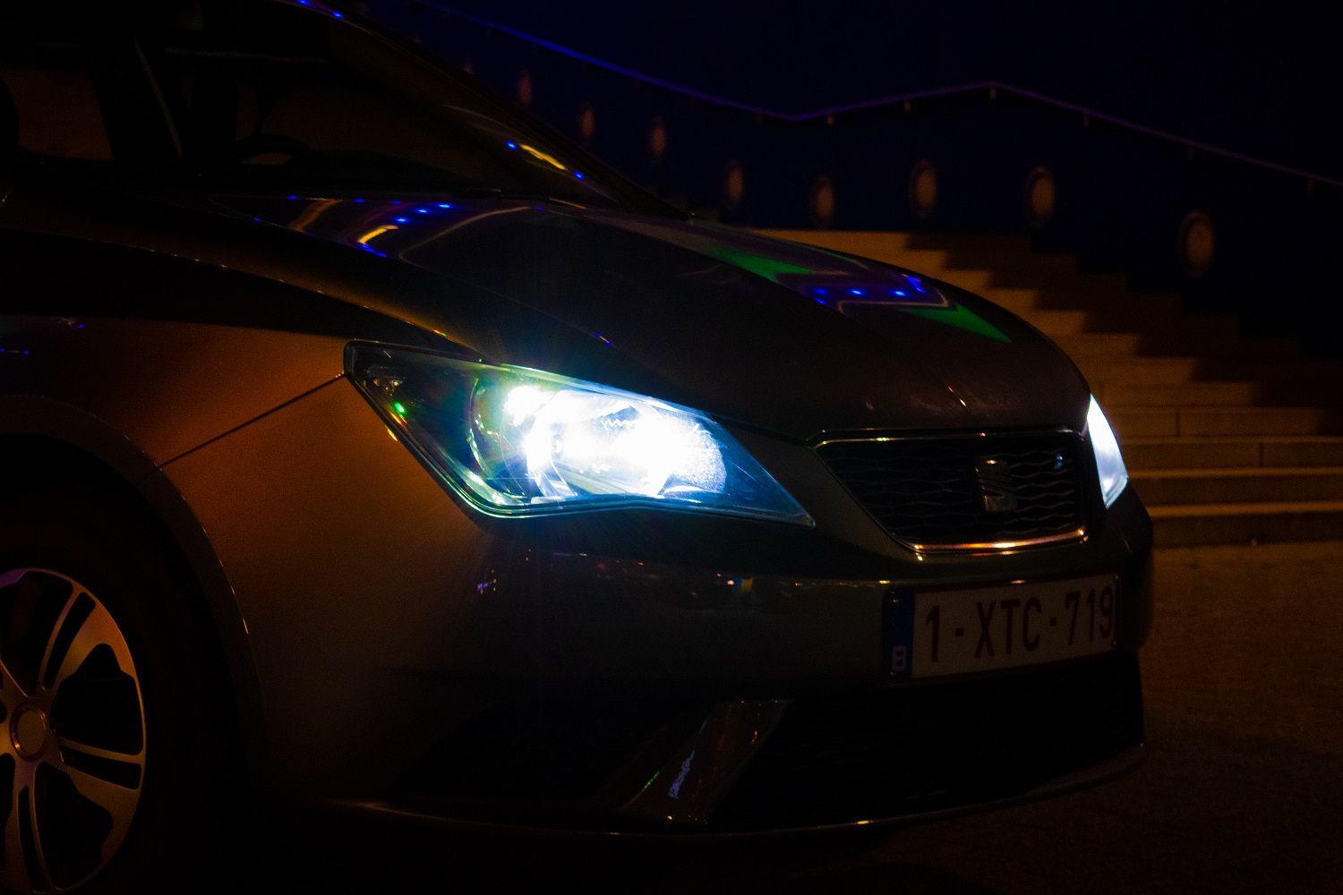

Hellohello,
I just got my first car, and im pretty excited about it. I was able to get it for a really good price, so it's not without its faults. One of them being, the headlight issue.
On 0, the low beams are on. Turning the switch to side lights, turns the low beams off and turns on the interior lights. Switching to low beam, the low beams come back on, this time with the interior lights still on. It would seem the side light and low beam modes work just fine, but the 0 switch position is bust. I'm thinking a faulty switch, but would like your input. The car does not have automatic lights.
Yours truly
There is a setting in vcds to enable this function. You can either choose sidelights or low beam (and maybe fog lights) as DRLs.
It seems as though both the side lights and low beam are programmed as DRLs, is this possible? I think the rear lights also light up on 0 btw. But as the interior lights do go off, can I exclude the possibility of a faulty switch? The light warning sound when turning the ignition off also cuts out when turning it back to 0. It's a very confusing situation all around, makes sense this is a software thing as I don't see an electromechanical logic lol.
Most likely it was coded by the previous owner. The rears should also light up as you said. Do you have any scan tool ? Using carly or carista (you can find “free” versions online :cheeky:) you can check these settings

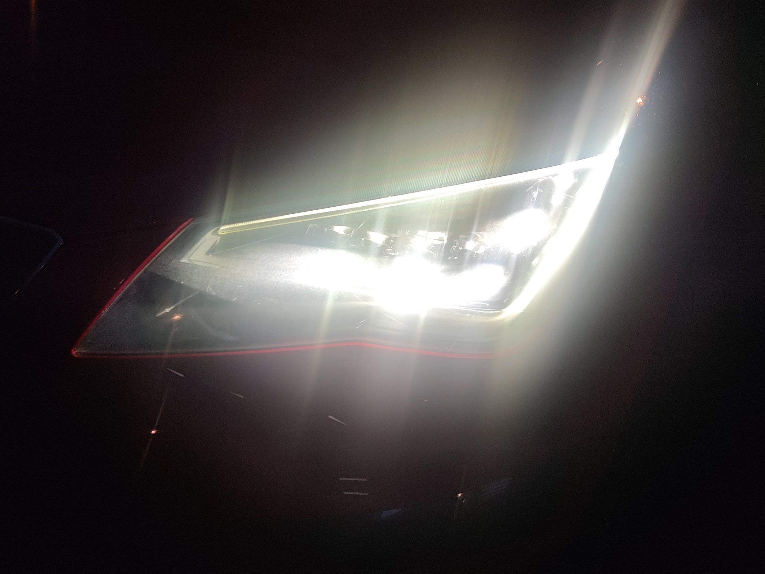

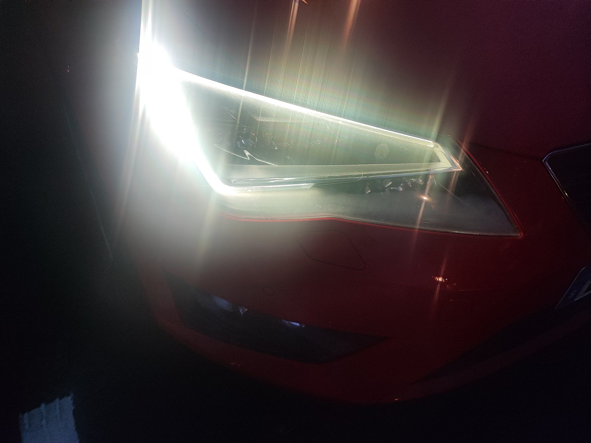

Hi everybody,
I need some help here ...
My position lights are a bit confused ...
The left side is with low beam on and the right side is as usual. As it should be.
Can anyone help me????
The picture with the low beam is the right side and the other one is the left side as it should be on. Please help me...
How do i remove the beam so it is original parking lights on with obdeleven?
