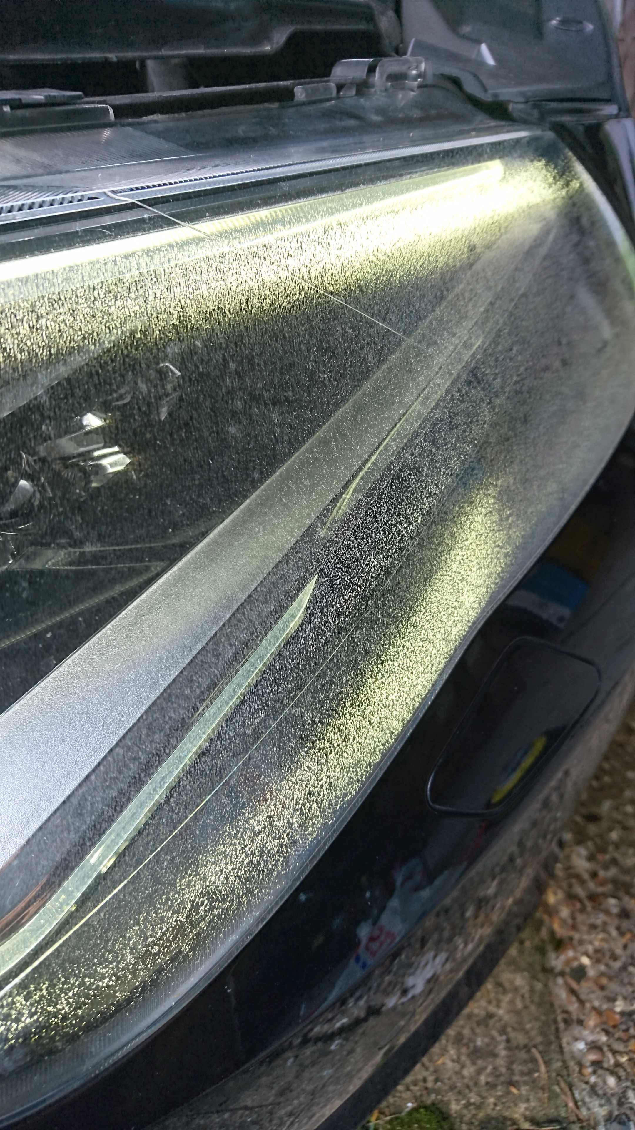

Just posting my example as I said I would. Not the best picture but I feel like it's the same issue as described above.

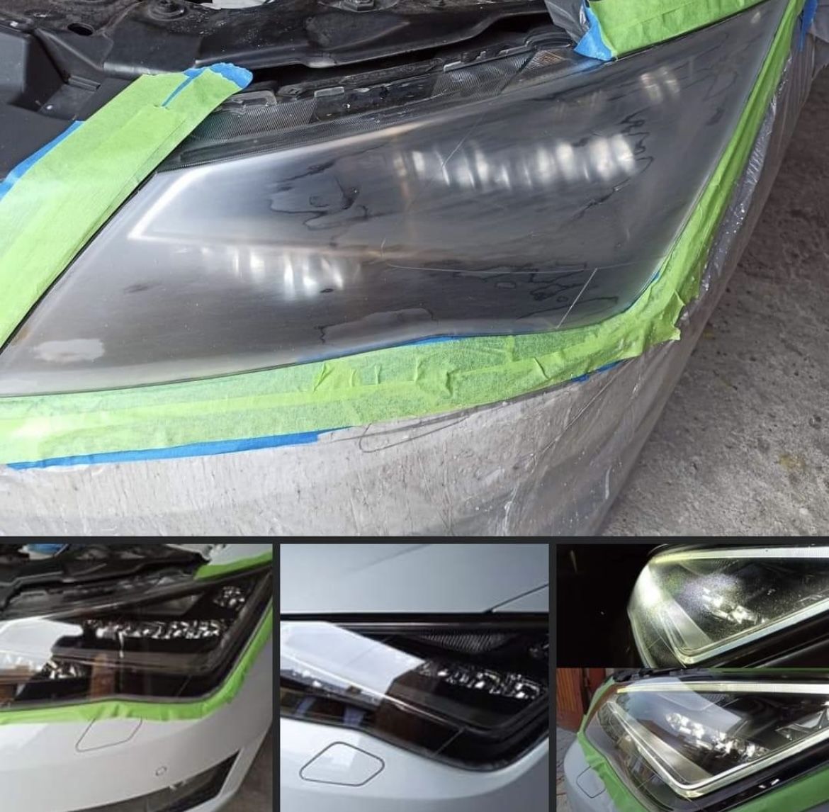

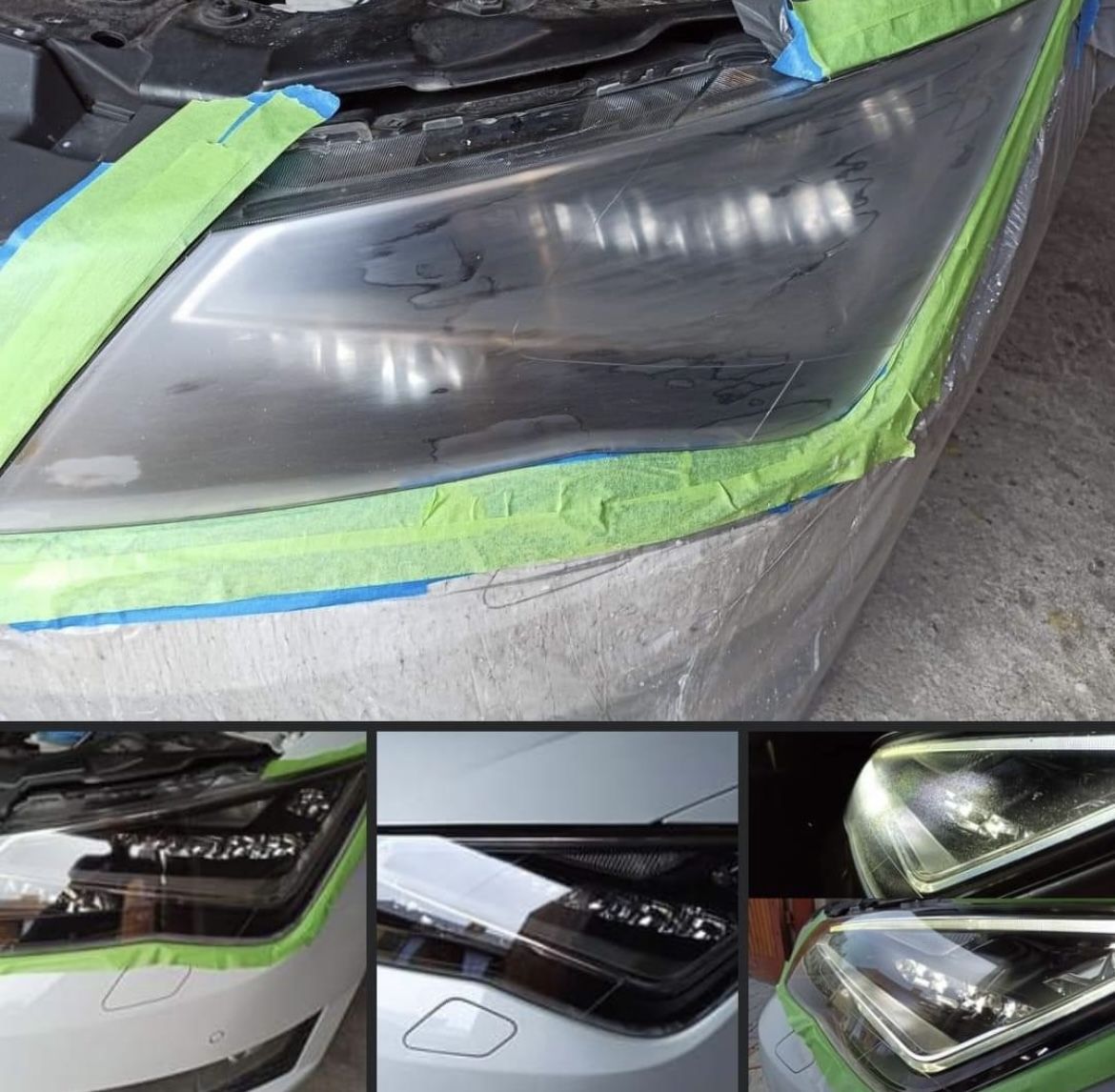

Are you guys sure it’a on the inside? I have the exact same issue and saw people on other groups just getting rid of the old clearcoat and applying a new one.
It’s not mine, borrowed from the other group. I’ll probably give it a try when it gets warmer in a few months. There’s plenty of videos on YouTube showing this. Just wanted to hop on and maybe resolve the issue for some people, cause I at first was also sure it’s all on the inside.
I see, thanks a lot anyways, I plan on giving it a go at some point aswell. I read somewhere, that it takes rougher sanding than one would think.
I tried it on one of my lights so far using various grit wet & dry attached to a drill. Took me the best part of 3 hours on one light. And it's largely worked a treat. I'd definitely take a bit more time stepping up between grits to ensure there are no scratches left behind.
I treated it with Meguiars Headlight Coating as I heard that's a good cheap coating that will stop this happening again. I also bought PPF film for the headlights from https://chronlakier.pl/ which I understand is a good UV protector of the headlights.
