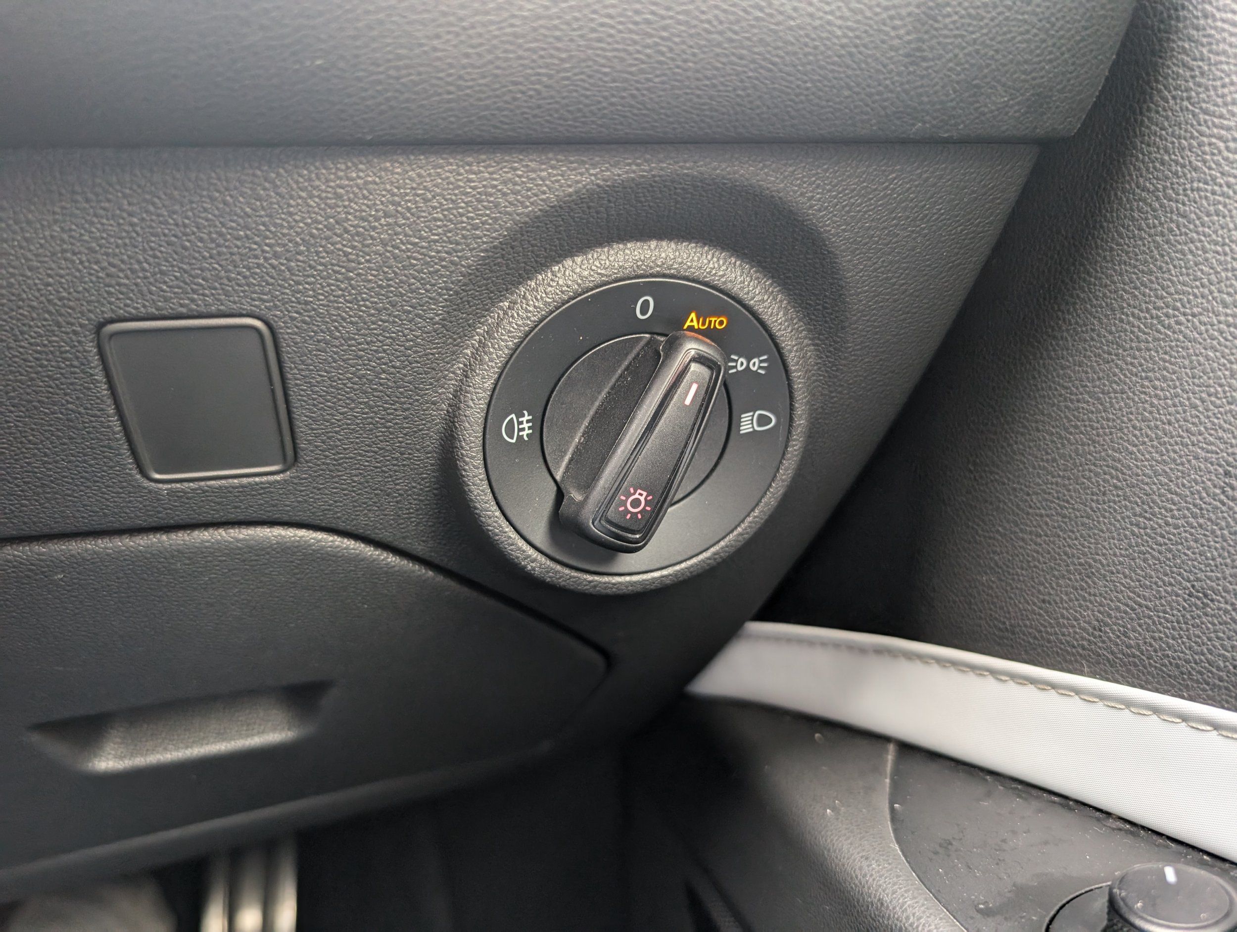

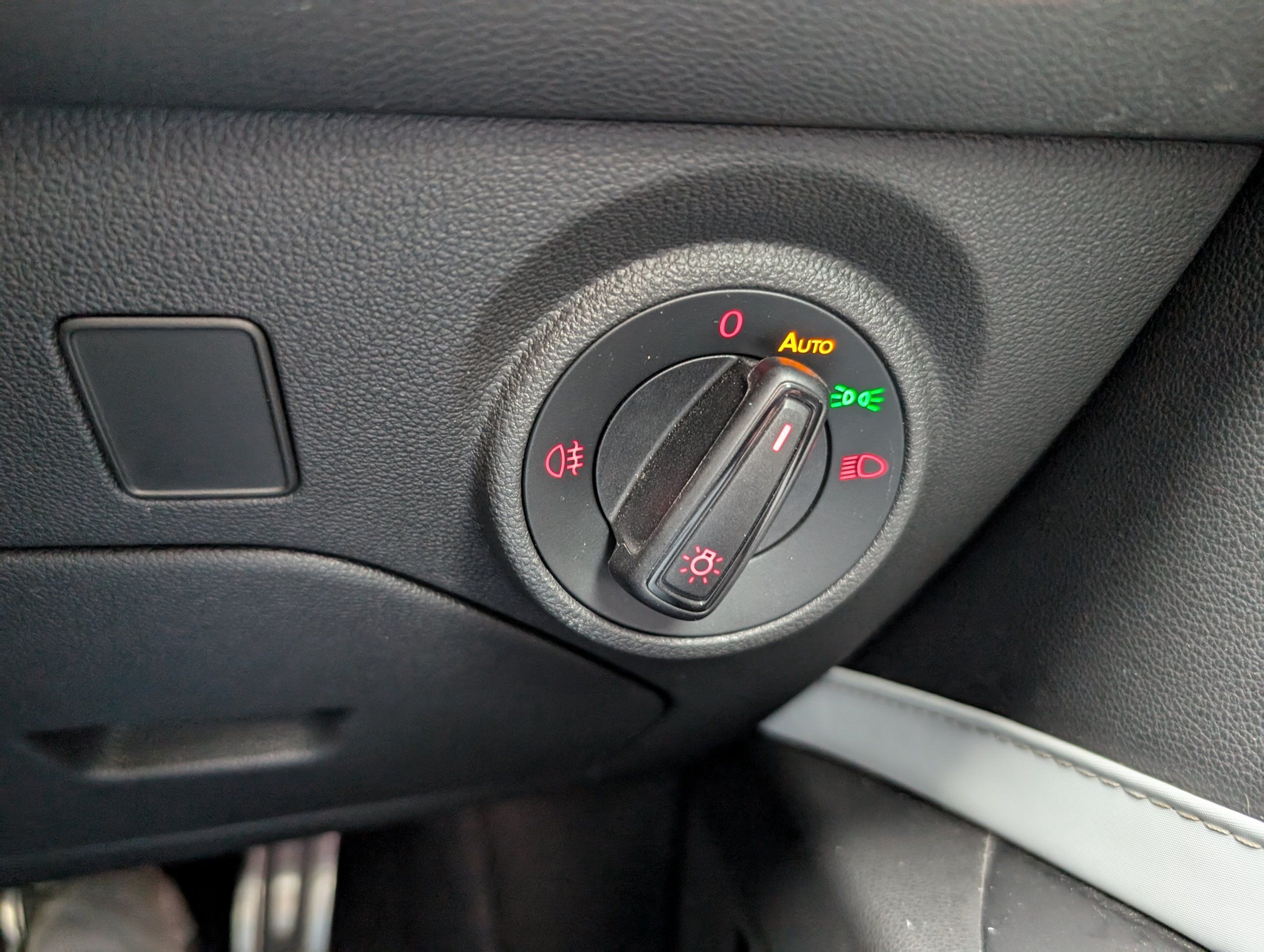

Following up on this, there is a super clear and easy way to know when the dipped beams come on when in "Auto" (excuse the state of my car, I've mangled my back so not been able to clean it for 2 weeks LOL)
Dipped beams off
Dipped beams on
This is during the day and as you can see, easily spotted.
As a long term bad back sufferer for many years, I hope yours gets better soon ?.
In the VW’s I’ve owned with auto headlamps, the buttons on the steering wheel and the heater controls also illuminate (in red), so it’s easy to spot when the lights are on during daylight hours - IMHO easier than having to look down to the rotary light switch which is lower down on the dashboard.
My current (non-VAG) car has a green headlamp symbol in the instrument display which IMHO is better ?.
Reactions: Craig.
Dipped beams off
Dipped beams on
You’re right, it’s easy to see.
While you are totally right, that part of the car is poorly illuminated even during the day, so that you can see the backlight on the icons easier than the controls on the wheel.Both are doable, the light selector has just more contrast.
The opel corsa i drove before getting the Leon had the green low beam indicator where all other indicators are. Much better indeed
Reactions: Craig.
Dipped beams off
Dipped beams on
Also, what does that little square rectangle do on the left side of the picture? I don’t think mine has it
