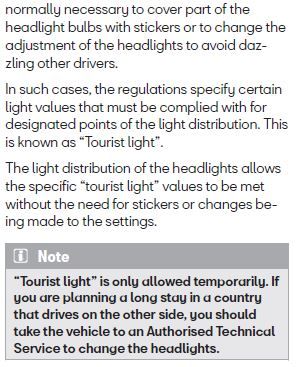

This is the updated (Fixed) manual that confirms the tourist function of the LED lights being the same as the Halogen. I've been told the same information from dealers about the LED lights being completely level, which is not true.
They are still asymmetrical in their beam pattern and this can be easily seen if you park your car up against a wall or garage.
