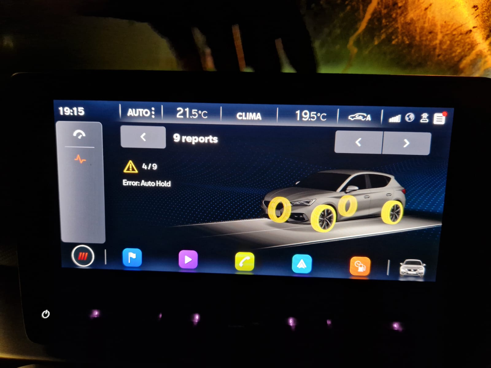

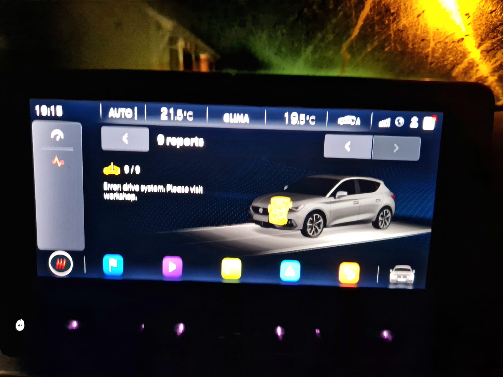

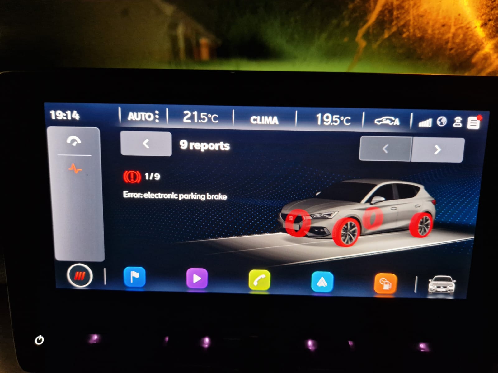

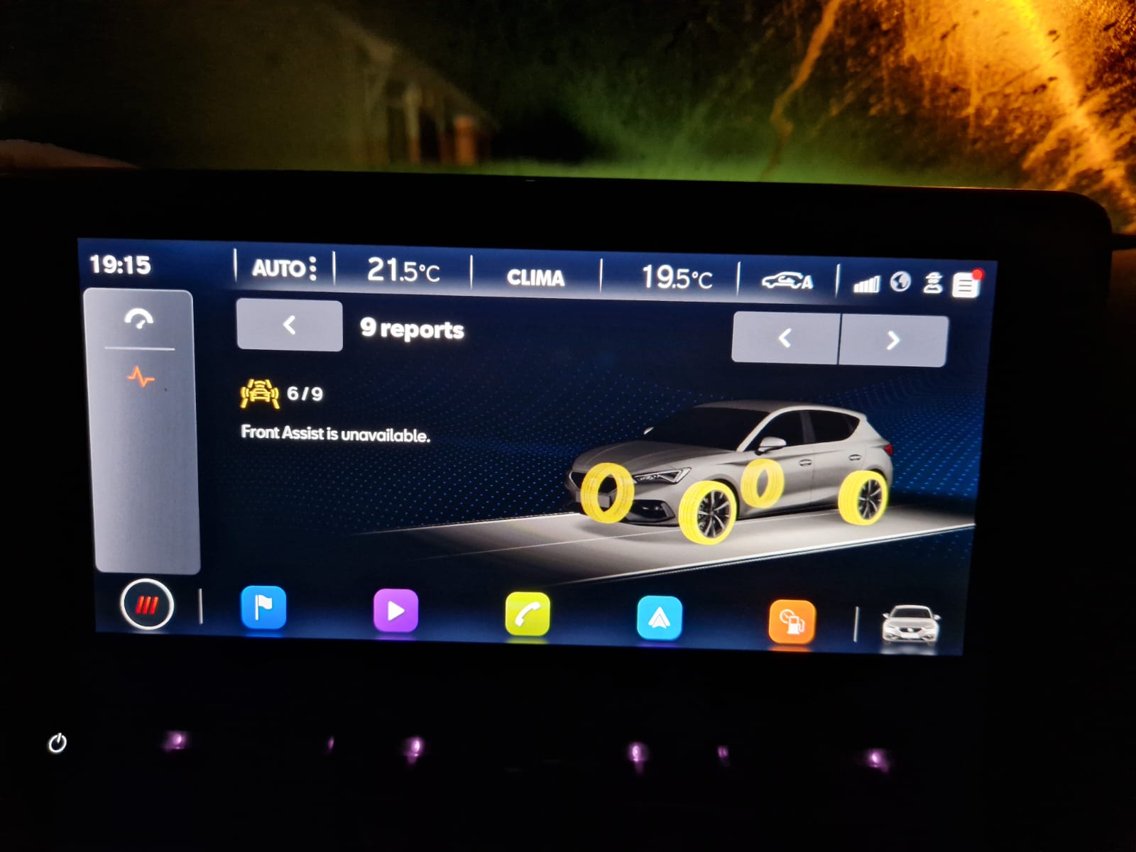

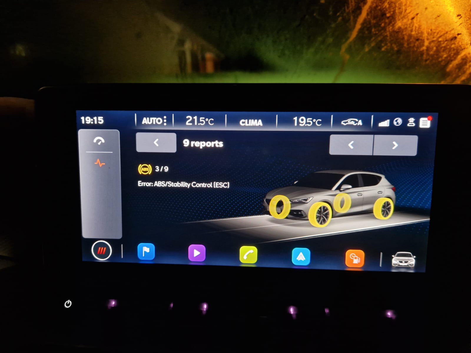

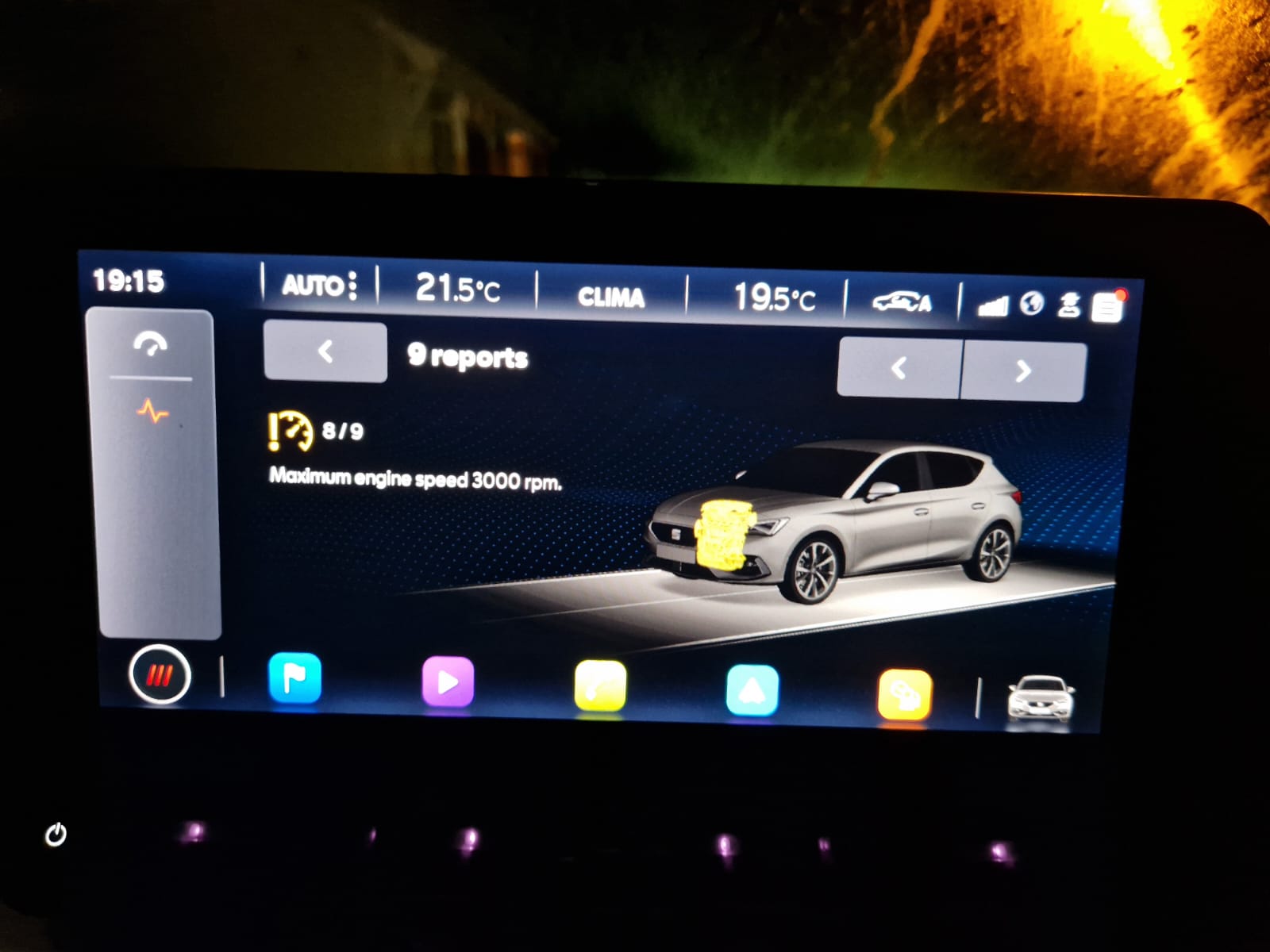

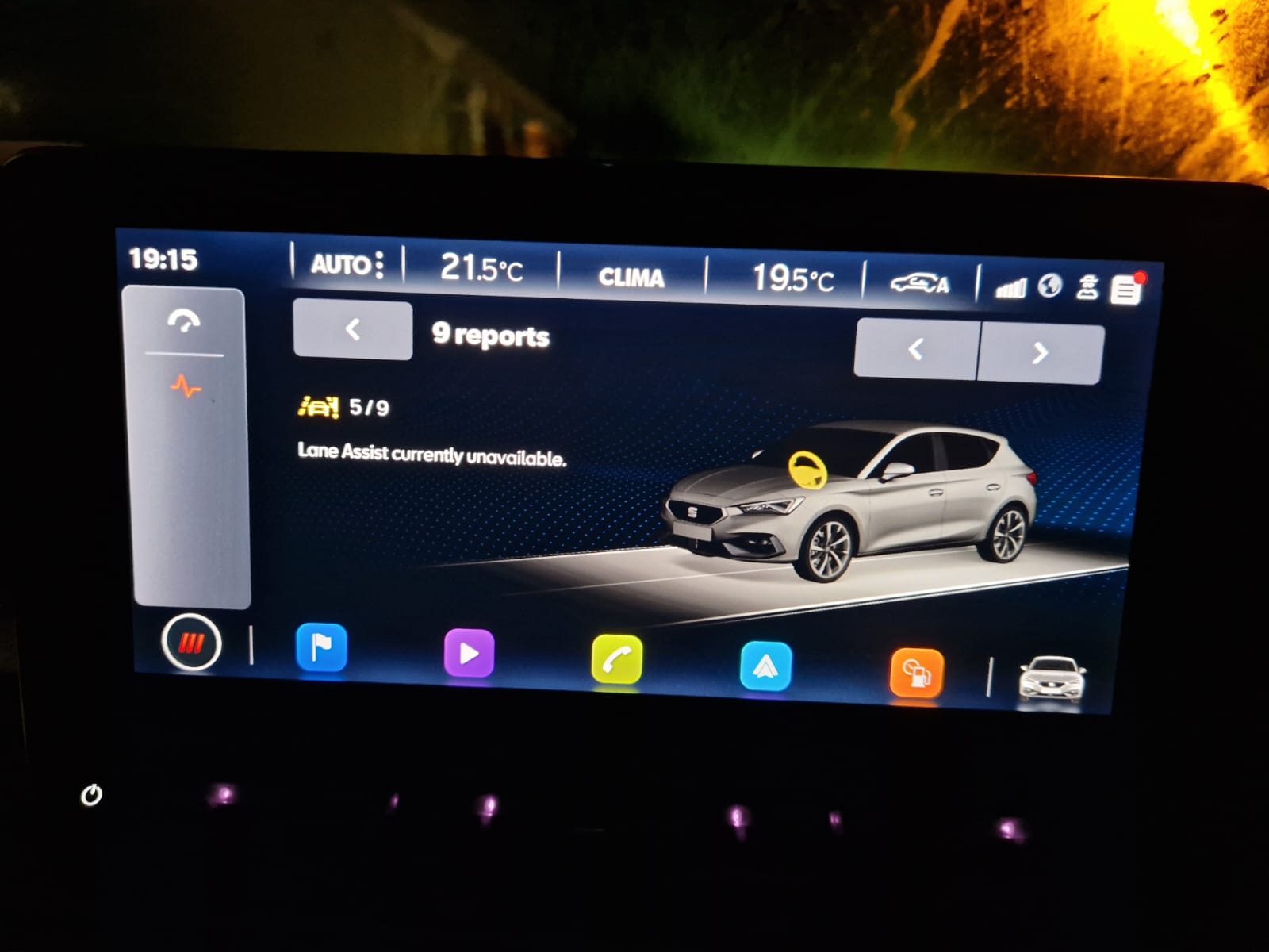

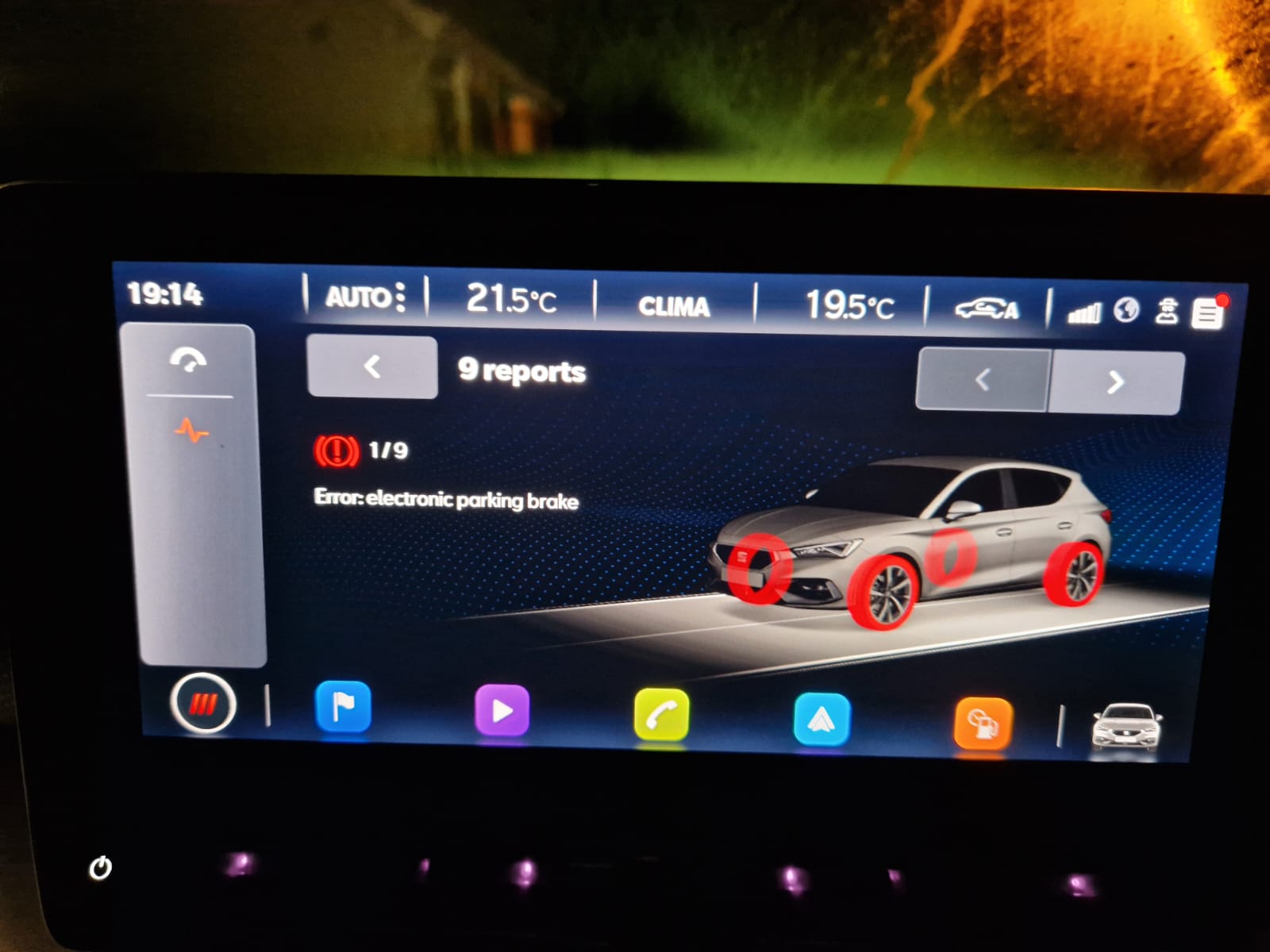

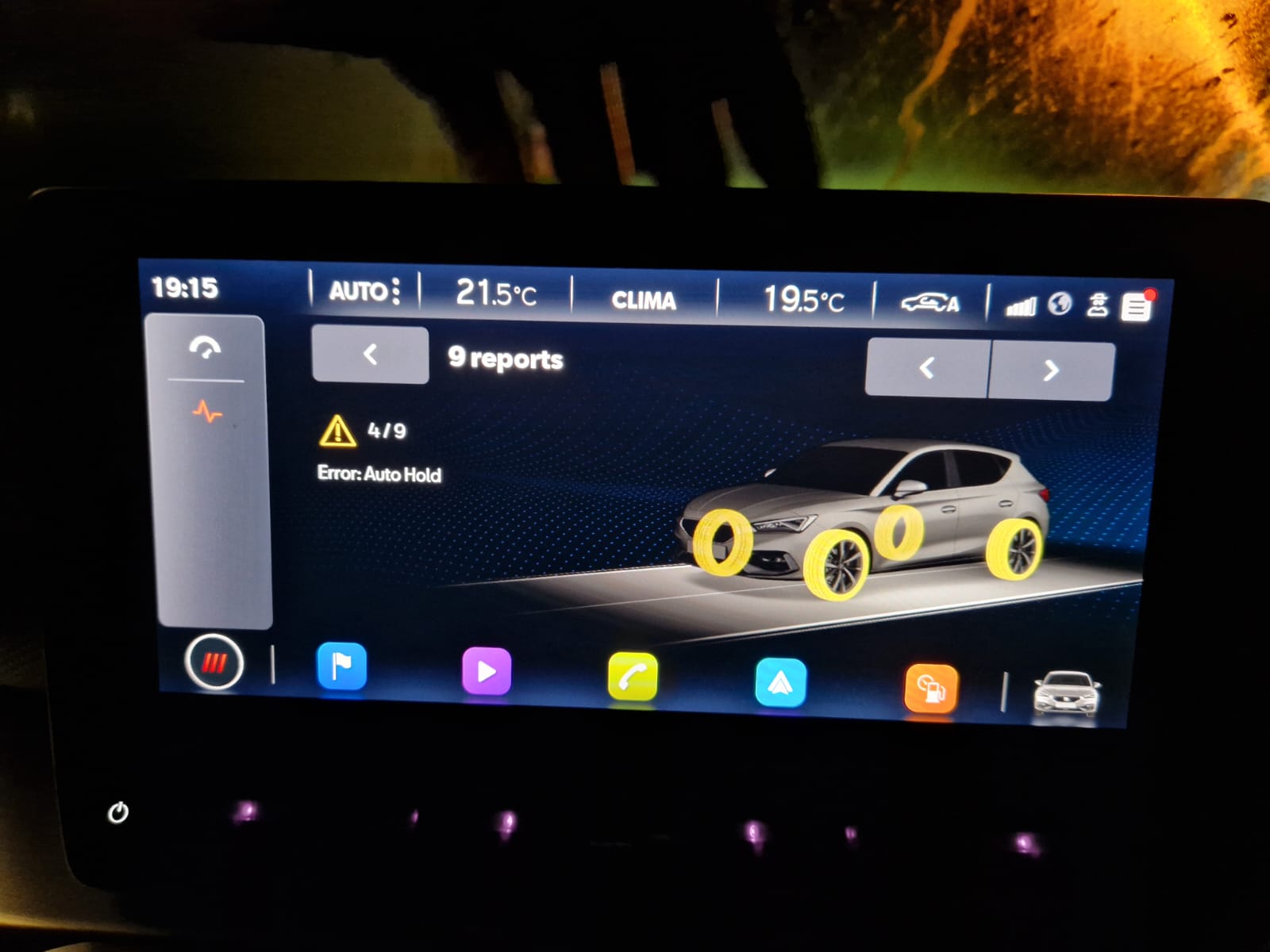

We've two Leon's in the family, and hers had been running fine. Last night it was driven a couple of miles to a family members birthday party*. On parking it was fine.
*It was a short trip, we didn't hit any potholes or have any other concerns or issues with the car
When we went to leave the dash lit up like a Christmas tree (see below)
The main problem is the electronic parking brake is locked on, so we cant move the damn thing to even take it to a garage.
With so many errors I'm guessing one of the (E)CUs has an issue?
I plugged an OBD reader in there now and got two codes -
Current Fault P062F - Internal Control Module EEPROM error
U0121 - Anti-Lock brake system control module no communication - though on turning the ignition off and on again this "cleared" itself
Is there a way to force reset the handbrake?
Any advice appreciated as the car is July 2020, so just out of warranty ?‍♂️

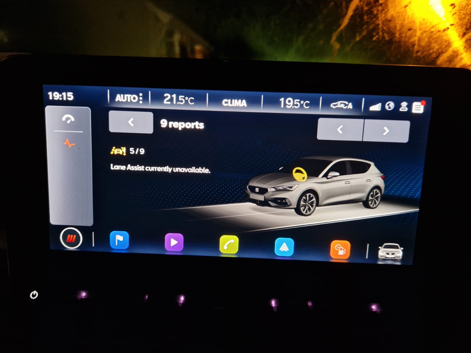

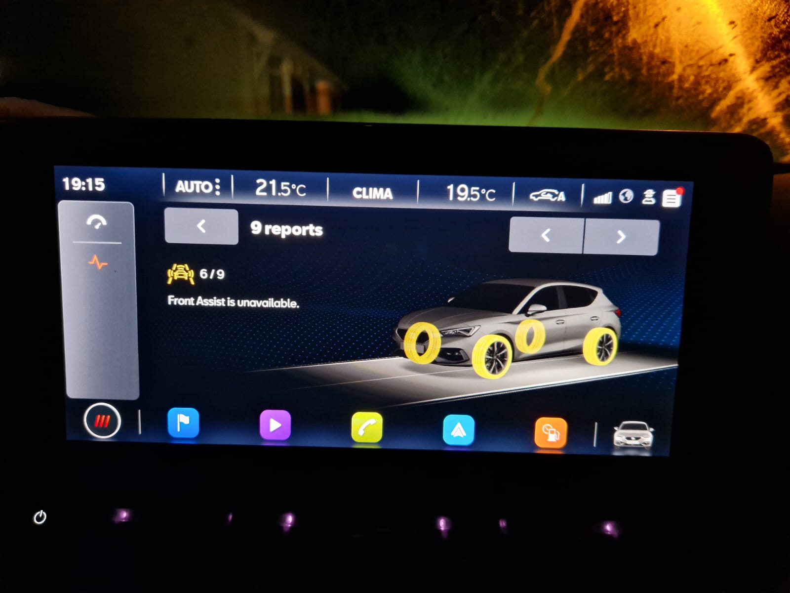

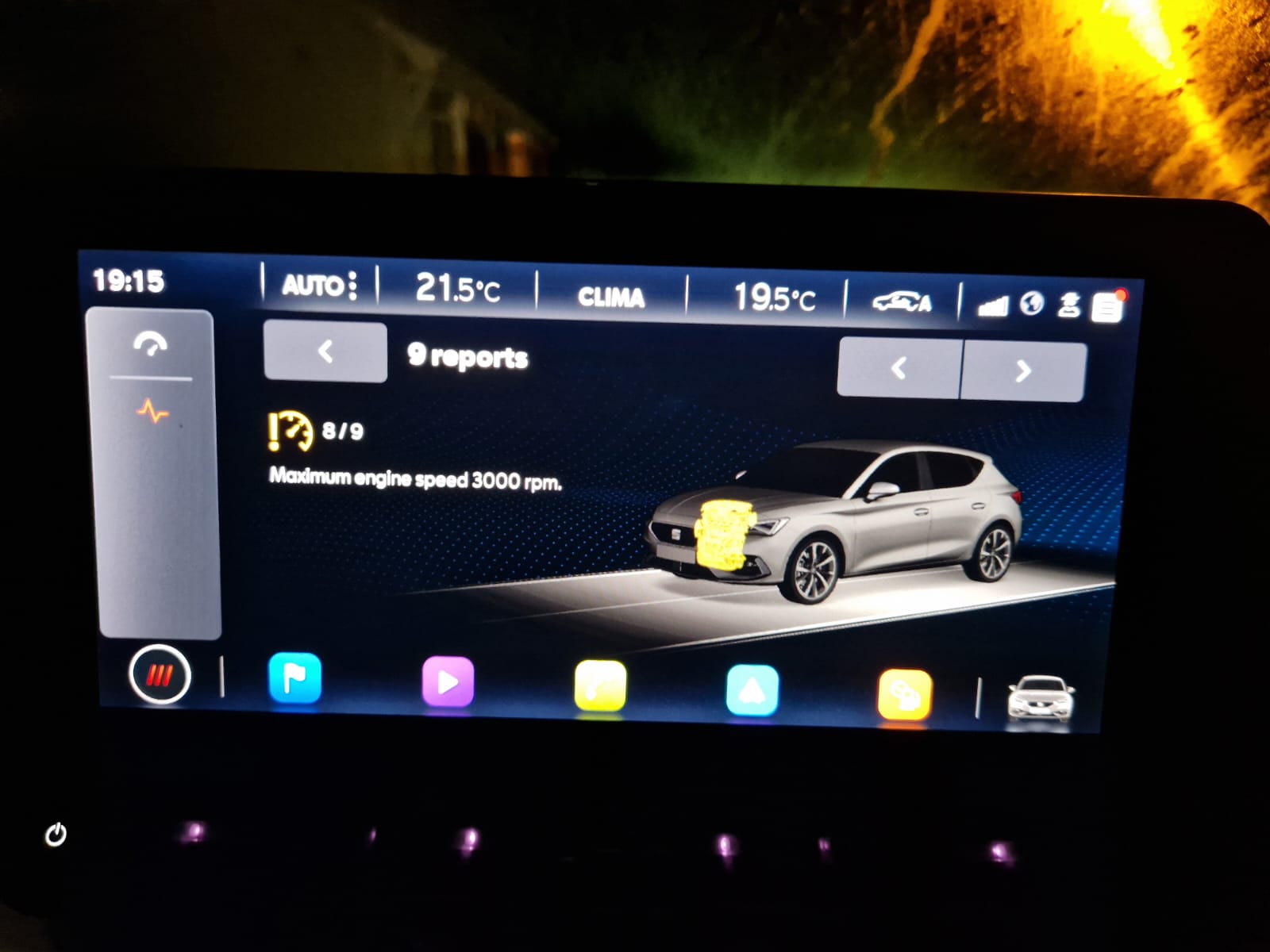

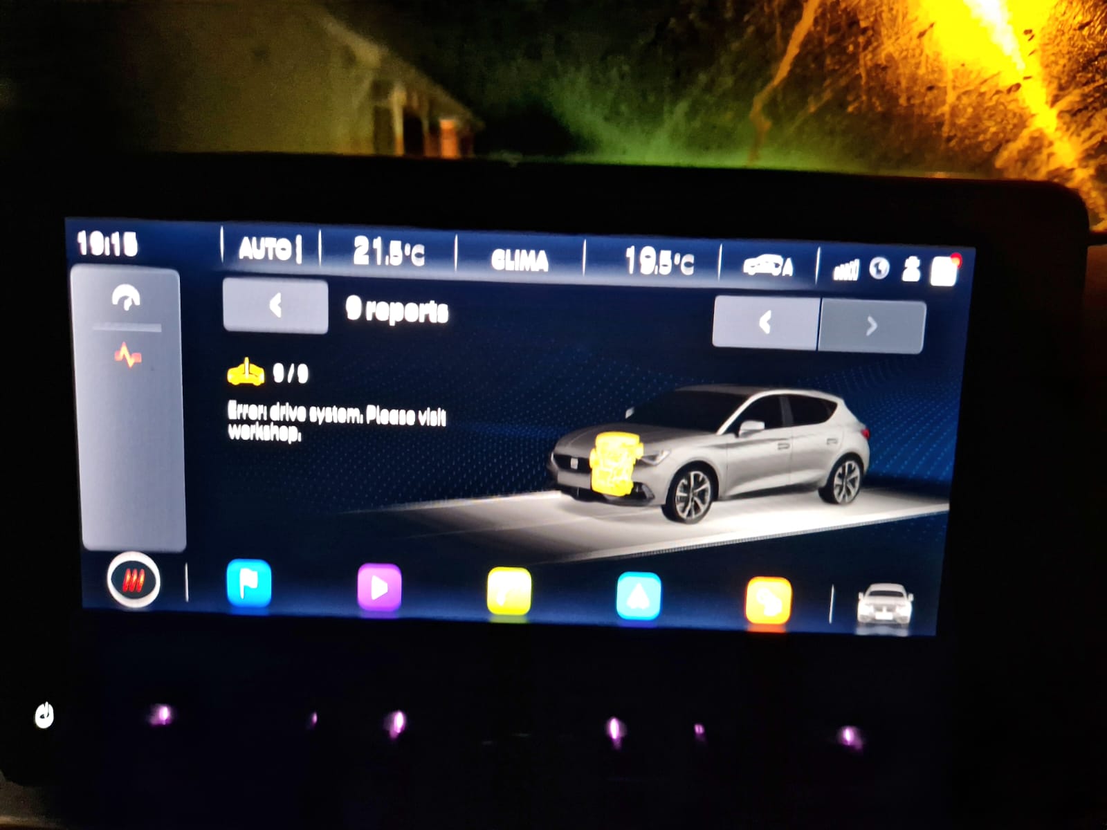

View attachment 40748View attachment 40749View attachment 40750View attachment 40751View attachment 40752View attachment 40753
You might want to get your battery checked before doing anything else.
Weak batteries that are about to die can lead to all kinds of control unit faults, which got cleared when battery replaced.
Reactions: C_ED_99
Update - Battery changed and rear wheels removed to reset the handbrake.
Car is still dead and sitting in the garage ?
Hi C_ED_99
did you manage to sort your issue out regarding the parking brake? My car has done a similar thing and won't start or move with a parking brake error displayed before the dash had a fit of blinking on and off like an electrical issue, I can't now move it, I've just checked the battery and it's only showing 10.6 v so I'm going to replace that tomorrow and see if that fixes things.
