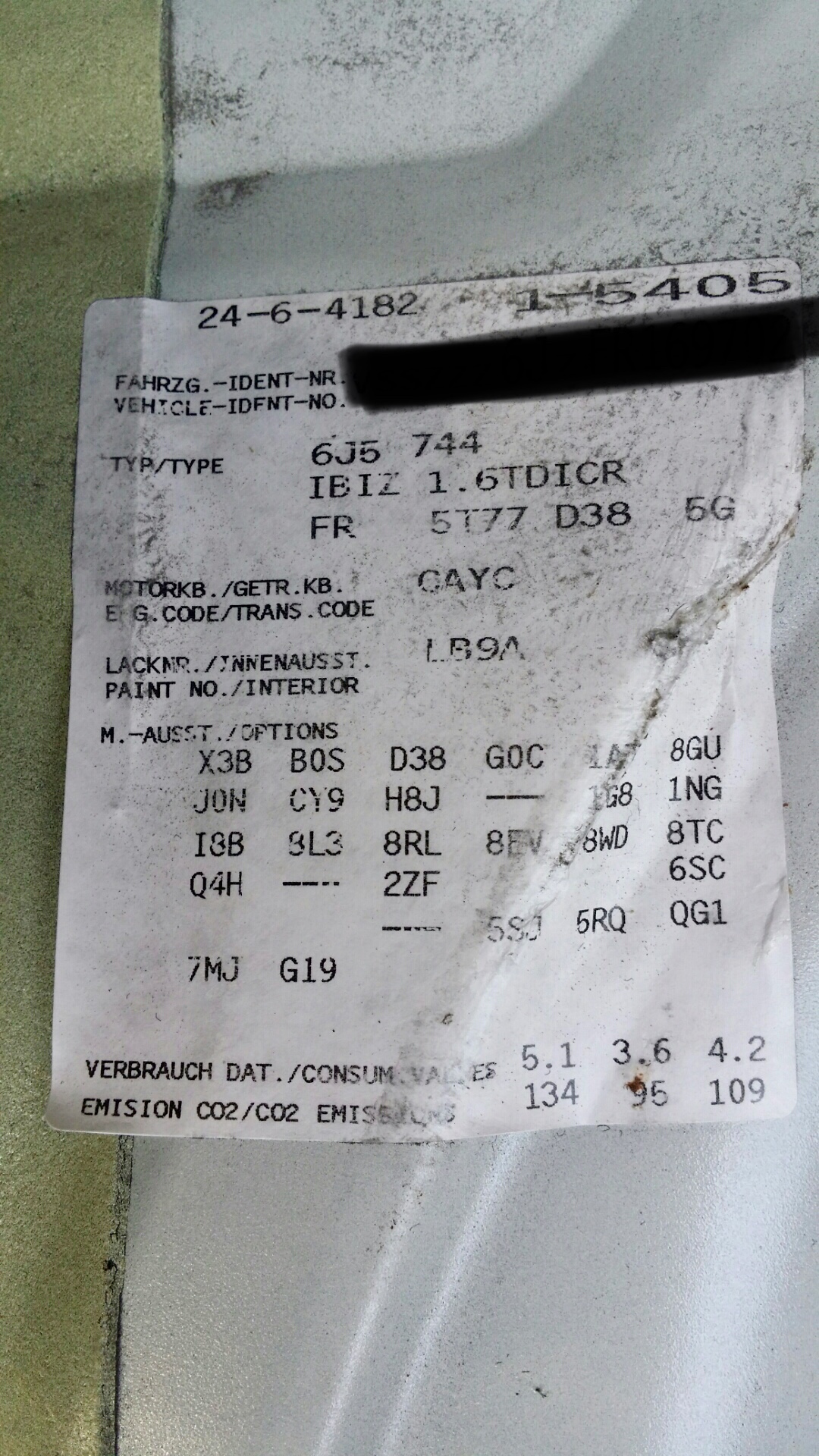

This is my tag list, have a look and see if you can see any useful info.I believe that Seat no longer put the gearbox code on the list.
Cheers Jon

Na definitely not there mate. Give your local dealer a phone and quote your chassis number. They'll tell you exactly what oil it takes after a few mins. It's easiest and quickest way to be sure.

Interesting about gearbox code missing from build label, I remember discovering that on my daughter’s late 2009 Ibiza SC 1.4 I thought that was a one off!
Mine is the 5 speed box. Looking on the parts database,(https://ifinterface.com/prog/car/cp2/inprog.php) the MQ200 uses 2.0l of oil & MQ250 uses 1.9ll of the G052527A2 oil. Presumably the same basic box just different ratios/diff for petrol & diesel models. I don’t know if I trust this as being unable to find parts using the chassis number and with all the gearbox codes and types of gear oils available. Will have to call in and ask Seat thanks alot.
