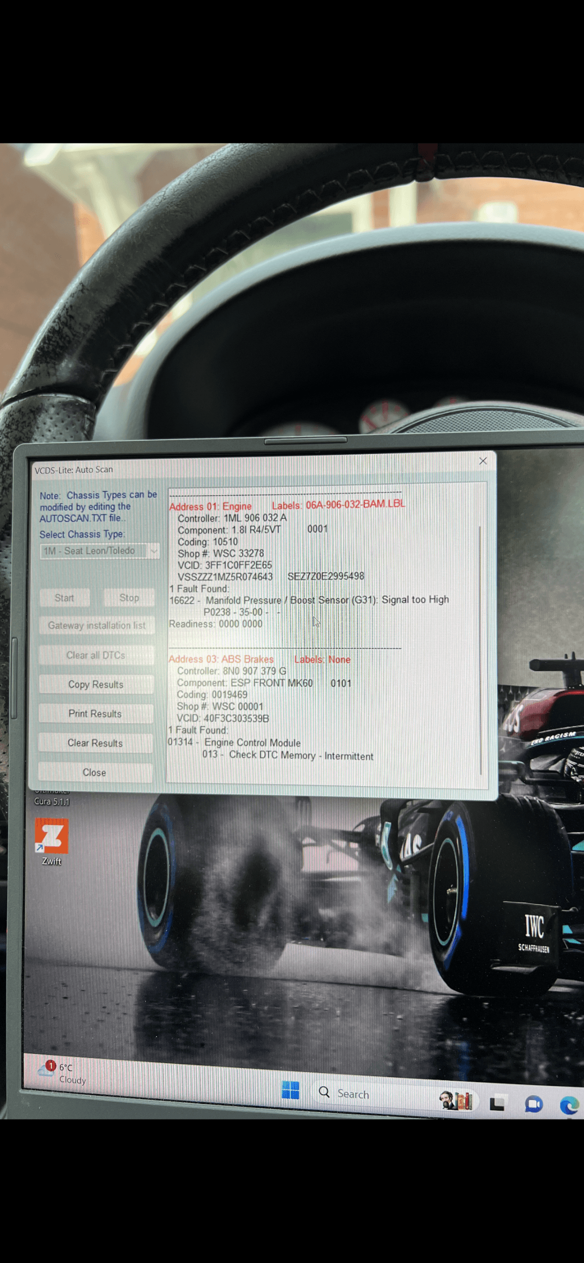

I purchased a cheap vag com cable yesterday and scanned this morning (maybe found the issue
That sensor should not be all that expensive
Well it’s been very annoying, firstly thought yes I’ll change the map sensor and hope that’s it. Trying to take the sensor out the screws just spinning, other one was seized on and eventually snapped so had to drill them out and whilst drilling bolts out the map sensor pipe itself decided to break, hunted around for a map sensor pipe and cannot find one for sale at all apparently £200 from seat, saw someone else post the price. So went on eBay and every single map sensor pipe comes with the map sensor still attached. I’m going to assume they are notorious for not coming off very easily so people just leave them. Bought one of those with map sensor attached hopefully it works.

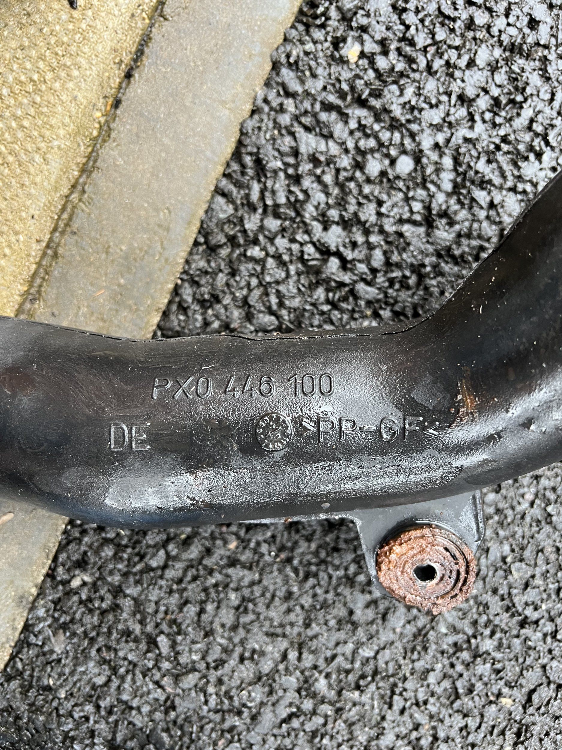

not surprised at that price, i changed the clutch pully on mine found the exact same INI pulley for £24 at seat they want £167 that's an expensive box lol, last i was told the locks were £267 the after markets or repair the original are allot cheaper, some sensors your ok going good branded makes but its that maf you need the same Bosch maf or it can cause havoc if its not, have you got the part number you searched?
I took a picture of it
