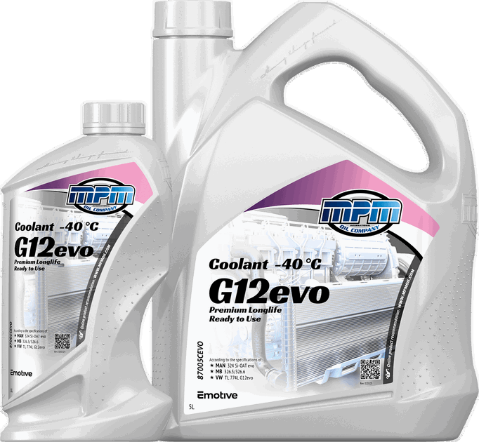

Thanks, so if I get some G12evo I can basically add it to any of the previous VW ones (including my current G13/GG4O)?
Think you got this on the other forum thread, but for history and other people here's what I used recently:
