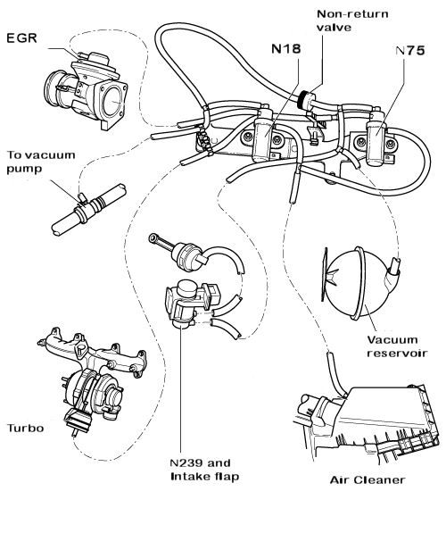

The vac lines for the ARL engine should look like this:
Of the two valves mounted on the firewall the N75 is nearest to the nearside of the car, N18 further in.
If the N75 is disconnected the vanes will relax to their wide open position, which is the max rpm position and gives poor boost at low rpm. The behaviour you're describing doesn't make sense to me and I'd want to check the vacuum lines to make sure they are in the right places and intact.

wow, i know feel like a right kn*b! it was the N18 i disconnected as from pictures and description i found, i thought the N239 was the N18. that picture you just put up is by far the best one I've seen and shows it all.
