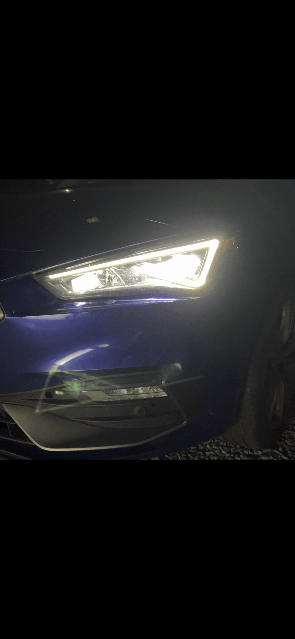

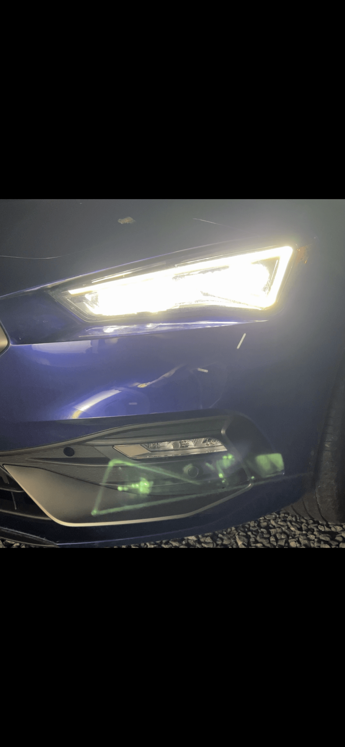

Definitely has its own lights for main beam and uses the dipped lights to go brighter
I will add a video of mine working
Reactions: Alex667
Can’t seem to add a video so here’s a few photos.
you can see the inner light comes on when you press main beam.
bit crap at night with the camera but main beam definitely has its own light.

Projector lights are designed this way. Low beam get raised up and additional LED are switched on. I don't see any issues on my one only the raising speed could be faster. I do recommend check the low beam as my one was set too low.
Yep and that’s my point. The main beam LEDs in the middle take well over a second to reach full brightness, I’d expect it near instant.
