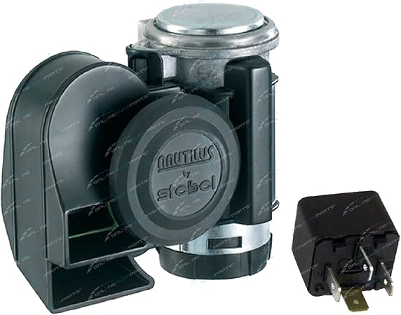

Can't help with where it is; usually behind a wheel arch liner or the front bumper But when you do find it, replace it with one of these
