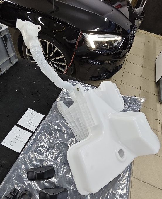

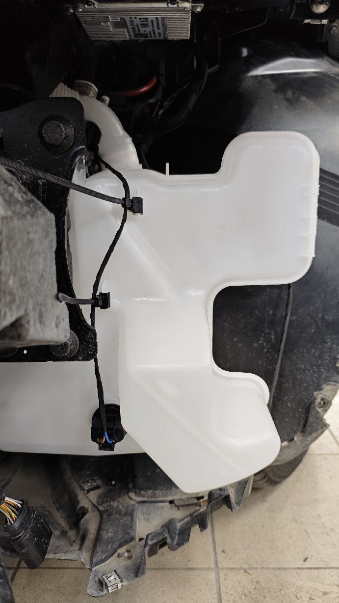

Hi, everyone.
As per my original post in this thread, I was planning to add more small bits that were missing.
One of those was the washer fluid level sensor and the other was the heated washer nozzles.
Below is the list of parts that I used and also the items needed coding.
Also I took some photographs, not too detailed to document the whole work from start to finish, but they might just give an idea about these retrofits. I can happily provide support if anybody interested in doing the same has questions.
The new wash water reservoir has a sensor hole on it and also two pump holes, instead of one on the original. It is designed to be used with headlamp washer system and the second pump hole is used for it. We had to cover & seal that pump hole using some ingenious ways. Also the reservoir is bigger than the original so it will be nice to have more washer fluid.
Obviously I had the opportunity to test the washer fluid level sensor and it worked without any problem.
But I couldn't think of a way to test the heated nozzles because I don't know their operating condition.
Probably BCM software constantly monitors the outside temperature, sends a current to the nozzles when it drops below the specified temp, resistors inside the nozzles gets hot with the current and prevents ice formation on the tips or breaks it, if any formed before.
Anyway, it seems there's no practical way to test that, please do tell me if you could think of any.

5Q0955453BE Wash water reservoir
7M0919382 Seal ring
7M0919376 Water level switch
1J0973202 Flat contact housing
5G09559869B9 Heated spray nozzle x2
8E0973202 Flat contact housing x2
Also 9 meters of cable and some contacts were used for wirings.

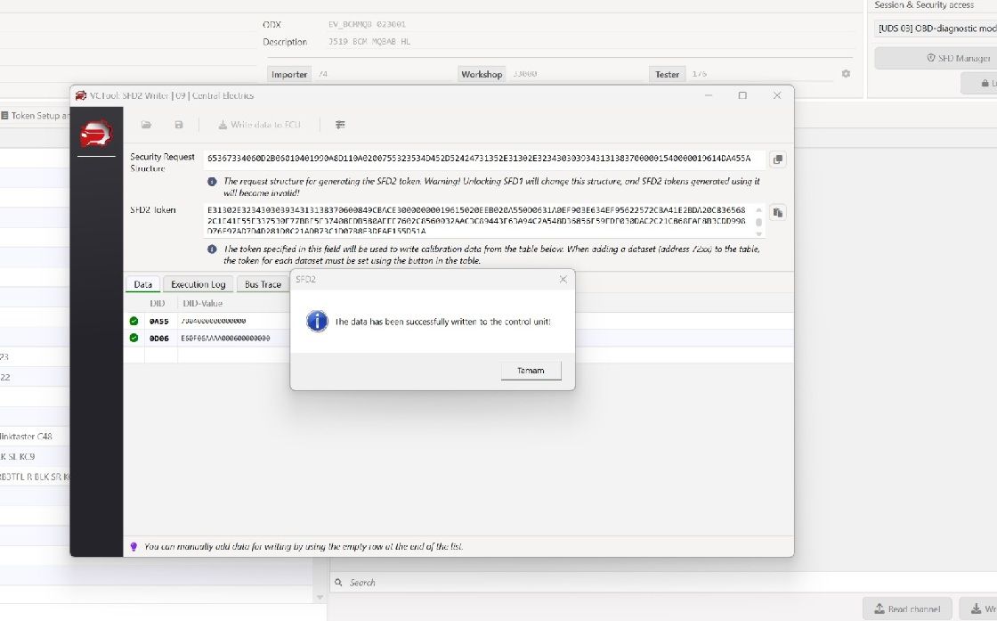

Coding required:
09-Central Electrics
---> Adaptations
------> HW_Verbau
---------> Insufficient washer fluid -> installed
------> Window heater
---------> Waschduesenheizung -> installed
